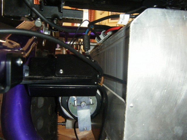

Hi all, can anyone tell me what the 2 orange wires are for on a F55 Free wheel assembly part/unit? I've connected the cables to each motor to get it in and out of gear ok. Just leaves the 2 orange wires with (I think they're called bullet connectors, 1 male, 1 female). Any ideas were they go?
Second question, When I turn my controller on the wheels shudder as they move, (my guess is that the brakes are on, although you hear them click on and off) Any ideas?
Thanks Steve

Ok guys, your still not on my wave length :( Look at my photos and you'll hopefully see the gear lever part and the two orange wires just dangling.
This is the gear lever/part.

The plug that goes into the module has four contacts. Two big ones for the motors, two small ones for the brake. Is that clear yet? The ends of the wires shown are not compatible with any control module, so you'll need to cut them off and install the appropriate contacts, or splice them to a pre-built cable assembly. If they don't reach where you want to put the module, you need to splice extension wires.

Yes, I understand you but the 2 wires I'm struggling with come from gear lever part (for putting the motors in and out of gear). I've connected the cables to the clutch's so the motors go in and out of gear. But the 2 orange cable look like their some sort of electric connections.
The motors are connected to the module as is the brake. When I press the joystick I can hear the brakes click on and off.
Make sense?

Yes, I think it makes sense now- and I'm starting to get an idea of what they might be.
Can you measure the resistance across them, and check out if they have continuity to any other connections? Does their connection change at all when you move the brake levers back and forth? I'm not familiar with the F55, but some chairs have a separate connection to a microswitch in the brake area that makes an open circuit when the brake is disengaged. In my case, the brake is in series with this switch. When the brakes are manually disengaged with the levers, the brakes are also electrically disconnected. The control module senses the open circuit, and activates a drive inhibit so that the chair doesn't drive when the levers are in push mode. This prevents the chair from taking off under power when someone is pushing the chair around by the rear handles.
Is this guess right that the wires are a zero-ish resistance with lever in one position, and an open circuit in the other position?
If you consider this lack of a drive inhibit in push mode to be a safety issue, then wire them in series with the parking brakes. If you don't care, just fold them up with a wire tie to keep them out of the way. You might change your mind some day, otherwise I'd say it's OK to cut them off.

Postby Burgerman » 19 Apr 2010, 18:32
I get it...
Those wires are supposed to be connected in "series" with a motor brake connection. I just cut them off. All they do is stop the chair driving by causing an error when the freewheel lever Lifts the brake off.
That way I can manually flip the lever and get no brake or clicking and still drive about without an error should I want to.
Take side cutters and Snip!

>>> I've connected the cable to the motor so it can go in and out of gear but there are two orange cables coming off the unit and I can't work out were they go.
That lever pulls a cable that manually releases the motors brakes. It does the same as the 12v that the brake needs. It does not take it out of "gear" as such. The motor spins as you push just the same. The brake holds it pretty solid if its on. On means no cable pulling, or no power to the electro magnet. Your cable routing looks a little "difficult" incidentally! I presume once completely built and tested it might be stripped, powder coated, bolts replaced with stainless, etc? Maybe its just me and my ocd! :shock:

Its unlikely the motors were faulty. The brakes are dead simple. Nothing really to go wrong. You have the brake set wrong or disabled in the programming, or not connected or connected wrong...
