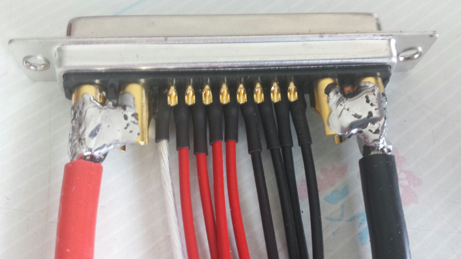

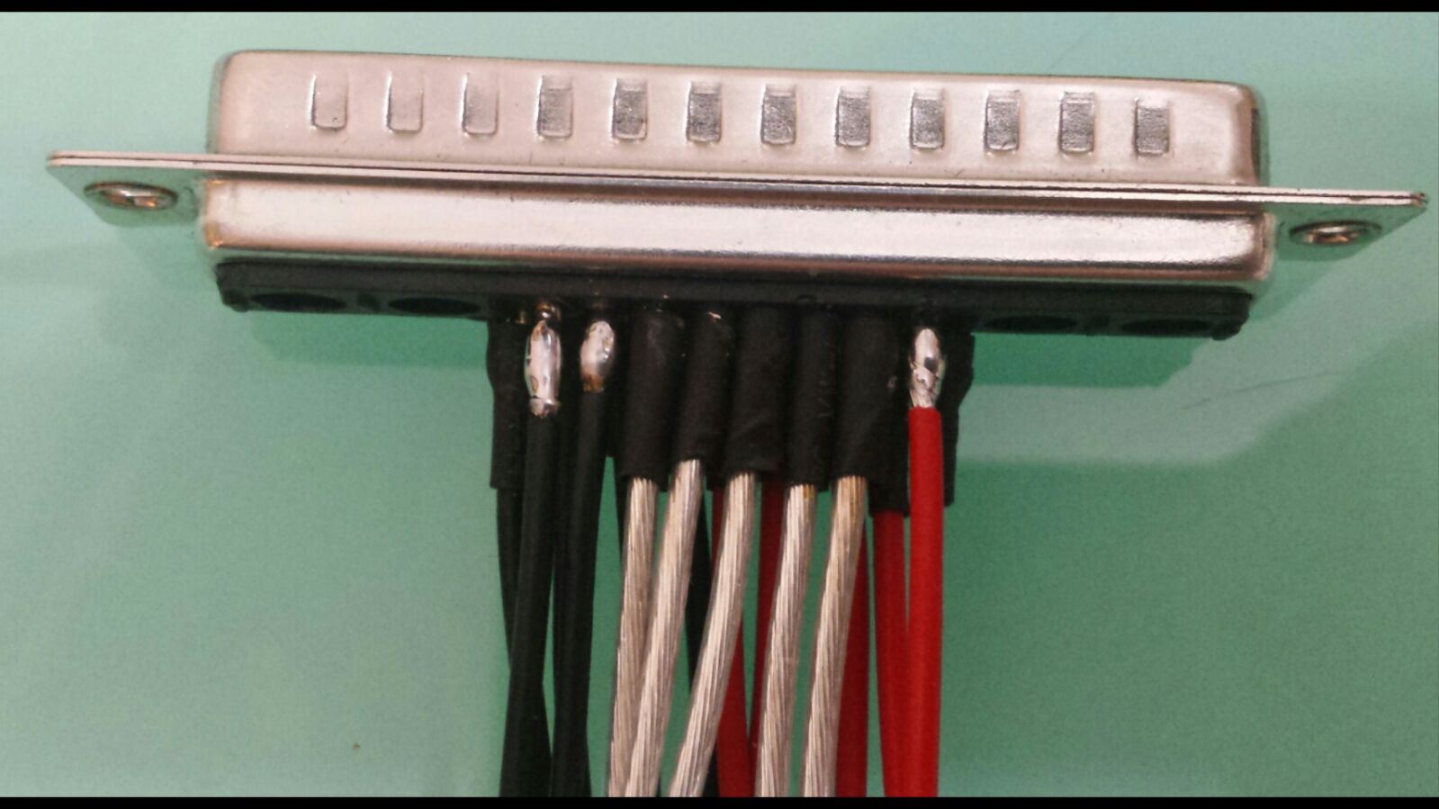

Postby expresso » 27 Jan 2017, 17:02
Nice - why do you have so many balance wires ?
Postby Burgerman » 27 Jan 2017, 17:05
He is using all the contacts...
Posts: 71085
Postby expresso » 27 Jan 2017, 17:11
yes i can see that - but why ? - i mean with the PL 8 - 9 wires i use -
why so many contacts used - just curious
Postby Burgerman » 27 Jan 2017, 17:38
If one wears or makes bad contact theres another route for the electrons... Lower resistance.
Posts: 71085
Postby expresso » 27 Jan 2017, 18:26
He used two wires - two pins for one balance contact on the other end ?
Postby Burgerman » 27 Jan 2017, 18:44
Cant tell. But possibly.
Posts: 71085
Postby shirley_hkg » 28 Jan 2017, 04:09
You are right . This is the plug we push and pull everyday by care free helpers . Expected to worn out fast .
The PL8 side will stay untouched , as REVOLEXTRIC recommended .
Postby shirley_hkg » 28 Jan 2017, 04:29
Two large pins for charging amp ! Hope the 10awg wire wouldn't melt . :lol: :D
Postby expresso » 28 Jan 2017, 04:55
ok your worried the pins may break from being used each day - i worry also when they do it - so far it seems to be holding up well -
what i do now is - i have them use a Pen to stick it in the small gap when its connected and wiggle it a bit - each side - just once and comes apart without force

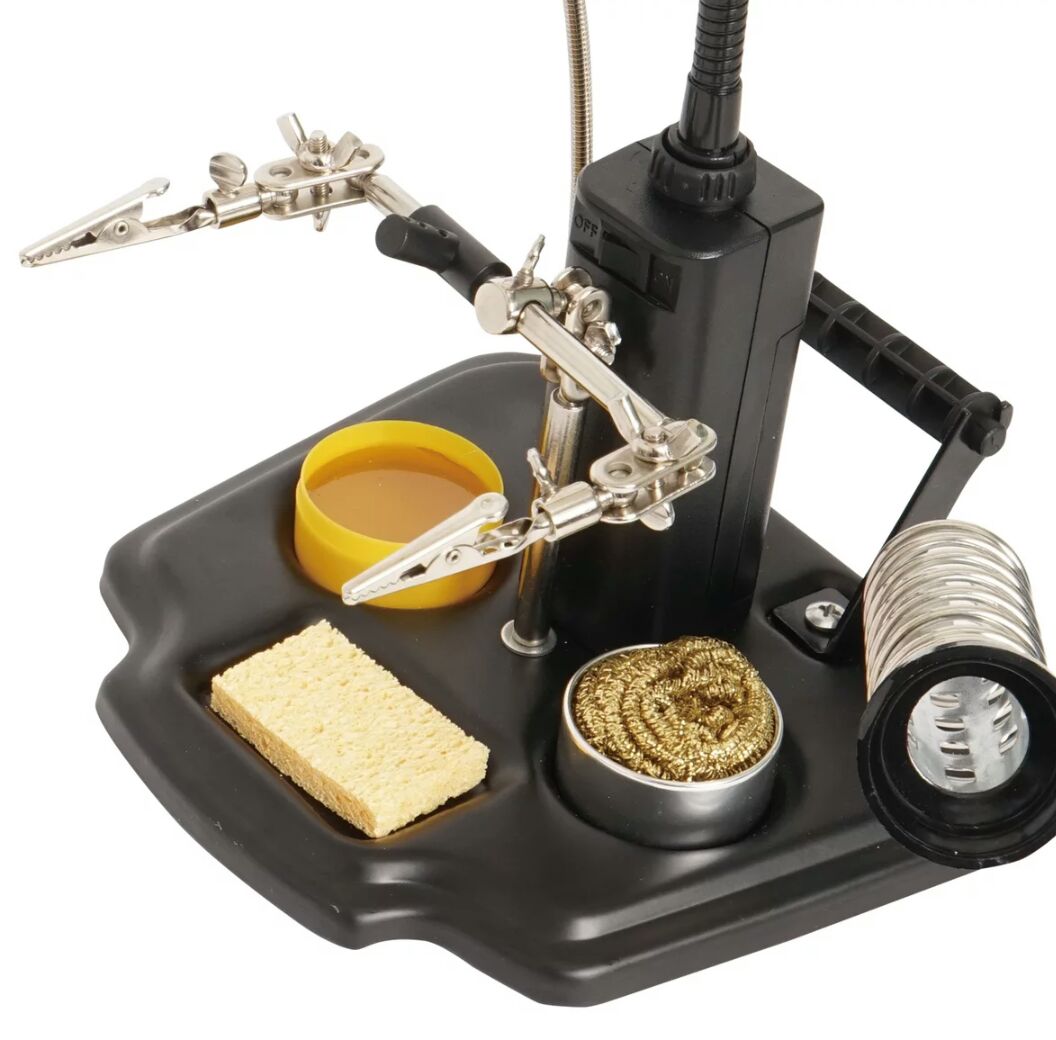

Postby flagman1776 » 28 Jan 2017, 05:23
expresso, i don't think you'll like the first 2 vises.
I like to use an old clamp to the edge of the table, vise. it's just so darn handy... move it to suit each job. I use pieces of scrap wood in the jaws to inslate the metal parts I solder. It is challenging to hold the wood & tighten the vise. I used to cut out a piece of protective wood... a slot to match the vise guides to keep it in place. Don't have one for this portable yet. i should make a set. The wood is expendable, so remember how to make them. http://www.homedepot.com/p/BESSEY-3-in- ... /205023099 lots of similar on ebay... http://www.ebay.com/sch/items/?_nkw=cla ... rmvSB=true
I've also used scrap lead (flashing) to protect my work... but conducts heat too easily for soldering.

Postby Burgerman » 28 Jan 2017, 05:47
I agree. I have a smaller one and a big bench one. But also a big block of bluetac and its really useful! Soldering ALWAYS needs 3 hands at least. And much LIGHT! And when your eyes are 56 glasses... :mrgreen:
Posts: 71085
Postby Burgerman » 28 Jan 2017, 05:51
But also a big block of bluetac and its really useful! Soldering ALWAYS needs 3 hands at least. And LIGHT! And when your eyes are 56 glasses... :mrgreen:
And I AM getting one of these when I see a good one cheap!
https://www.amazon.com/gp/search/ref=as ... SAJPN3NNPK
Dont buy these... All rubbish and frustrating... Poor quality and slip all the time!
