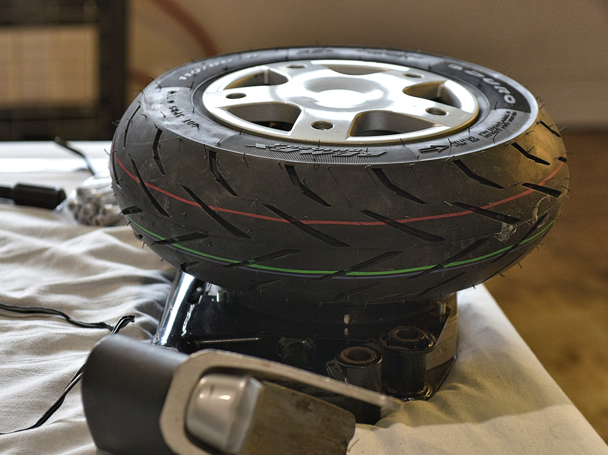

Postby Burgerman » 16 Feb 2017, 22:38
Brush-less motors look a lot more businesslike with 110/80-8 tyres... And widened rims! 50mm spacers.
Posts: 70462

Postby Burgerman » 22 Feb 2017, 15:49
Swing aways? When driving, its in the way...
OK Tyre widening. or rather BRUSHLESS rim widening, to take a 110/80 or a 120/70 tyre.
For 120/70 - 8 tyre, you need 5x 50mm spacers (ebay), 75mm M8 cap screw/allen bolts, with 1 flat washer under the head of each. That gives a 100mm or 3.9 inch wide rim.
For 110/80 - 8 tyre, you need 5x 40mm spacers and 65mm cap screws, flat washers. That gives you an 90mm wide rim, 3.5 inch wide rim.
This is the 50mm spacers, but with the 110 tyre, so over stretched BY 10mm. Its not staying this way.
Posts: 70462

Postby Burgerman » 22 Feb 2017, 15:53
Then order a strip of 1mm alloy sheet. Same width as the gap+ the indented smaller diameter part of the wheel cut to size, that is the same diameter as the indented part of the black drum, x pie, and bend in a circle. Use alloy brazing rods to join up, and then to attach to the spacers. To make a ring with spacers attached. You are done! Bolt on stock wider outer rim.

Postby hank » 22 Feb 2017, 18:26
Tons better than skinny tyres. 8-)
Looks ok on rim from pics, Not to stretched.

Postby Burgerman » 22 Feb 2017, 19:03
Those are 110/80 x 8 and stretched slightly too much. Need 10mm less so really need the 50mm spacers swapping for 40mm ones or even 45. I have both. So will do it later. Or the rim will get scuffed against stuff... But I did it just to show how I was widening them. They are for the stock chair, so adding the even wider 120 tyres, will add total 20mm extra. So not doing that! Its another inch... as it is with the 110 tyres we end up at 27.25 inches from the stock 24.8 width. So to keep a sensible width, 3.5 rims and 110 tyres! These are all the same diameter as stock, just wider, lower pressures. But much better stiffer construction and tougher to puncture. Also rated for speed and road use.
Stock 3.00 8 tyres are generally feeble low quality. A bit too much like bicycle tyres for my liking. And this is a heavy chair. We are looking at 200kg or more, empty! Prefer something more substantial. Even the tubes are branded and designed for heavy use on trailer tyres. About 3x as heavy as wheelchair 3 x 8 ones.

Postby rlnguy » 22 Feb 2017, 21:04
I used the same method some years ago, on a project-worked great for tube type tires.
Did I miss something? or are you not going tubeless on these?

Postby Burgerman » 23 Feb 2017, 02:41
I could if I went 10 inch. On 8 where the motor itself forms half the rim, its hard to do. It would mean sealing my home made bedroom built parts when bolting together. If I hada machine shop? Easy. But I dont so tubes will have to do this time.

Postby shirley_hkg » 23 Feb 2017, 03:15
Burgerman wrote: If I hada machine shop? Easy. But I dont so tubes will have to do this time.
Oh, NO ! You deem to start all over again . Tubeless please .
I can make that extended rim half , inexpensively , if you could send a drawing , and figure out the sealing .
Otherwise , go for 10” rims with short sidewall tyres .
