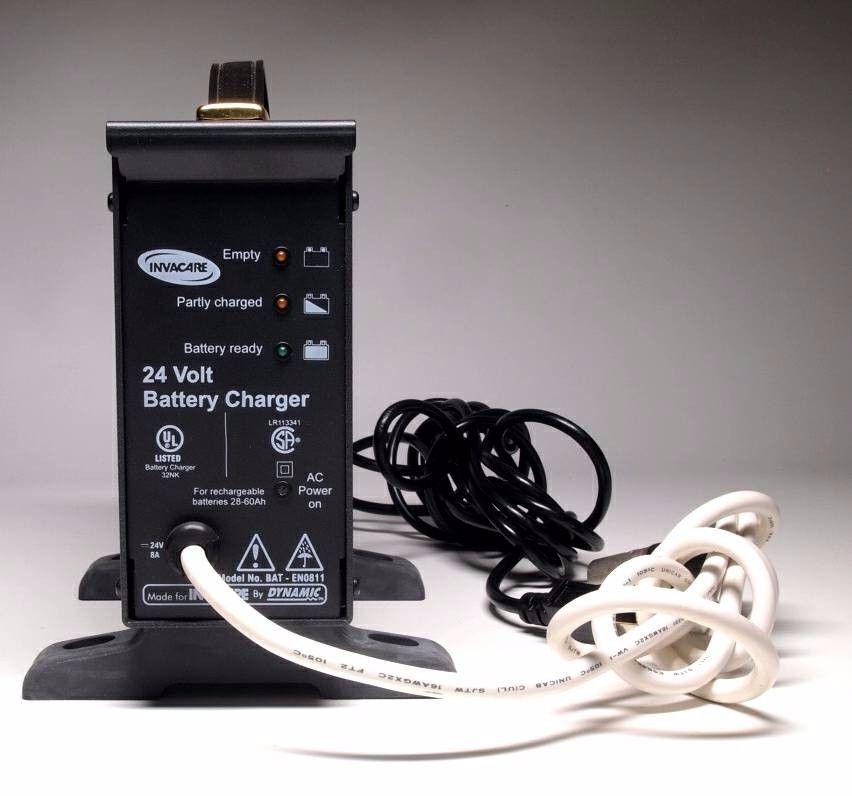

Postby Burgerman » 11 Feb 2017, 20:59
It came with MK gel, about 90% charged. And one of these chargers. I have 3 already. Every one does something different... So this one is a mystery till I measure it. But its already wrong! It charged for 1 hour and said ready. The battery was at 12.75V each. So it should have been on charge for at least 3 to 5 hours and then to float... Dont know what its CV voltage is.
So gives the user the impression it charges fast. While destroying their batteries.

Re: New chair!
Postby shirley_hkg » 12 Feb 2017, 04:30
That looks like AGM , rather .
A pair of healthy GEL would stay at 26.30 or higher , unpluged overnight .
Re: New chair!
Postby Burgerman » 12 Feb 2017, 11:26
The last time these were charged was in germany 3 weeks ago I suspect.

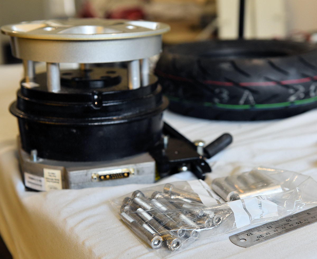

Postby Burgerman » 16 Feb 2017, 22:38
Brush-less motors look a lot more businesslike with 110/80-8 tyres... And widened rims! 50mm spacers.

Re: New chair!
Postby Burgerman » 22 Feb 2017, 15:49
Swing aways? When driving, its in the way...
OK Tyre widening. or rather BRUSHLESS rim widening, to take a 110/80 or a 120/70 tyre.
For 120/70 - 8 tyre, you need 5x 50mm spacers (ebay), 75mm M8 cap screw/allen bolts, with 1 flat washer under the head of each. That gives a 100mm or 3.9 inch wide rim.
For 110/80 - 8 tyre, you need 5x 40mm spacers and 65mm cap screws, flat washers. That gives you an 90mm wide rim, 3.5 inch wide rim.
This is the 50mm spacers, but with the 110 tyre, so over stretched BY 10mm. Its not staying this way.

Postby Burgerman » 22 Feb 2017, 15:53
Then order a strip of 1mm alloy sheet. Same width as the gap+ the indented smaller diameter part of the wheel cut to size, that is the same diameter as the indented part of the black drum, x pie, and bend in a circle. Use alloy brazing rods to join up, and then to attach to the spacers. To make a ring with spacers attached. You are done! Bolt on stock wider outer rim.

Re: New chair!
Postby Burgerman » 22 Feb 2017, 19:03
Those are 110/80 x 8 and stretched slightly too much. Need 10mm less so really need the 50mm spacers swapping for 40mm ones or even 45. I have both. So will do it later. Or the rim will get scuffed against stuff... But I did it just to show how I was widening them. They are for the stock chair, so adding the even wider 120 tyres, will add total 20mm extra. So not doing that! Its another inch... as it is with the 110 tyres we end up at 27.25 inches from the stock 24.8 width. So to keep a sensible width, 3.5 rims and 110 tyres! These are all the same diameter as stock, just wider, lower pressures. But much better stiffer construction and tougher to puncture. Also rated for speed and road use.

Postby rlnguy » 22 Feb 2017, 21:04
I used the same method some years ago, on a project-worked great for tube type tires.

Re: New chair!
Postby Burgerman » 23 Feb 2017, 02:41
I could if I went 10 inch. On 8 where the motor itself forms half the rim, its hard to do. It would mean sealing my home made bedroom built parts when bolting together. If I hada machine shop? Easy. But I dont so tubes will have to do this time.

Postby shirley_hkg » 23 Feb 2017, 03:15
Burgerman wrote: If I hada machine shop? Easy. But I dont so tubes will have to do this time.
Oh, NO ! You deem to start all over again . Tubeless please .
I can make that extended rim half , inexpensively , if you could send a drawing , and figure out the sealing .
Otherwise , go for 10” rims with short sidewall tyres .
