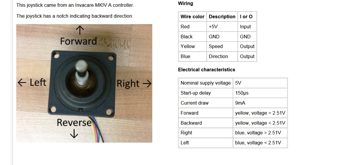

It would be simple to add in a few lines of code and have a pin read the 0v-5v output of a 20 turn trim pot, this reading could be used to allow the user to vary the deadband say from 10 to 260.
0v = stipulate 10 as the set coded MINIMUM so 10+0
5v = 10+250
