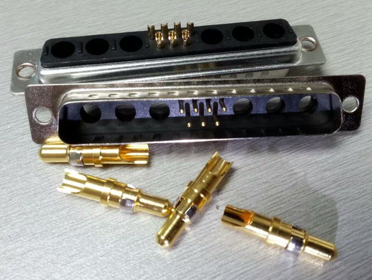

Question to anyone with an answer, will both the above shells work for my charging cable setup? Is one better than the other?

Postby Burgerman » 03 Aug 2017, 21:52
1st is ok. 2nd isn't a connector shell but a huge list!

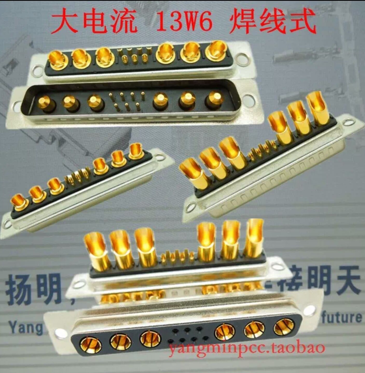

Postby Williamclark77 » 03 Aug 2017, 22:16
When I built my last pack I ordered several shells and connectors to try. I really didn't like the metal shells.
Here are the ones I liked best:
https://www.digikey.com/product-detail/en/norcomp-inc/680S17W2103L201/NOR1218-ND/4146273
https://www.digikey.com/product-detail/en/norcomp-inc/680M17W2203L401/NOR1282-ND/4311798
https://www.digikey.com/product-detail/en/assmann-wsw-components/A-FT-25/AE11004-ND/1241836
Those folding shells were much easier to assemble. Those connectors are 17 pin because that's what I needed. Be sure to order the proper pin count you require.

Postby hotwheels_75 » 04 Aug 2017, 00:42
Burgerman wrote:1st is ok. 2nd isn't a connector shell but a huge list!
Weird, this is the second https://www.digikey.ca/products/en?keywords=952-025-030R121

Thanks for the suggestions, Will. There's so many different parts & sources floating around, it gets a bit confusing.
I'm building a 64 cell 24v pack. I'm not exactly sure how many pins I need. Two bigger pins for main power & ground & 8 balance wires?

Postby Williamclark77 » 04 Aug 2017, 01:07
hotwheels_75 wrote:I'm building a 64 cell 24v pack. I'm not exactly sure how many pins I need. Two bigger pins for main power & ground & 8 balance wires?
24v is typically 8S, which would be 9 wires plus your two power charge wires. Doubt they make 9 pin versions. So, it would probably be a 10+2, whichever the next amount of pins available over 9 is.

Postby hotwheels_75 » 04 Aug 2017, 20:46
Initially I was getting 10+3 connectors, but the 17 pin connector you linked is cheaper, so I'll just get those.

Postby ex-Gooserider » 08 Aug 2017, 04:51
I didn't order from Evassemble, but don't have any serious reason to object to them... I went with a Chinese source 'Boka Batteries' recommended by a guy at Headway HQ as they are now wholesale only.... Saved about $200 over EV, and was happy with delivery time, took about 3 weeks.
I got the NorComp 10+3 connectors & shells, the Molex Microfit BMI connectors and the JST-PA-9 connectors for the PL8 from Digikey.
I didn't look to see if I could find the Norcomp or Molex stuff anywhere else, but Digikey was the only place I could find the JST connector in 'retail' quantities....
I got the wire, banana plugs and terminals via E-Bay, MUCH less than Digikey... I'm using some 5 strand ribbon cable for the balance wiring, and silicone wire for the main power wires. The ring terminals I am using on the balance wires are 3M branded crimp on lugs w/ glue lined heat shrink. I also got some glue lined 3-1 shrink tube in an assortment kit from E-bay
Worth noting that the 3M connectors are UL listed, and if properly crimped with a ratchet crimper, should be as good or better connections than soldering... They are also 'automotive and marine' rated, meaning that they are basically waterproof when shrunk... IMHO this is the best choice for the balance wiring. Even if not using the heat shrinkable crimps, I still look for the UL listing as that seems to guarantee more consistent sizing so that you get a solid crimp with the ratchet crimper. I've found some of the non-UL listed crimps are lighter / thinner, and don't give a reliable crimp, even when using a good crimper...
Shells are largely a matter of what you like, the two big things to worry about is the size of the shell, which is usually given based on the equivalent size standard 'D-sub' connector. (The 10+3 Norcomp connectors are 25-pin D-sub equivalent. IIRC, the 17+3 are 35-pin.) The other thing is the 'cable exit position' - what do you prefer, and on the chair end, what works best for cable routing to go from the place where you are putting the plug to the batteries... You can get several different exit angles from parallel to the connector face to right angles to it...

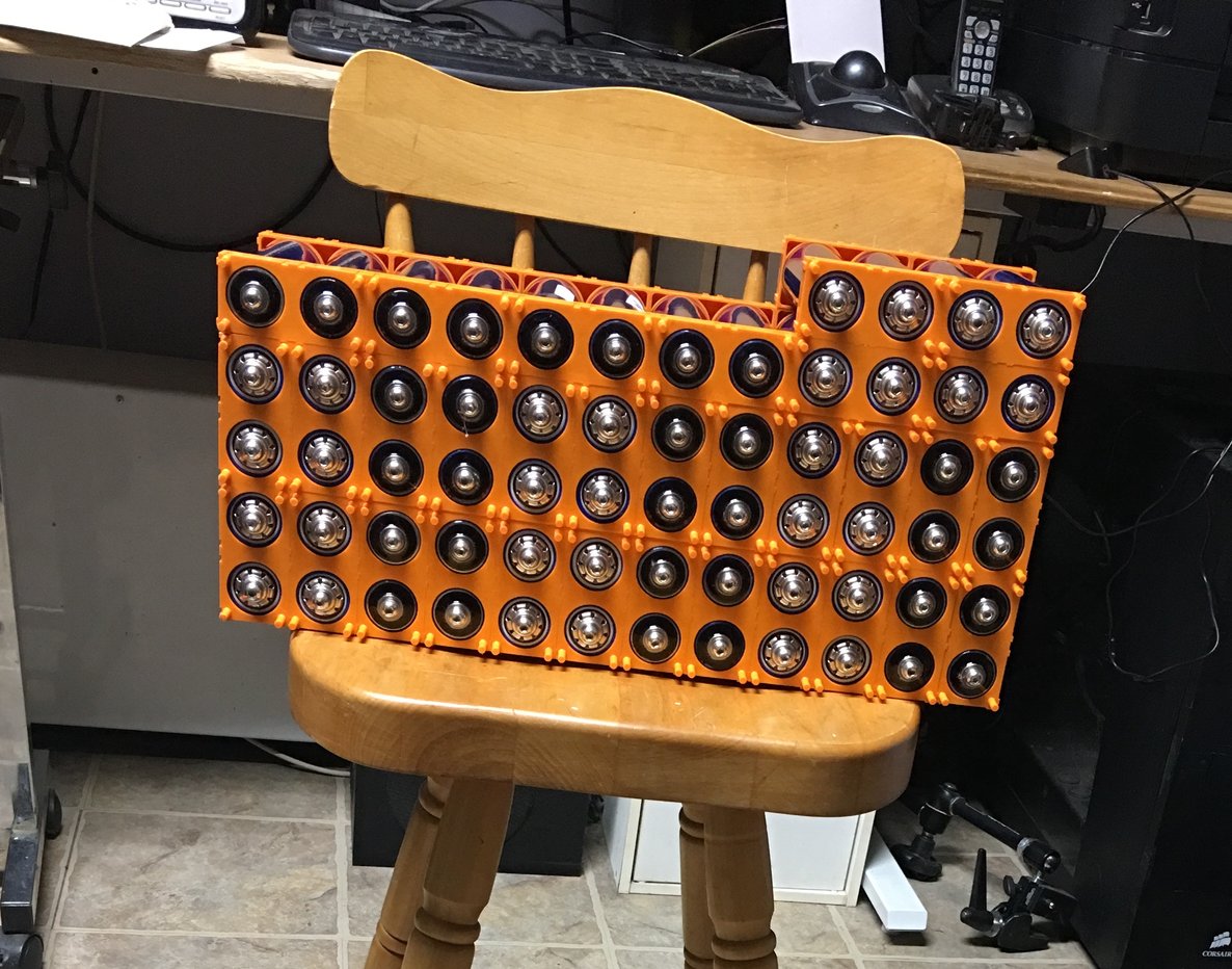

Postby hotwheels_75 » 26 Jan 2018, 03:15
Is there an easy way to group individual batteries into balanced cells for building your packs? I just finished my second charge after they sat for 2 months. Now I’m ready to start building my pack. I have 66 cells, need to use 64 of them to build 8 groups of 8 cells? For a 24V setup? Do I have that correct? I have them all recorded in a spreadsheet with cell #, serial # & mAH returned. Thought someone had a quick way of organizing them into groups with similar mAH returned, but can’t find it now.

Postby Burgerman » 26 Jan 2018, 03:26
10 mins with a calculator.
If you need say 8 cells per parallel group, just make sure that that group have the same TOTAL mah returned.
So add up 64 cells, (ignore the two with the highest amount returned before you start and remove them from the equasion).
Divide this figure by 8.
Then make 8 groups that add up to this figure. Ish. Not super critical. But it prevents you having all the worst cells on one group.

Postby hotwheels_75 » 05 Feb 2018, 01:41
Pretty easy actually. Just did it in a spreadsheet.
Now I just need to start the wiring process... I think I have it figured out in my head, but I would appreciate anyone’s assistance to make sure I dont make expensive smoke signals.
I assembled them in parallel groups of 8 in the only shape that will fit my box. So I need to link 4 of the groups of 8 in series to make 2 x 12v packs? I’m not confident in where the balance wires should go. But for each 12v Pack, I run a +cable & - cable that will plug into my chairs power harness. And a balance wire to where each group of 8 is joined?

Postby Burgerman » 05 Feb 2018, 01:56
Just connect all cells as 8S 24V. You never need to think about 12v.

Postby hotwheels_75 » 05 Feb 2018, 02:18
Burgerman wrote:Just connect all cells as 8S 24V. You never need to think about 12v.
I realized that after I posted. I remembered 8s pack.

Postby hotwheels_75 » 07 Feb 2018, 01:09
Anyone have trouble with the 4 hole plates from evassemble not lining up with the battery terminals? Every one of mine looks like it needs the holes drilled out or elongated to fit properly.

Postby Burgerman » 07 Feb 2018, 01:26
Yes I had a batch 5 years ago. I just ordered another set from a place in the UK. Have ordered them since from EV and no problem.

can anyone here offer a suggestion why my PL8 is having issues discharging my pack? 8P 8S 24V 96AH. If hooked to a PSU, selecting anything over 3A I get Error Code 139 Discharging exceeded 120 watts. I’m using a preset found here, with settings tweaked by BMs step by step directions in the forum.
It discharges between 6 and 8A max regardless of what I select for discharge rate when regen discharging into a 12V battery.
