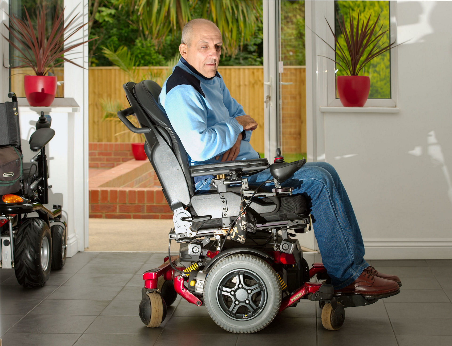

Stephen in his Q6000 in my kitchen today... Note one
of my own home built / seriously modified powerchairs on the left!
He had come to see me as he is actually building one of these too. A clone. To replace his indoor
chair (the Q6000) and his Frontier X5 outdoor chair since mine does both jobs
better in one single powerchair. No need to keep swapping or driving
around with two chairs...

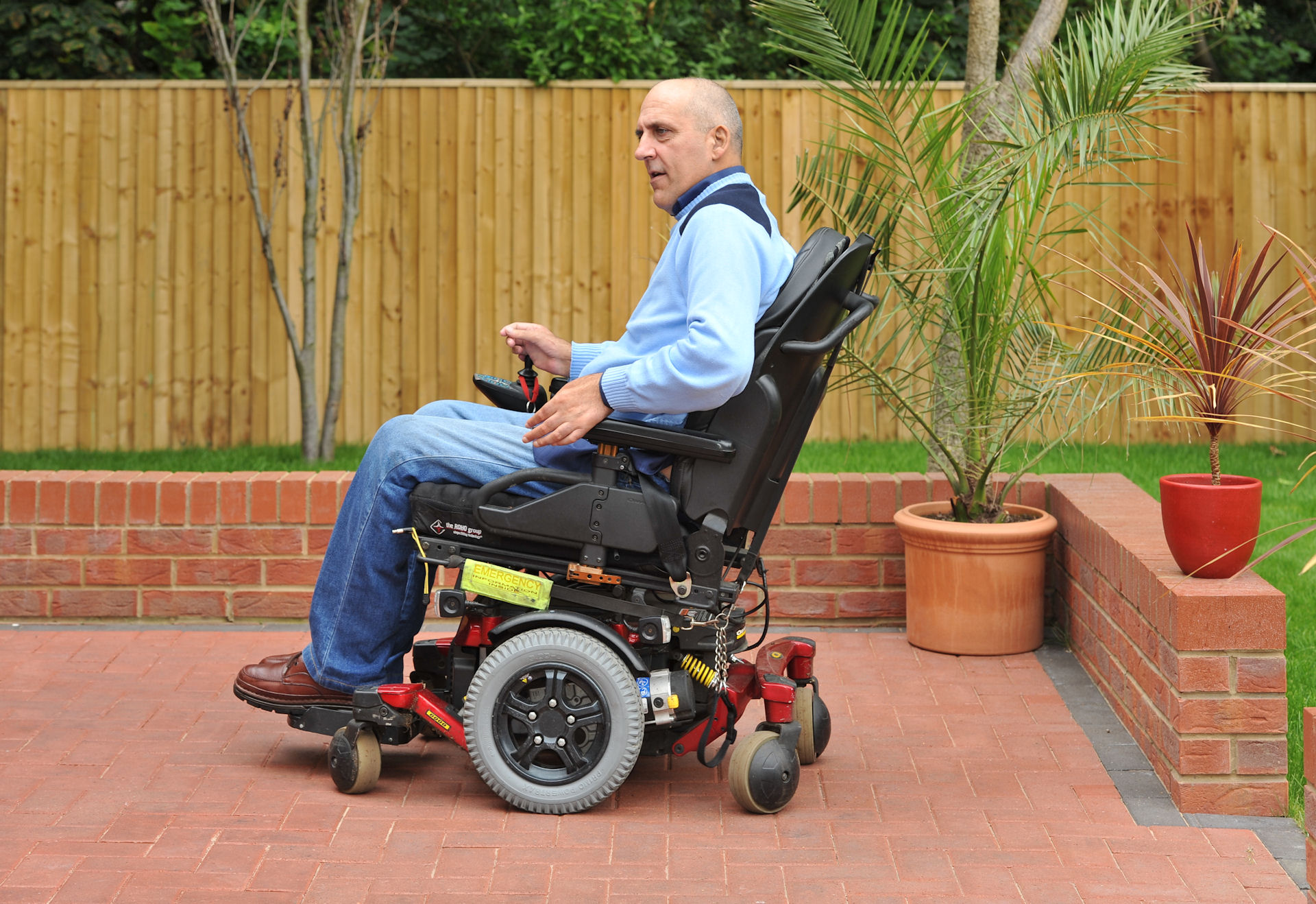

On these sorts of surfaces, and indoors its at
natural home.
Although I prefer not to have casters sticking out behind me when moving about
in a busy place! They hurt your toes apparently according to all the people
around you...

but it works... On the flat. And indoors. Stephen suffers from pressure sore issues, as I do,
and wants a MUCH smother ride than this chair can offer with its small hard
drive wheels and casters. And no suspension on the drive wheels that you are sat
on. He needed bigger fatter softer wheels and tyres.
Hence he bought a Frontier X5. Which is too big
and long and high indoors and wont fit his van... Actually he lowered the seat
but its too wide to drive from as it cannot sit centrally in line with the
steering wheel.

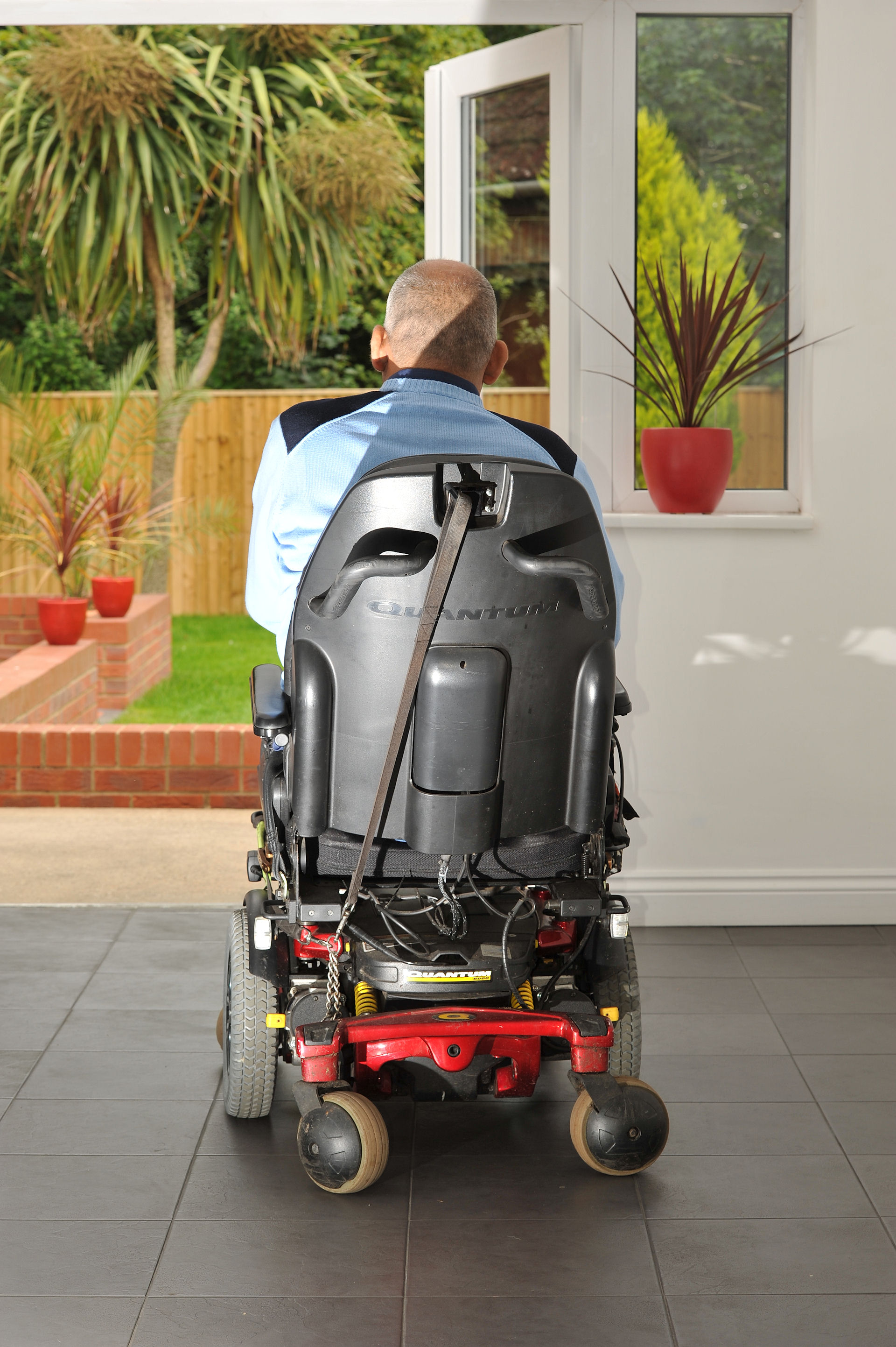

The idea being that smaller casters
(Q-6000) are better indoors since they hit less of your surroundings
when manoeuvring but are
really completely useless outdoors other than in shopping centres etc. And
because there are 6 wheels
and a caster sticking out in each corner on mid drive chairs like this one that's pretty important. And the one inch "bigger"

still a step too far for this powerchair! I watched a guy trying to drive
his Q6000 over the same car park and building entrance area that my own chair
just glides over smoothly. He was rattled about horribly and looked very
uncomfortable.

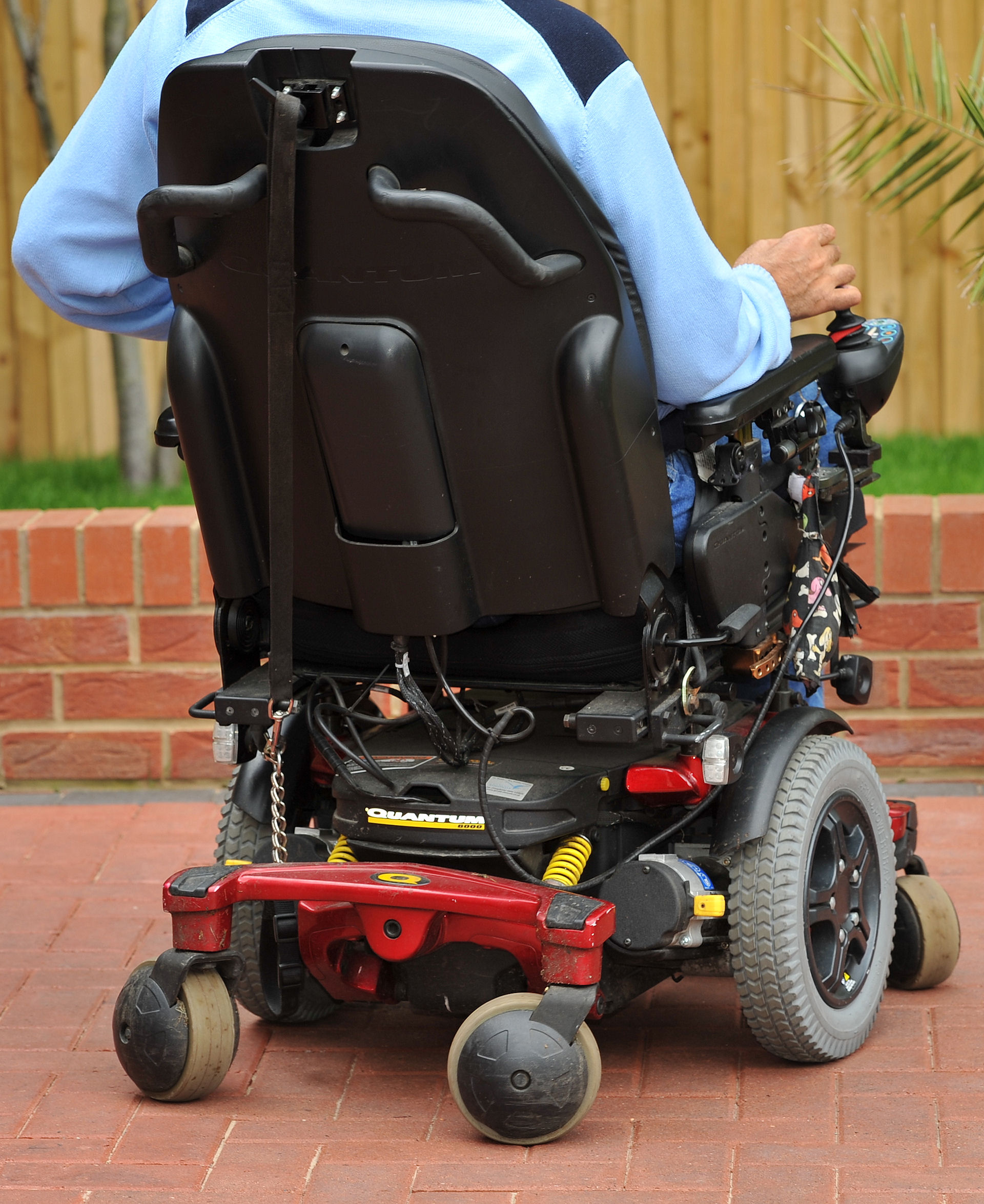

Not exactly elegant from the rear either is it? I
have never seen so many tiny parts, bolts, springs, unpainted plastic parts,
cables and wires hanging seemingly at random in my life! Sort of an
explosion in a powerchair factory and it all stuck. And they left it looking
like that!
If I had built that I would consider it a prototype and would
come back and build a FINISHED version that looked tidy and still worked the
same... It honestly looks dangerous. Anyone could yank out a cable either on
purpose or by accident and you are screwed... And these are the offending
casters sticking out at the rear. They hit furniture, as you manoeuvre. Worse
they run over peoples feet when in a busy pub for e.g. and try to turn or move
about. What a great idea! Its why 6 wheeled powerchairs are a bad idea. An
engineers worst nightmare and always a compromise. Still it clears a gap around you. Note all the
scratch marks on the side shields, And note that they are small, and solid. Like
an office chair. Try your office chair in the street!
