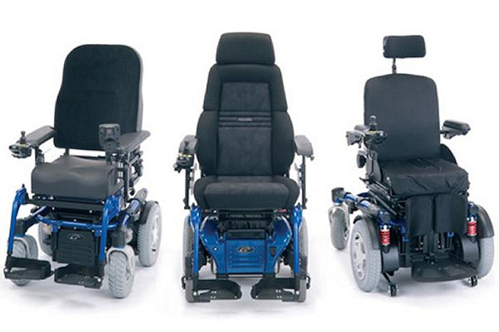

This photo shows some of the options. Rear drive
with comfort seating. Mid drive with an automotive seat. Front wheel drive with
rehab style seating. And three different types of arms... There are more
bigger real world photos further below on the page.
Now to begin with don't get the idea that you can configure
your OWN Quickie Groove from front drive to rear to mid drive yourself
because you cant. Each uses a large number of different components to achieve
each version. Things like motors, casters lighting etc. At the very least.
So it has to be ordered the correct way to begin with. So
really this should be three different powerchairs! The "modular" part only helps
the supply chain.

The best chair configuration
here for outdoors is the rear drive version. For reasons of stability, larger
caster wheels than the mid drive one, and the obviously better outdoor
capability this gives. And better stability than the front drive and rear caster
one!
