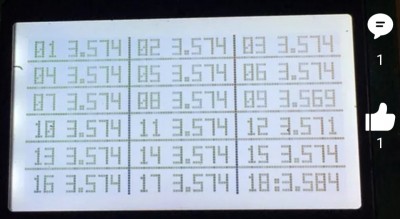

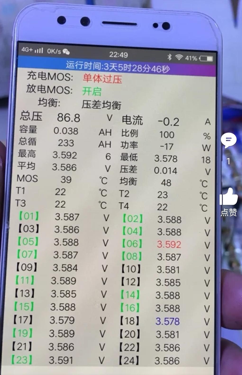

Postby shirley_hkg » 26 May 2018, 03:26
sin85 wrote:but i will use the bms for charging only.
i realise that it would take long time to charge @12A but i will probably never go quite so low as 90%. this set up is temporary and simplified for middle aged uneducated carers that have problems.
Dump charger won't fit for the job . It won't restart during BMS balancing . Adjustable PSU is better .
Strongly advise you NOT to use incompetent BMS , which are set way too high to cut-off @3.85V 。 Will kill your cells in a few cycles .
There are programmable BMS , that you can buy and set over-volt-cut-off no higher than 3.60V.
Not expensive at all , with bluetooth , so you can monitor everything on you cell phone . Seperate display too .
£40 or so .
