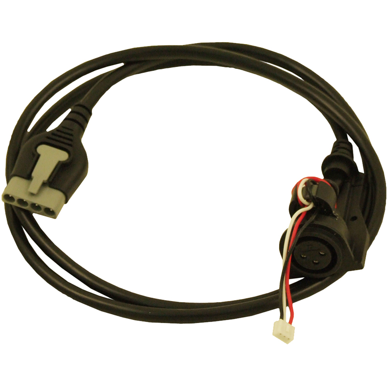

I haven't played with a VR2 with the extra functions.... mine has just 3 wires ( 3 pin plug and socket ) POS /Red , NEG( GND )/Black and a White signal wire plugged to the board.
My Yellow goes to the XLR pin 3.

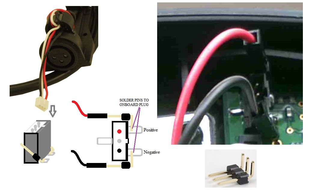

Postby woodygb » 09 Feb 2018, 11:27
IGNORE the RED and BLACK wire in the second pic ...these are MY additions.

Postby woodygb » 09 Feb 2018, 11:39
See pic ...mine is 3.

can you give me a picture of the end of your cable because mine must have a connector in less because if the yellow wire is connected to the controller on mine is cut and goes nowere

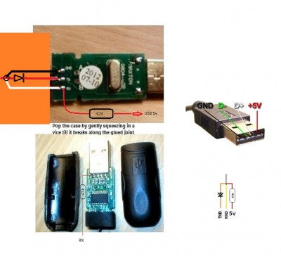

i'm using a prolific USB serial com port with the diode
i think i don't have missed anything but it's not working czy
any parameter to change like baud rate?

woodygb wrote:YUCK! Prolific is a PITA.
http://www.miklor.com/COM/UV_Drivers.php
i know but this is the only com adaptator thing i have on hand i already use this driver
i have tried this without any result czy

Sadly I cannot help any further other than recommending a specific FTDI lead.
TTL-232R-3V3-WE

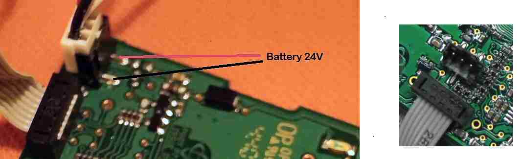

got it just opened the controller and solder wire inside and magic it's active

Hi nSRaiden when u say u had to open your controller and solder a wire, what do I mean by this ?
I am having trouble with connecting to my s drive 200a as it does not seem to connect to the controller although the software recognises the cable and tries to send data.
would be good to know what you ment by soldering a wire in the controller.
