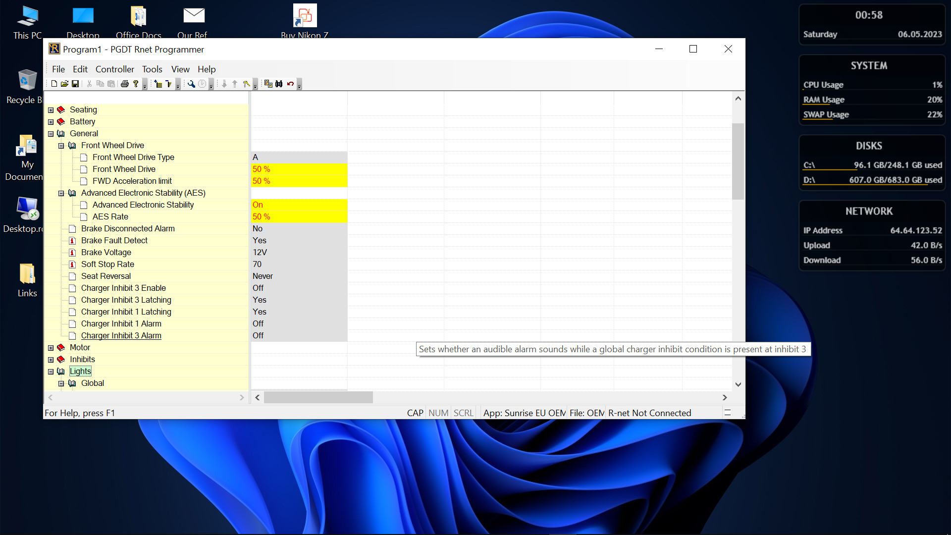

Postby Burgerman » 06 May 2023, 01:05
Which is *EXACTLY* why I want to see a clear video of what is happening wit the hardware, software, positioning, seating rigidity etc.
TRY setting this as shown below. The YELLOW parts!
Never set advanced stability to more than 50 or 55 as that will make steering MORE twitchy. Do this AES only after testing the Front Drive Rate ON ITS OWN
Front drive rate may be set high if needed for straight line steer sensitivity reduction. That might help you. A or B refers to software versions of a shaped restrictor plate... Try A and B. See if you can feel the difference.
Posts: 69890

Postby q700m » 07 May 2023, 00:35
these settings are almost fine for me, but the joystick forward is still very sensitive,
is there a setting to reduce the sensitivity?
