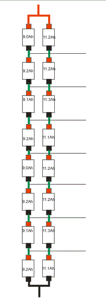

I am designing a 560 Whr lithium iron phosphate battery pack to supplement the 2 group 24 batteries on my Permobil M. 300 wheelchair. I want to check my understanding of lithium cell balancing and I have a couple of questions:
1) suppose I use 16 10Ahr cells (2 parallel chains, 8 cells each chain). If I understand Burgerman's method of sorting and wiring his cells (described in the beginning of this thread), it seems that the important thing is that all the cells in a particular series chain are well matched in terms of capacity. Capacity matching of one chain to the other does not seem important. I have illustrated this with an attached drawing where I pretty much made up the numbers for variability of cell capacities. Is this correct?
2) if, instead, I used a single chain of 8 20Ahr cells, how do I know that the individual cells will be well matched?
3) Burgerman's design uses cylindrical cells. It looks like I can save space by using prismatic cells instead. Are there any drawbacks to doing this?
Regards,
Joe

Postby Burgerman » 22 Apr 2016, 02:20
Prismatics generally have too low C rating compared to cylindrical cells. So suffer more at a given Amp level and so are less likely to live as long. And voltage drop under load will likely be greater too. Does it matter on an addon? Probably, as the lithium voltage is higher than the lead most of the time and so more is taken out of the lithium at times of heavy load. But both will work.
You dont. You have no oportunity to measure self discharge. And so may end up with a cell that discharges faster in storage and takes a day to balance later on.
And I never bother measuring capacity. Quality cells are generally very close. I measure self discharge over time. This varies quite a bit on some cells and makes the pack go out of balance if left a week or a month without a balancing charge. You want each PARALLEL group to have similar self discharge rates when added togeter.
Posts: 71092
Postby JoJo7 » 22 Apr 2016, 19:21
Thanks for the reply, in particular for the clarification about matching self discharge rather than capacity.
Joe

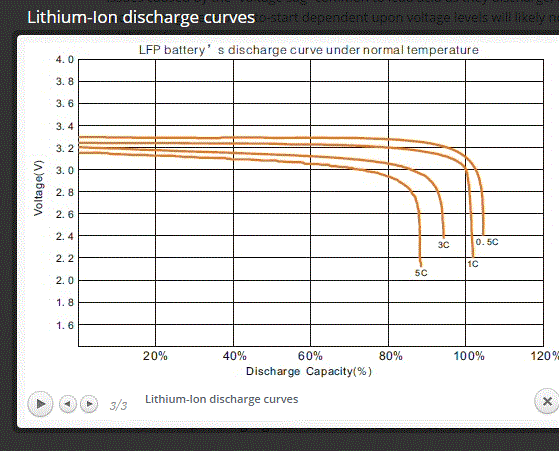

Postby JoJo7 » 24 Apr 2016, 20:39
I have been trying (and unable) to find a TECHNICAL definition of the term "maximum recommended discharge rate" for a lithium iron phosphate cell. That is, something that relates to the voltage drop of the cell during discharge.
For example, for a cell with the discharge characteristics shown in the accompanying image, what would be the maximum recommended discharge rate?
Joe

Postby Burgerman » 24 Apr 2016, 22:20
There isnt one.
C rate refers to a bunch of things. Not just voltage drop under load. Its a guide to allow you to fingd the best cell for a job.
The cycle life for eg is quoted typically at 2000 at 80% discharge. But that is usually quoted at at low 0.1C discharge rate. At higher discharge rates, (or charge rates) you get less cycles. Sometimes a LOT less. Lithiums like gentle use even if they are capable of huge currents. So it pays to be sure we are as far from the max continuous C rate as possible. To do this it pays to use:
-Highest rate cells you can find if weight or size isnt an issue (low rate are typically more energy dense and lighter)
-Largest capacity pack you can get in the space available. Since more capacity = less Amps draw per cell.
Theres no "cut off point" or max figure here like a fuse or trip. Lower compared to C rate, is always better. Its up to the system designer to match capacity, C rate, cost, size, weight, cycle life expected, charge voltages, capacity used per cycle, etc etc.
The MAX C Rate (pulse) means very short term discharge up to about a second or two that wont instantly ruin the cell. Heat isnt an issue here, pulse is too short, its just internal construction. So you can start an engine. That takes just 1 secont to 2 seconds typically. But driving a powerchair at high Amps up a hill is a no no...
Continuous C rate means more than say a second or two secs, up to indefinitely, that will not cause failure. (driving your powerchair up a hill). It will drastically shorten service life and get very hot via internal resistance. Heat, even a few degrees shortens service life rapidly. I keep my hobby packs in the fridge. This is one reason that cylindrical metal cells have higher continuous ratings. More surface area to lose heat and gaps between cells even if pulse or int resistance is the same.
So here for eg you take a 100Ah cell that is 1C cont you CAN take 10A from it without overheat or damage. But its cycle life will be worse than lead. Remember that a powerchair with 120A controller can pull 240A for at least 10 seconds at a time, and 60 or 100 Amps+ as you climb a steep ramp. A 3C cell is 300A capable. But a 5C one is much further from its C rate limit and will last longer.
Resistance is another thing. This results in voltage drop under load. And is another reason some higher resistance cells are low C rated. Because this resistance heats them up. And because the resistance reduces output under load.
