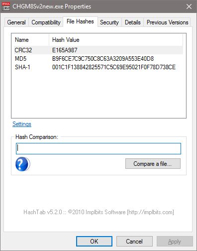

Postby steves1977uk » 11 May 2016, 18:42
Further investigation reveals there's a difference in the CCS checksums... The CHGM8Sv2old.exe is the prior version before I upgraded to Win 10, this one allows the Balance voltage to be up to 3.50v on the A123 presets, whereas the CHGM8Sv2new.exe don't allow it which is the version I downloaded today.
