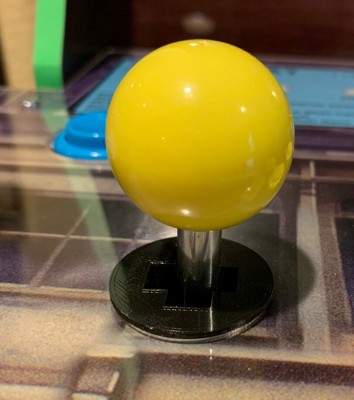

A CROSS type restrictor may help. See image of a joystick with a CROSS type restrictor plate. In this case on an arcade game. This shape of restrictor could be 3d printed and added to your joystick. It allows ONLY forwards. ONLY left or right. ONLY reverse. You cannot steer as you go forwards. I and most people would find that highly frustrating and a bit dangerous! But you cannot steer or go straight anyway. So for you it may help

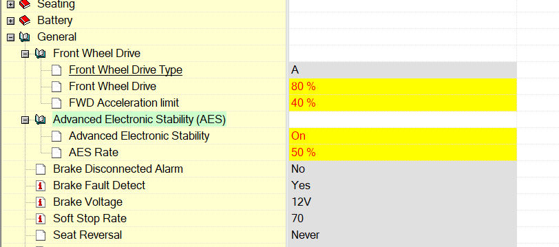

Postby Burgerman » 09 May 2023, 08:00
Lets try again.
I already asked you to TEST this. You ignored me again.
1. SET turn speed, and minimum turn speed to 7.
2. SET the YELLOW fields, AS BELOW:
Do the ADVANCED ELECTRONIC STABILITY first on its own. And do not set is above 55. And TEST. It should help you.
3. AFTER you test the ABOVE (2) then test the FRONT WHEEL DRIVE TYPE as shown, seperately. So you know how that feels. It MAY help you or may make it worse. TRY these SEPERATELY.
Then TEST With video so I can see.
Posts: 69891

Re: help me
Postby slomobile » 09 May 2023, 13:32
q700m wrote:Image
these settings are almost fine for me, but the joystick forward is still very sensitive,
is there a setting to reduce the sensitivity?
Maybe try
Minimum Forward Speed 0%
Minimum Reverse Speed 0%
and consider increasing Maximum Forward Deceleration and Maximum Reverse Deceleration so you can stop quicker if you let go of the stick. You want that as high as it can be without feeling like you will slide out of the chair when you let go of stick.

Postby q700m » 10 May 2023, 15:30
ADVANCED ELECTRONIC STABILITY ON
how to do the test to find out if it works?

Postby Burgerman » 10 May 2023, 15:59
DRIVE
Better or worse?
I doubt you can tell while you are waving arms and legs around. You must sort out the seating, straps, velcro etc.
Posts: 69891
Re: help me
Postby q700m » 10 May 2023, 18:53
with these settings it is fine for me. the motors are less nervous .
