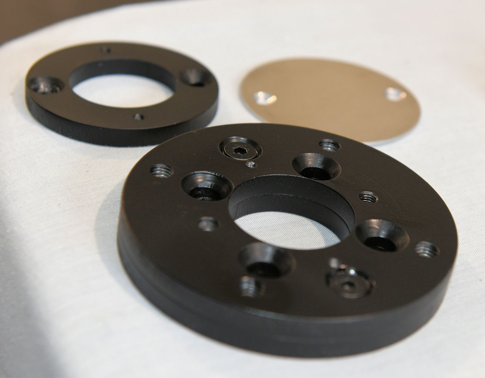

I feel sure they could fit different wheels.
They would just make the hub to suit. I have the hard job, I have to make these three parts each side, to make their hub, work with my wheels...

I would get them CNC machined, anodised black, and about 10p each from china in lots of a 1000...
Because its way way too hard to make one by one with a pillar drill. And the accuracy you have to work to is too high. Takes ages to get them exactly right. But how many have the ability or confidence to even swap a wheel - even with a kit of parts? Most uusers wouldnt like the risk, warranty worry, and anything out of the norm. The manufacturers shoud do this. And the other stuff.

Seriously, if I was going to do that I wouldnt make adapters just hubs. That fit 20mm taper or 20mm straight shafts as most bigger powerchairsuse one orthe other. That were if you like universal. So many different wheels could be fitted, with a selection of different depth spacers included. 3, 4 and 5, 6 studs. Drilled and tapped for all types. And sell on ebay. Red green, blue, gold or black anodised. And could sell various wheel and tyre combinations to suit all too.
It would be easy to organise, and build a database of chairs/motors/wheels that fit.
But other than a few techy types on here, nobody else would notice, car or buy. You would be better selling these as ready to go kits to say sunrise or invacare or whatever.

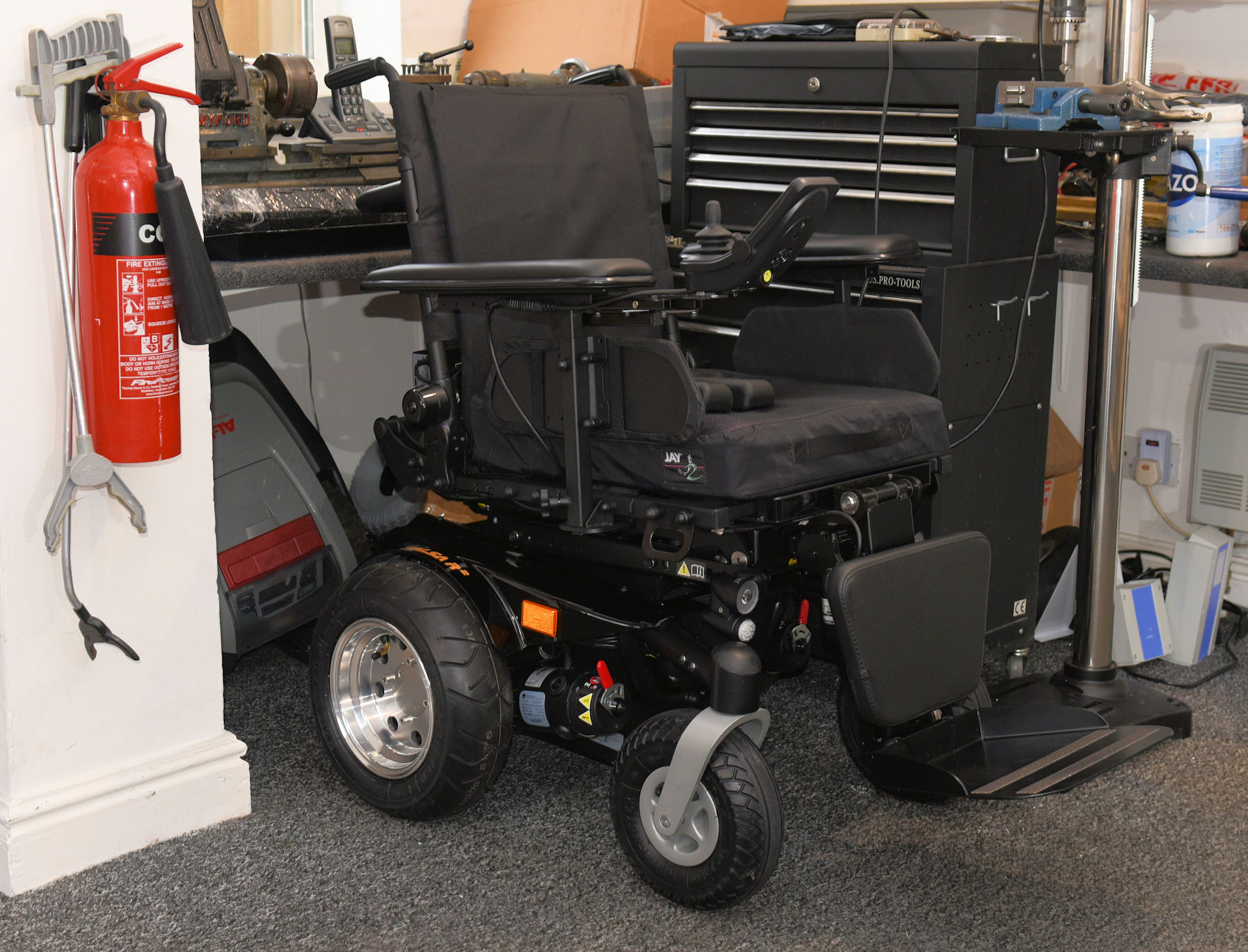

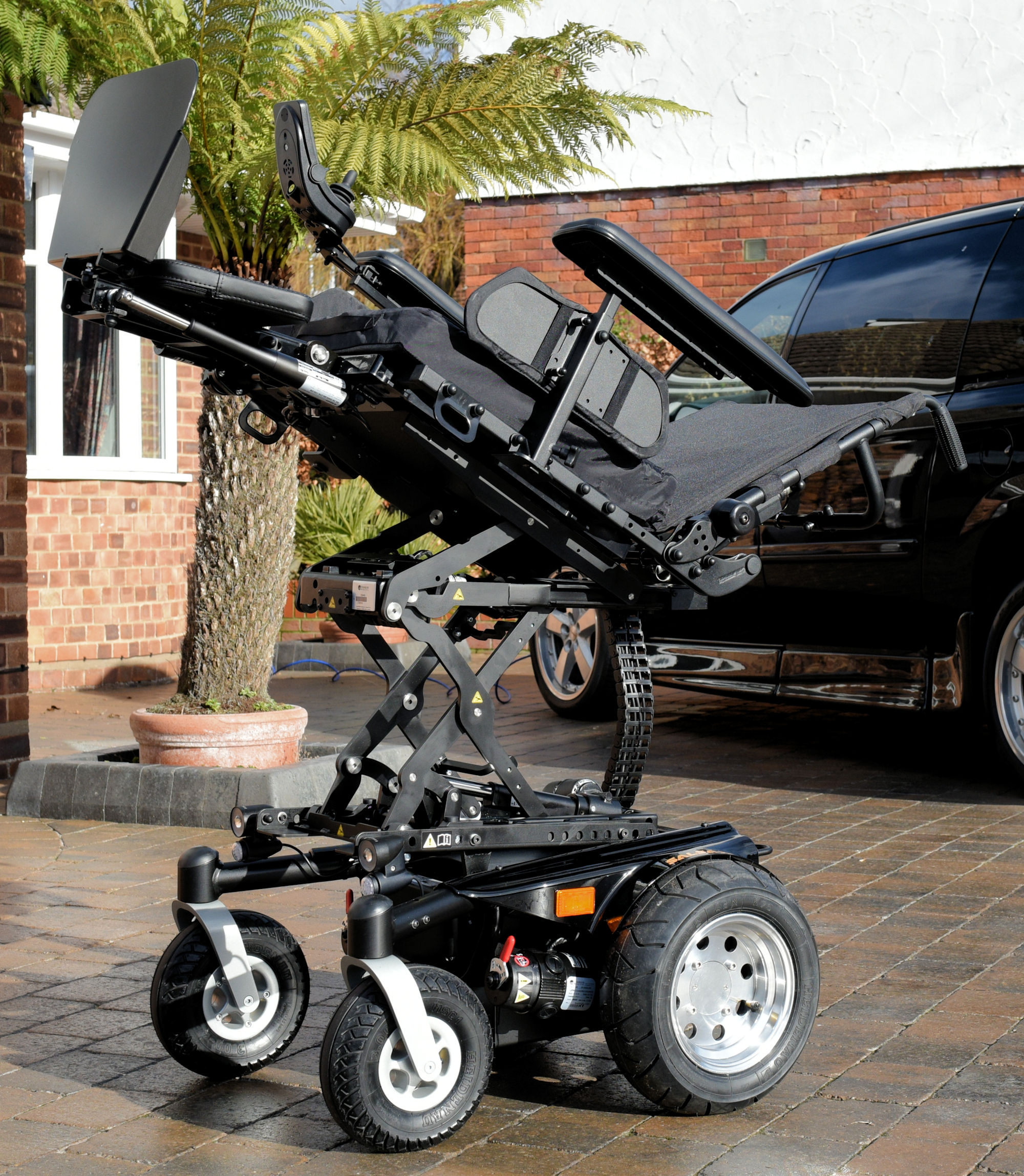

Done! Rims fitted. Just awaiting back/headrest. And removal of push handles.

Postby Burgerman » 10 Feb 2018, 22:25
Amazing how much difference a few small changes, seat position, modified centre footplate etc can make.
From nasty and unusable to cool and works!

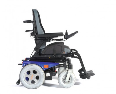

Heres what they look like stock, note seat position.
She is sat over the front. Wont steer, no rear grip, drives like an oil tanker. And nothing you can do because her feet have to be in front of the casters as they rotate when reversing. Stupid. Even worse if you are fat! Your weight is even further forwards.
Posts: 70441
Postby hank » 10 Feb 2018, 22:31
You would think it was a different model chair now.
What pressure you running about 20-25 psi in rears.
Postby Burgerman » 10 Feb 2018, 22:34
Seat is only around 3 inches further back And feet maybe 4 inches too. But that makes a huge difference to controlability and feel. The slightly wider rear tyres give more steering "leverage" too, also helping steering response. Footplate still too big however. I see a saw in its future...

There is no right position, only the best for you. I like my chairs light on the front, centre footplate so that your heels are between the caster wheels, and legs tucked as far back as the footplate/casters allow. That aids steering, feel, and allows less battery to be wasted steering, and gives better control on carpets, grass, slopes, ramps etc. And makes the chair shorter with no corners to hit doorframes etc when turning into rooms or turning around in a confined space. Also means a flat caster tyre or even one wheel missing does not prevent you getting home from the pub! Or even going to the pub!
Too far back gives less stability climbing a ramp forwards, and you tip out. But allows you to more safely decend a curb or ramp forwards. Best position is the one you prefer.
Look here: download/file.php?id=7710&mode=view
My back/my back is about 1.5 inch ahead of the rear wheel centre point. And my seat cusion front is about 1.5 inches behind the caster wheel barrel.
Look here: http://www.wheelchairdriver.com/BM3-con ... 3-crop.jpg
Same thing. Only more so. Why more? Because the new chair has 100lb of heavy seating up high! And it would tip me out on a ramp.

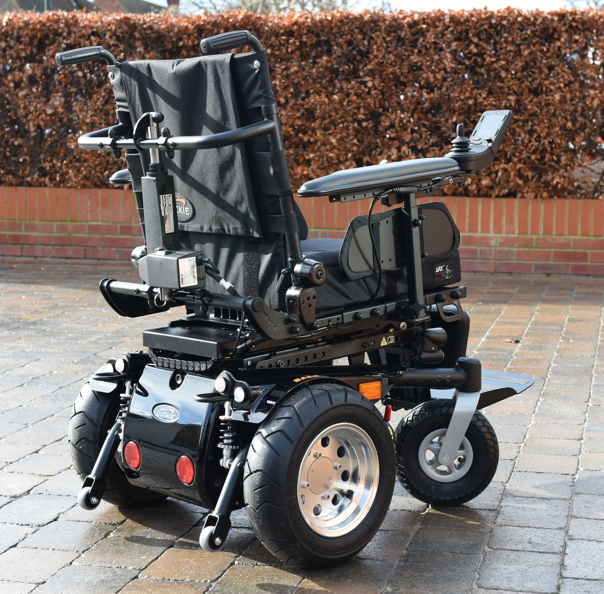

Postby Burgerman » 11 Feb 2018, 15:03
Dirty tyres...
Awaiting seat back, push handles to be removed...
Then other than the tie down bolt, and the lithium pack, we are done with it.

Postby Burgerman » 11 Feb 2018, 16:00
Yes. Its 27.75 inches and thats with a 10mm gap to the motors.
However I intend skimming about 7mm per side off each spacer leaving 3mm or 1/8th inch between tyre/motor case. So final width will be 14mm or half inch, less. So about 27.4 to 27.5 inches.
For a small person this would be a bad plan. Your chair would end up wider than need be. But when you consider that I am 20 stone plus, and use 18 or 20 inch cusion, and that with the "comfort" parred P shapes arms the chair is 27.5 wide anyway! So not a lot of advantage in a narrower tyre width. Now it all matches... So in my case this doesent make the chair wider. In most peoples cases it would.
And at 20psi it feels about right. Maybe 2 less. Nice big soft tyres deform and give a smoother ride than 36psi stock grey skinny ones. And of course these are a lot stronger and no tubes to pop/leak. So all around fair bit better for my purposes. And they look pretty good in real life compared to pictures.

Postby Burgerman » 11 Feb 2018, 22:08
Gone ofF heideneu whatever they are called tyres. One keeps deflating, at the rim and they say tubeless but I dont think they are. The beads and interior do not look tubeless. Maybe fake? So ordered a set of proper ones!

Postby Burgerman » 11 Feb 2018, 22:45
Yes because I never once had an issue in 20 years. I just reduced pressure to 3 psi. And pushed the tyre off the rim. Its supposed to be a tight fit over the two ridges. So I suspect the tyre is a fake and its or rather they are going back to shire bikes to let them figure it out.
I ordered a set of Duro tubeless 120/70 - 8, an hour back. Of course it could be the rims? But thats unlikely. Its easy to get dimensions right in alloy! I am going to measure them.
