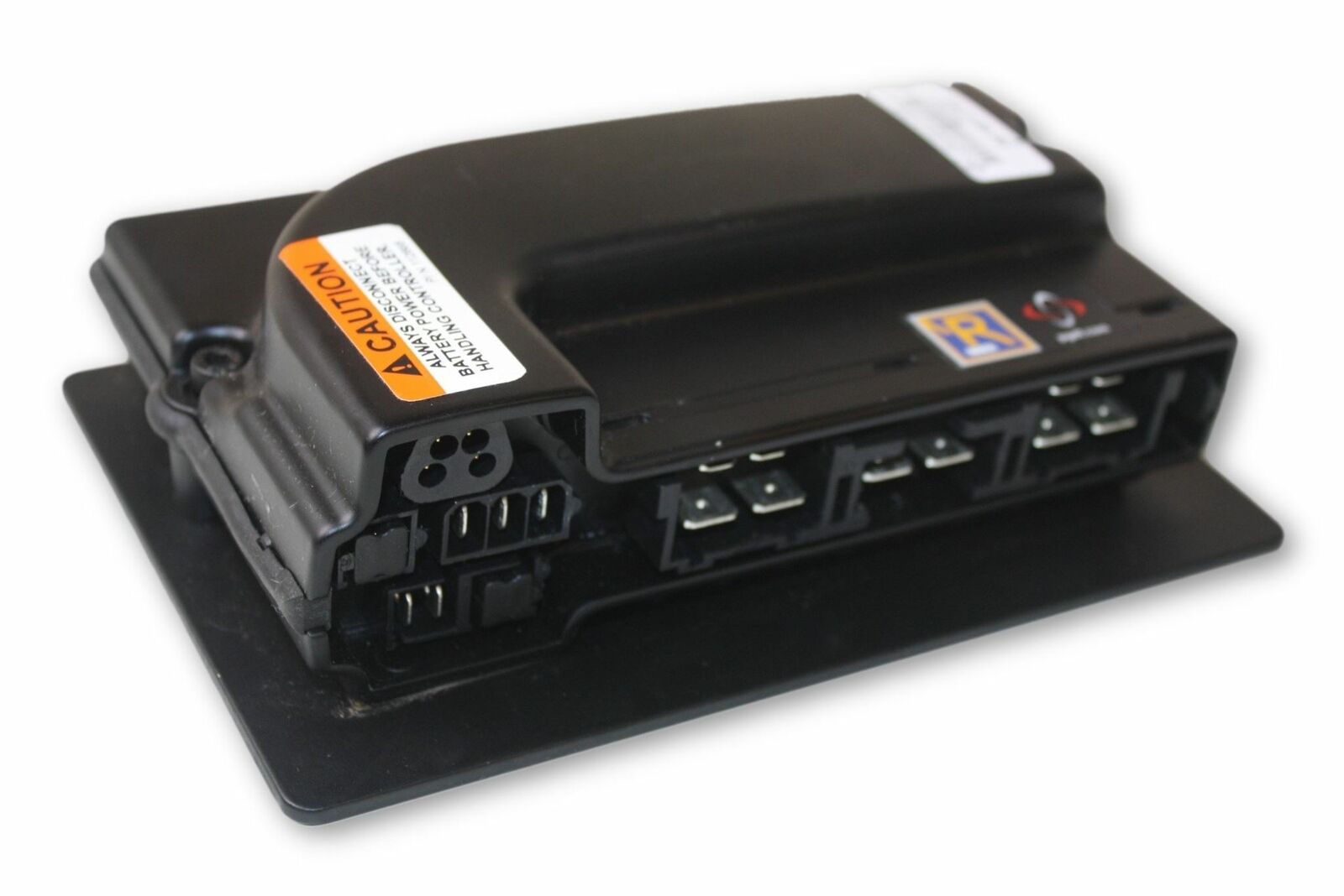

Postby Burgerman » 20 Jan 2020, 12:21
https://www.cw-industrialgroup.com/Prod ... wer-Module
This is the PM90 or EL 90A unit fitted to lots of cheap 2 pole power chairs. Its a 70A with 90 boost for a couple of secs, includes actuator output. So cheapest way to do a basic chair. Missing 30A of the 120A version.
Yours is a custom build 120 - made into a single channel unit by modification. Not on the website that I can see. Custom build for meyra or other manufacturers that want to steer a scooter/car/buggy with a joystick. I saw one, so know they exist, cant find anyreference to it.

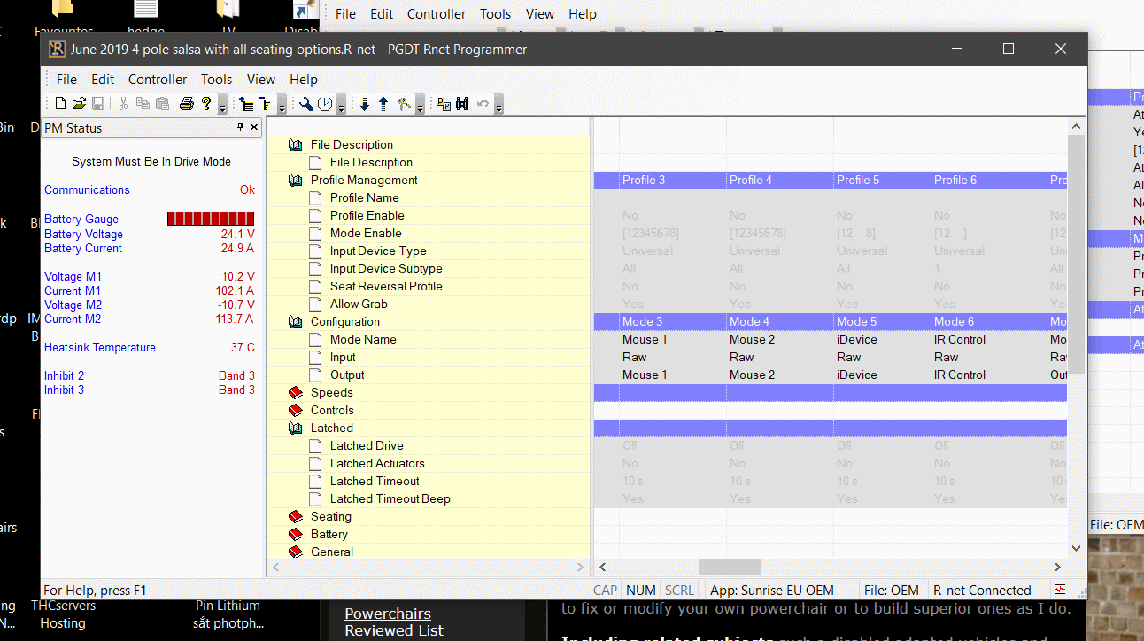

Why you need the 120 module!
This is my salsa. rear drive. 185kg rehab style chair. Fat user (me).
NOTE the current required on each motor. If the power module couldnt supply that the it MAY or may not start to turn. But it wont be responsive. The chair wont follow the joystick properly. I hate that... See current M1 and M2 (Motor 1 and 2). This is not doing anything special. Just a zero speed turn in place in my hallway. If I do this on the lawn when its soft, its pinned at 120A on each motor. And wont turn reliably.
If this was an 8mph version, with taller gearing it would need 160A instead to get the same torque level. Theres no 160A power modules though... So for my purposes, 8mph motors are a step too far for decent control. It wouldnt (doesent!) turn reliably on a heavy carpet for e.g. Tested a few different 8mph motors.
Posts: 71102
Re: R-net
Postby Irving » 20 Jan 2020, 12:55
Burgerman wrote:Why you need the 120 module!
But would the Meyra need 120 given its not doing zero speed turns.... its a scooter :D so 90A probably sufficient?
