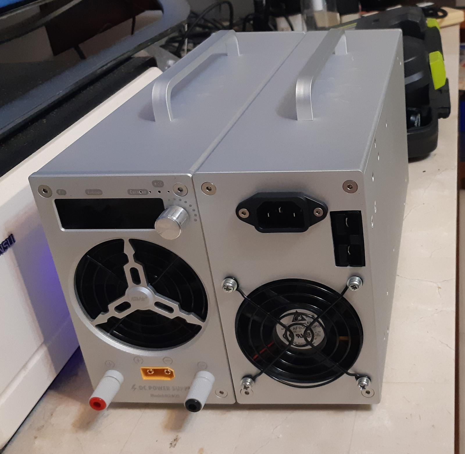

For some time now I've gone back to using an on 24V 47A PSU for powering the PL8. It's lighter, smaller and more robust. It's two old computer PSUs gaffer taped together. I'll upload a piccy later :thumbup:

Postby Scooterman » 24 May 2022, 19:20
If this isn't a dumb question. Why is one of the handles on upside down?
Is it for the antipodean market? :lol:
Postby martin007 » 24 May 2022, 19:22
So that you can contemplate it from both sides.
Posts: 4028
Postby Burgerman » 24 May 2022, 19:32
You can build these with the internals either way up.
Posts: 70457

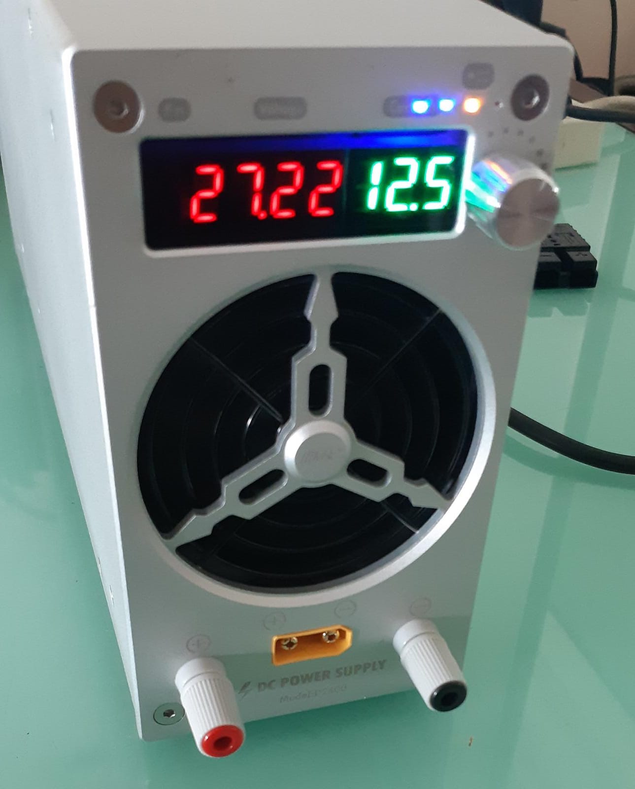

Postby shirley_hkg » 26 May 2022, 05:35
Testing a Anderson SB50 + XLR split cable.
12.5A will be fine, in cool days.
10A is more comfortable , all year round.
This unit is QUIET.
You'll get a nice ZXD, Jeff. cheers
