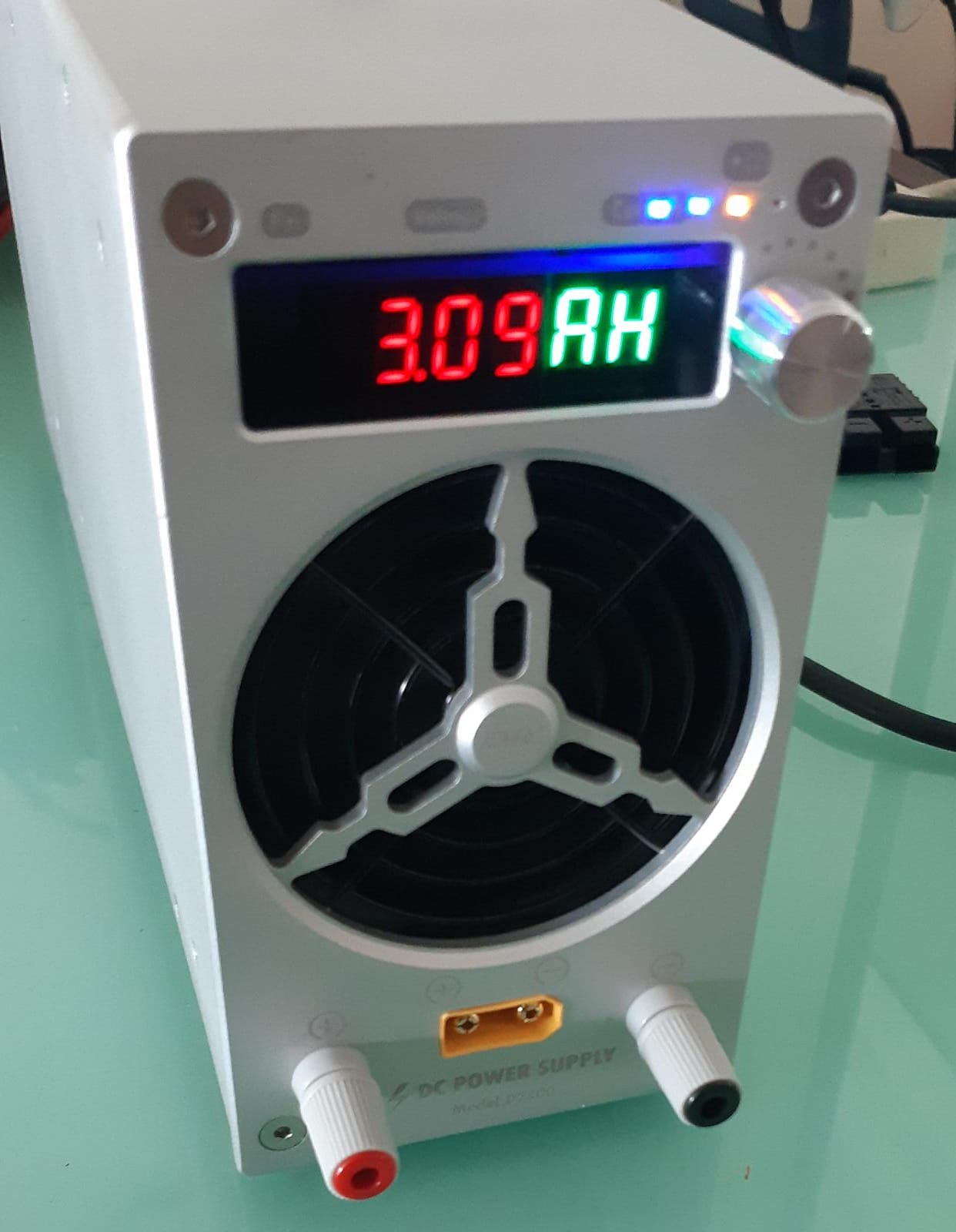

Having screwed up the ZXD programming another time, but this time while seeing what I'd done, I now know what caused it. While working on something mechanical on a chair my knee pressed the ZXD button long enough to send it into auto calibration. As soon as that happens, even if you don't go through the calibration sequence, it resets the program. That "reset" program is what causes it to output only ca. 1/2 of set voltage. Nothing's actually broken.
The fix, as already noted, is to re-do the auto calibration and then check that the factory menu settings are where you want them.

Postby shirley_hkg » 26 May 2022, 05:26
No. It's a power supply only

Postby shirley_hkg » 26 May 2022, 05:35
Testing a Anderson SB50 + XLR split cable.
12.5A will be fine, in cool days.
10A is more comfortable , all year round.
This unit is QUIET.
You'll get a nice ZXD, Jeff. cheers
