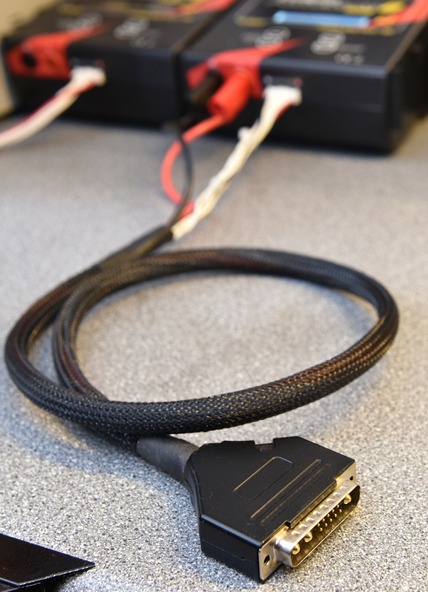

Postby Burgerman » 18 Nov 2016, 14:03
This is how simple charging a lithium chair is.
One connection. Plug in. Press go.
Or press go on the PC Software on your laptop and monitor it as it charges from 5 to 40 Amps. And balance cells as it goes.
Posts: 71107
Postby Gnomatic » 18 Nov 2016, 18:30
That looks good. About how long is your charging cable in your pic?

Postby Burgerman » 18 Nov 2016, 21:26
A metre. Make it longer if you must! But its adequate.
