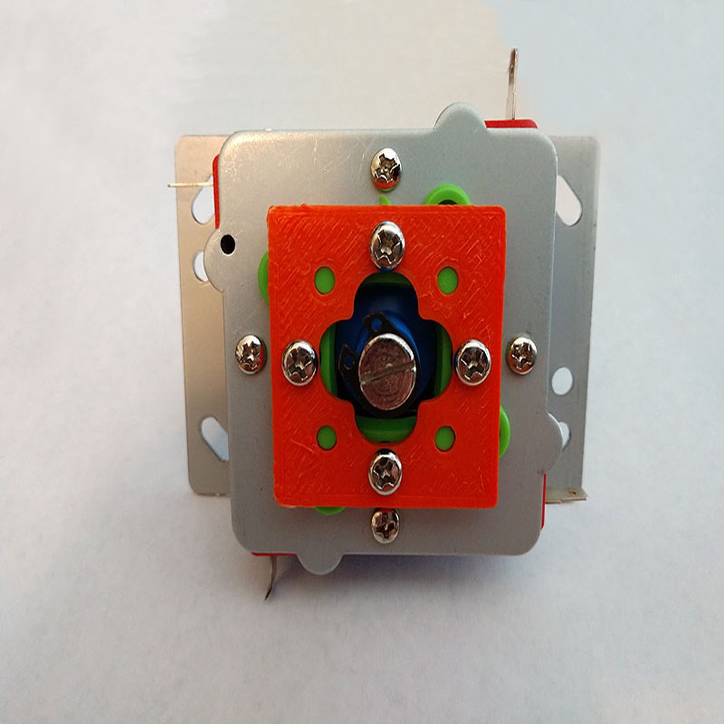

Several people inc myself, lenny, have suggested shaped restrictor plates on maybe 10 different posts. But so far we just get the standard nonsense about reducing compnsattion and setting everything to 1...

Postby Burgerman » 18 May 2023, 17:25
Your joystick moves in a circle. It allows your hand to turn the wheelchair while rolling forwards.
A DIAMOND shaped gate will not allow that.
Here are TWO different ones. They do not allow your joystick to go left or right while going forwards. THAT is one thing that wil help you.
Orange one means you can go backwards or forwards. OR left or right.
Blue one means its very hard to go left or right while traveling forwards. Its less extreme.
Posts: 69895

These are all obvious by "feel" to me. However the way you use a joystick I doubt you wil be able to feel what is actually happening. A RESTRICTOR plate for your joystick will give you much more control. But you keep refusing to reply or talk about it.
Posts: 69895
Re: help me
Postby q700m » 19 May 2023, 16:12
Burgerman wrote:These are all obvious by "feel" to me. However the way you use a joystick I doubt you wil be able to feel what is actually happening. A RESTRICTOR plate for your joystick will give you much more control. But you keep refusing to reply or talk about it.
the problem is where to find the plate and who mounts it?

Postby Burgerman » 19 May 2023, 16:38
Who makes it?
Who mounts it?
Either you do. Or as has been said earier you need someone like me with a brain, and some ability to take charge and sort your problems out LIKE ME but over there. And that means finding some expert that has these abilities. Which is not going to be easy.
