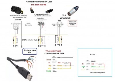

Here is a pic ...there are more scattered through out this thread...use the later ones... 2018 onwards.
Check your messages

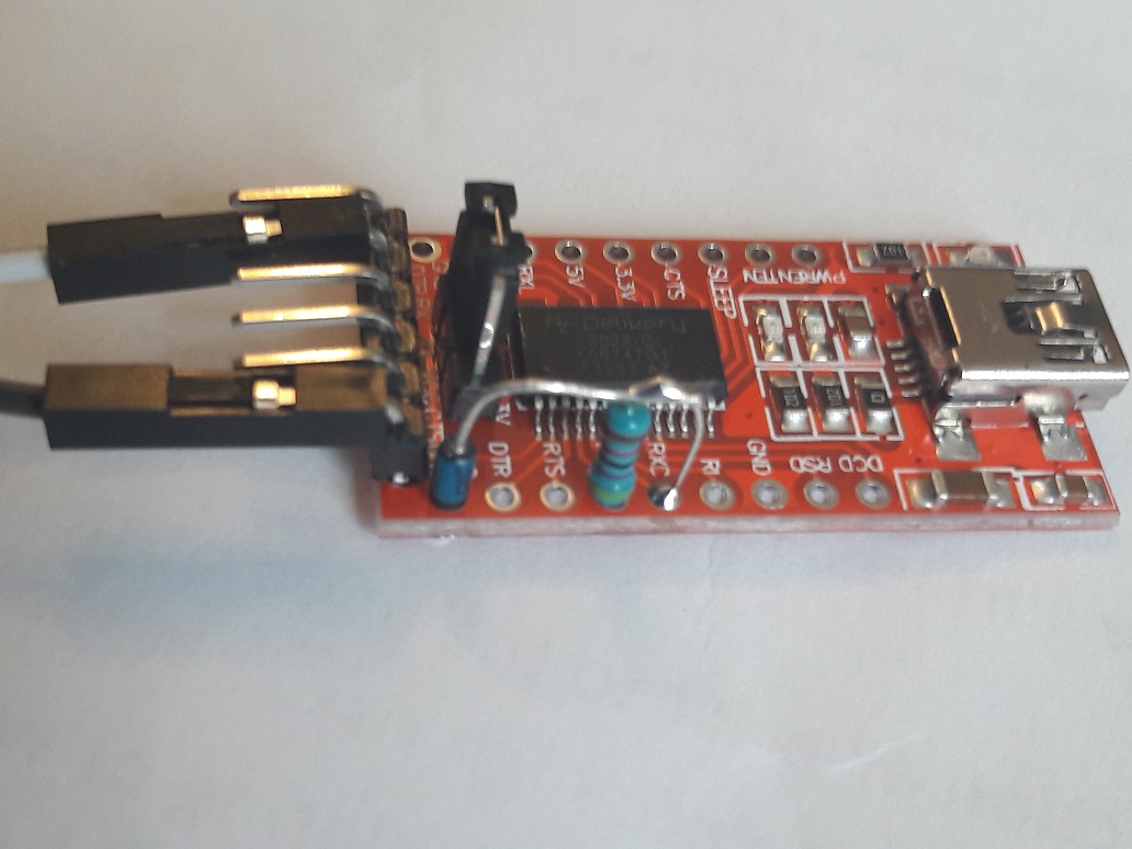

You can also use a cheap TTL-USB fake FTDI clone as the basis for the programming lead.
Using the same 47k resistor and Schottky diode as is shown in the previous pic .

That's the image I was planning of referencing and using to make up the cable.
Can't Thank You enough Woody, been looking how to do this for a very long time. Better get the cap and diode ordered now.
cheers

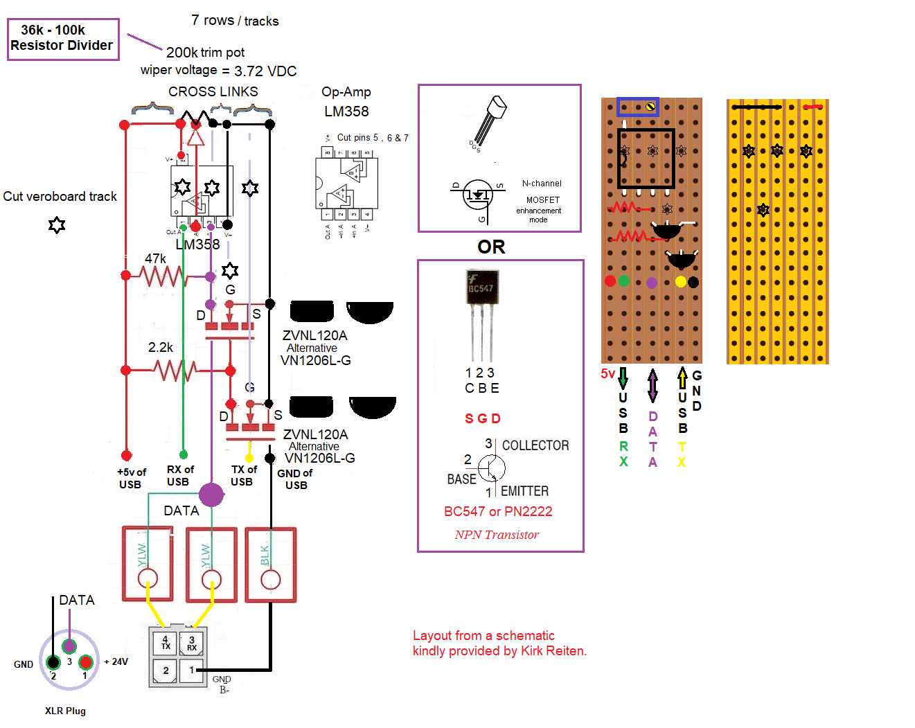

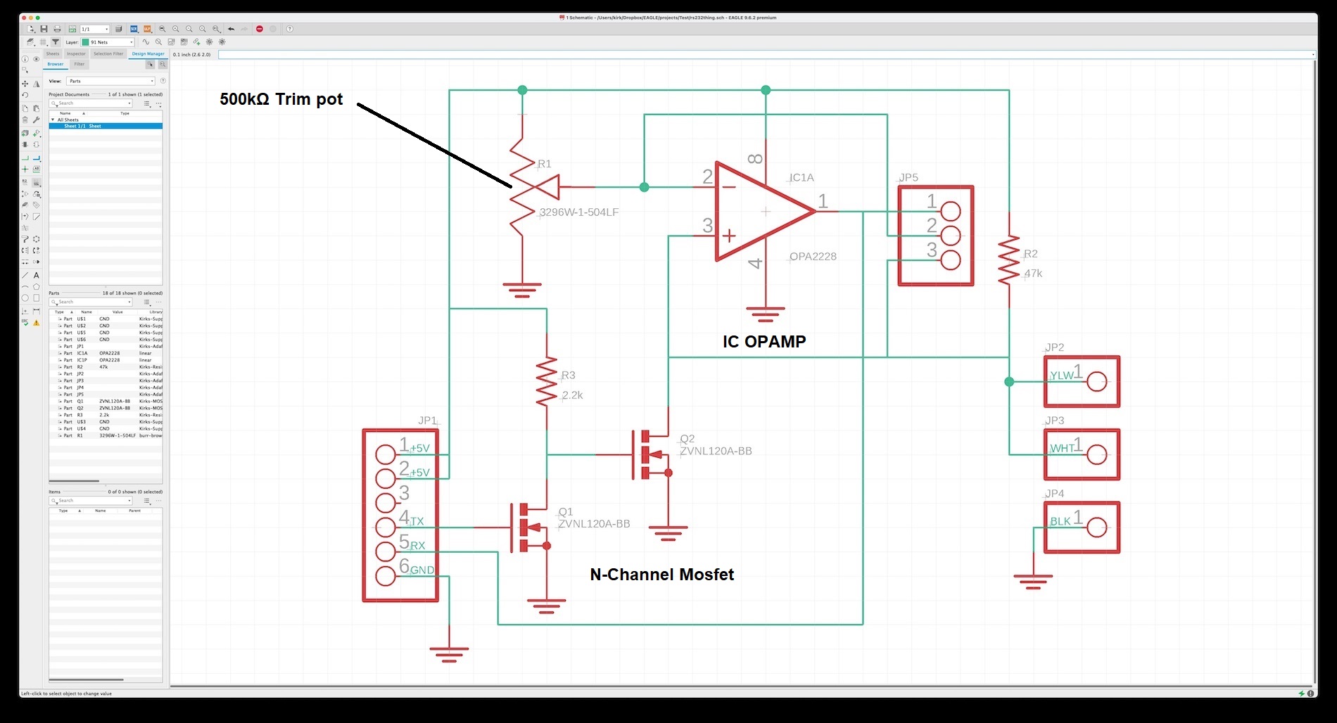

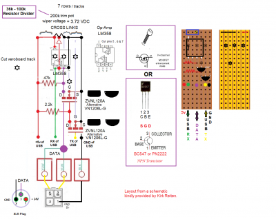

The 140 Amp ( and other larger Amp ) S-Drives have been reported as impossible to communicate with the simple resistor / diode modification.
Kirk from this forum has provided me with a solution ...schematic below.
My layout below.....
This has been made from his schematic and tested.
NOTE:- The same USB Cable can be used for Comms ...but it needs the circuit above instead of just the Resistor and Diode.

It appears to be caused by a signal incompatibility problem ( non standard TX voltage being output) and nothing to do with the type of chip or cable used.
The OP Amp brings the transmitted TX signal to a compatible level for the RX of the USB - TTL UART to transfer over to the MOBILITY programming software.
Strangely this only seems to affect the larger Amperage S-Drives.
Note:- The circuit also works just fine with the other models in the P.G.D.T Range. ... VR2 , Vsi , Pilot+ ,Egis and Solo ...and as a bonus works with ALL the different makes models of USB-TTL adapter that I have....these include FTDI ( Fake and Genuine ) ,Prolific PL2303 , Chiphead CH340 & Silicon Labs CP2102.
