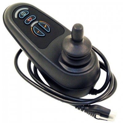

Postby expresso » 11 May 2019, 18:26
when searching for these PM and JS - etc, - Rnet - i find many with different numbers codes on them etc, - why so many different codes and numbers - does that make a difference - forget Permobile models - i dont trust them they may or may not work correctly - how can someone even know if they are getting the correct PM or JS for there chair -
if an PM or JS comes off a permobile - should that be avoided - will it work on a quickie chair - etc, i dont see what so many different codes - even same PM Rnet 120A - etc, may have different codes on them on the label - how can someone figure it out to know if they are getting the correct PM - ?
Re: R-net
Postby Burgerman » 11 May 2019, 18:36
The different numbers refer only to the OEM number mods. So it may say permobil on screen. Instead of say pride or incacare or whatever. And a power module will come preprogrammed for a specific chair model. So you can put it into stock, sell to a user and its got correct programming for things like motor compensation, that specific chairs default settings, motors, and gyro/seating options etc. No programming required. And different firmware updates. All are still compatible but may need programming correctly.
If you have an OEM programmer, anything that says R-Net on it SHOULD be just plug and play. As long as you add your own programming file. You did save a copy onto the PC right? Or you might get to put 24V through your 12V brake for e.g.
So any. According to rover the only issues come from permobils own seating module etc. So dont buy those...
I for e.g. have just bought 2 advanced colour joysticks. Those are sunrise (logo on startup) but will work fine on any chair. Justr look odd on a permobil!
And I bought 2x 120A R-Net power modules. From a permobil M300 so those will want programming totally... But again will work on any chair.
And a seating lighting module that aparently comes from a permobil (ebay claim), which rover says is quickie/salsa one! Judging by the wires. None of that matters. Its all plug and play once YOU program it to work for your chair. If you are just replacing a part, a joystick or a module, or a gyro, no programming needed. The data is stored in the power module.

Postby steves1977uk » 11 May 2019, 19:06
TEN°
The TEN° handheld control device constitutes a small ergonomic revolution providing secure positioning and prevents fatigue. The high resolution 3.5” colour display features modern and easy to understand imagery. Additionally, the innovative rotary dial with a 10° rotation angle permits fast regulation of the speed whilst the housing is extremely robust and available in various colours.
Sounds familiar? From... https://www.recare.co.uk/powerchairs/co ... 066&pid=21

Re: R-net
Postby Burgerman » 12 May 2019, 08:21
Only the joystick being "odd" then. Since the OEM R-Net works, it must use the same internal electronics. Why? It must cost them extra to confuse people with what can only be described as an ugly and likely well overpriced joystick! And then the stock joystick must be ok to retro fit.
So if you prefer it, or your oddball 10 one goes wrong then logically the advanced colour one will be plug and play, with no need to even reprogram anything.
