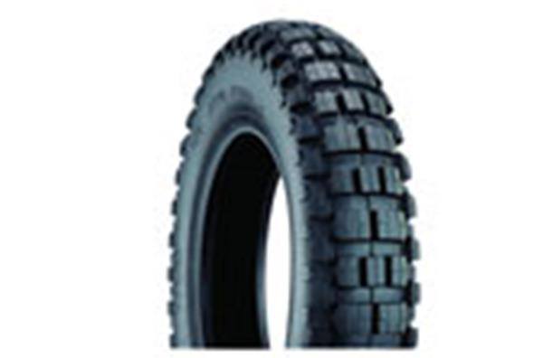

I found this tires [4.00 x 8]
I would like to know if this tires fit on my chair ?

Postby Burgerman » 13 Dec 2016, 09:59
Sort of. But the tyre really needs a wider rim. And it may hit something as its taller/wider by an inch.

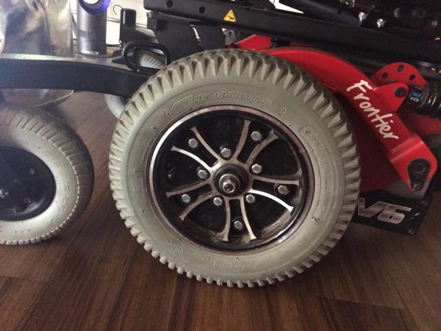

does anybody recommend a tyre for my chair?
i want taller tires but not wider
this is my one

Postby Burgerman » 15 Dec 2016, 10:02
There are no taller tyres that are not wider.
