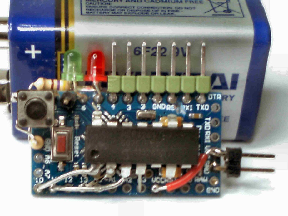

OK. The black one is now zeroed, set up, has a slightly tighter deadband, and I soldered my 3mm jack plug on it!
So will send the white one back?
I will do a page update, and add that email, and a description. But no pics yet as I don't know how a finished "production" one will look?
I just sent my chair around the college grounds. Its about a half mile trip, and it works perfectly, stops if I turn off TX, steers correctly, and works better than my original analog one.
Seems to have no bugs or issues, so good to go. Its very odd that you can get full forwards AND full left for eg at the same time though. Its correct, but a mobility joystick doesn't allow it. I am going to modify my pilot plus one to allow corners... Like a RC TX. If I can find a way.
