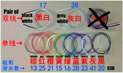

I bought myself another one , to kill winter time via modification.
A question to John / LROBBINS . Wires seem very thin. Is it adviseable to use thicker wires for the mod ? cheers
:thumbup:
:thumbdown:
ex-Gooserider , I labelled the colours of the wires and the numbers are length in cm .
Don't mess up the SINGLE grey and black wires with that of the pairs . They go to different nodes .

shirley_hkg wrote:I bought myself another one , to kill winter time via modification.
:thumbup:
:thumbdown:

ex-Gooserider wrote:Wire thickness:
Hard to be certain, especially since I haven't started the build yet, but from the photos, I would say that the thin wires aren't really a problem as they are basically just data / signal lines that don't have to pass any significant current.... They are actually HEAVIER than they need to be electrically in order to get enough mechanical strength... The only wiring that is ever a real concern is the stuff that carries heavy current, and that looks to be AWG 10 (or metric equivalent) which is adequate for the job...
OK .
What I mean is using thicker wires for signal will improve accuracy , or worse.
A bit more of a concern, and not sure how big of a problem it will be is that Steve's Google translation of the mod instructions were reasonably good on the text part, but they didn't translate the writing on the pictures... I think I can figure out most of it from the photos, but one item I was definitely confused about is in Chapter 3, right after they tell you to remove a pot, there is a blue board that is sitting diagonally with arrows pointing at the "G" connection on the blue add-on board and a hole in the main board... It isn't at all clear what they are trying to show :eh: My guess is that I'm supposed to connect that "G" point to something (what???) and not block the hole, but.... :?
There is a pin on the big PCB . You have the G of the
add-on board , through that pin , and solder . Avoid blocking the hole for securing a screw thereat later .
I also noticed the number of component parts in the kit don't seem to match the numbers used in the pictures - did they just give us spares, and possibly stuff that is only used in the other version?
YES.
They are spares . Only need one for each .
Lastly the thick black wire that goes between the main board and one of the add-ons looks like a red and black wire together. I see a length of red / black zip-cord in the kit; it looks like the cord gets split and the red half gets used on the lamp - is the red stripe on the black wire just left over from splitting?
You are right . Just leftovers from its red half .
Stop , if you see any ambiguity , and don't hesitate to ask before going .
