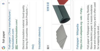

Burgerman wrote:Fish?
Do you mean gasket paper?
What is it made of? Dont say fish... :clap
No wonder I couldn't find it on :ebay All I could find was fish patterned wallpaper! :lol:

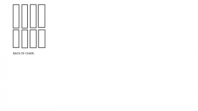

Postby terry2 » 08 Mar 2019, 15:55
This is how I need my pack to look like once it's wired up.
The problem is that I don't know how to do this.
I have been on you tube, but nothing so far. Can some kind person help please.
Postby terry2 » 08 Mar 2019, 16:09
terry2 wrote:This is how I need my pack to look like once it's wired up.
Forget that picture. I have it wrong.
I haven't got a clue :(
