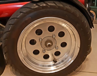

Burgerman wrote:The centrenut, will also require the rim to be spaced 16mm with 1.5mm centre cover to miss the nut...
Or simply leave it alone .
Hi, I must admit I get a bit confused regarding wheel rims. Personally I'm not overly fussed about about a centre disc, afterall it's only for aesthetics? The main thing is the wheel fits, and the tyre doesn't is close to but doesn't foul the motor.
Postby Burgerman » 28 Mar 2018, 13:51

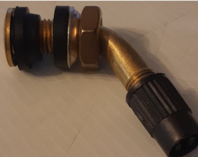

Well if you dont care about ugly, fit 2 valves, fit the wheel on backwards, and make a spacer for that! Valves https://www.ebay.co.uk/itm/1-x-90-Degre ... SwY99ZiwR8 REAR wheel only.

Burgerman wrote:Valves https://www.ebay.co.uk/itm/1-x-90-Degre ... SwY99ZiwR8 REAR wheel only.
So would it be one of these for the Hendeau's on the front? scooterman scratches bonce :problem: https://www.ebay.co.uk/sch/84149/i.html?_from=R40&_nkw=tubeless+tyre+valve
EDIT: Whoops sorry I just read where you said only the H rears are tubeless. Silly me.
I agree I think that would alright with a shiny 1.5mm centre cover.
So is this a 2.75 rim with a 3.50 tyre. With the rim put on backwards?

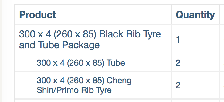

The Cheng Shin/Primo Ribs are going back. But what about the two tubes? Are they any good for the 3.00 x 4 Hendau's
You cant fit one, because the wheel is closer to the chair, the nut sticks out proud of the rim...
Hmm, I see what you mean... I think the one in the photo looks worse because of the tarnished wheel hub, rusty shaft, and rusty nut. But maybe if the hub, nut, and shaft were painted black that might not look too bad? It might sort of look like a black hub cap? Sometimes a black and silver work quite well together?

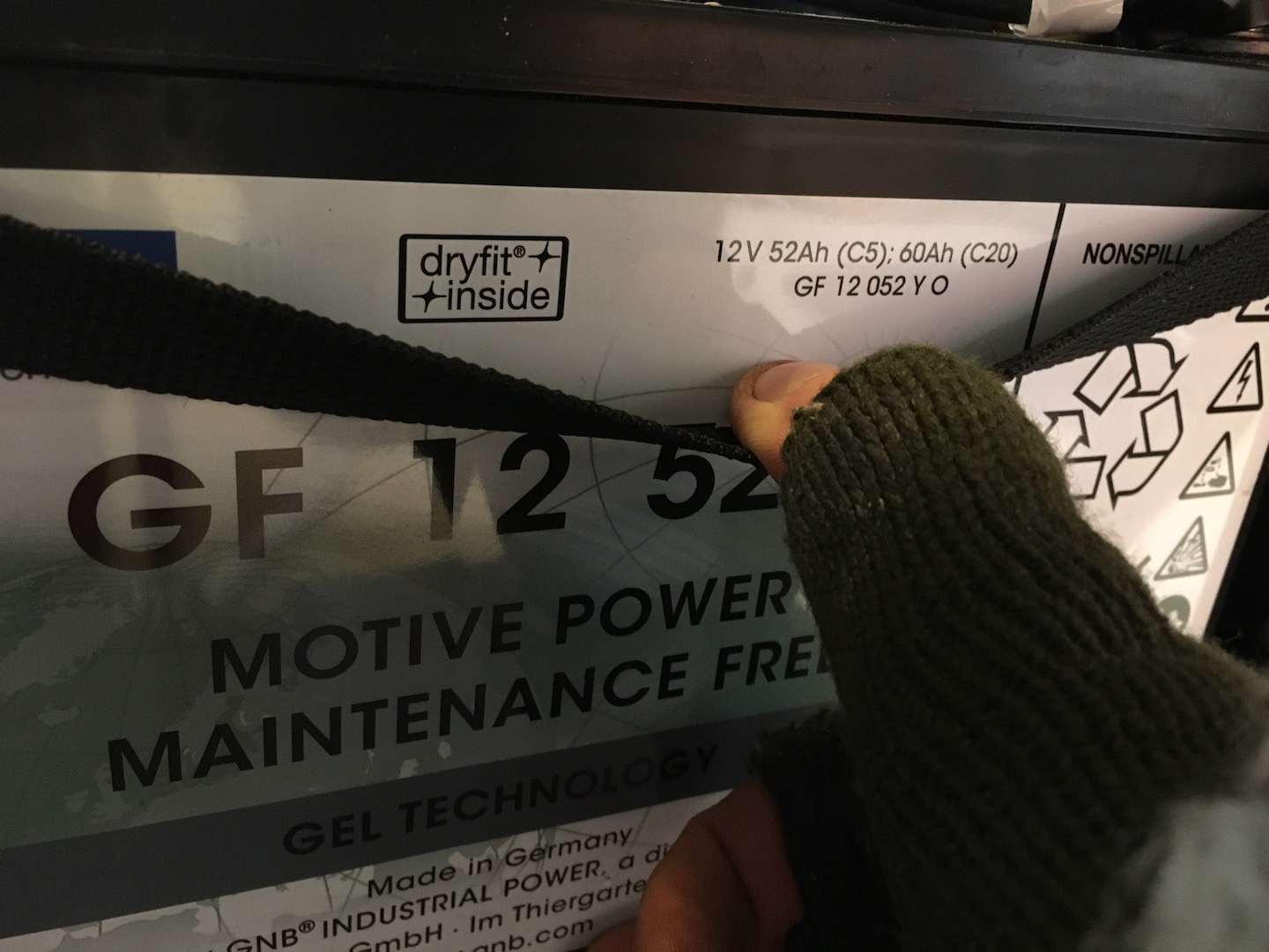

Understood will do. I’m lying on the bed injured the moment but I plan to get down on floor later on this morning to have another look at introducing BUCKET! into the tilt/elevate unit. I will take some photos and measurements then. I did espy the other day my batteries are sonnenshein, but I couldn’t see the Ah rating and want to check out of curiosity anyway

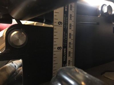

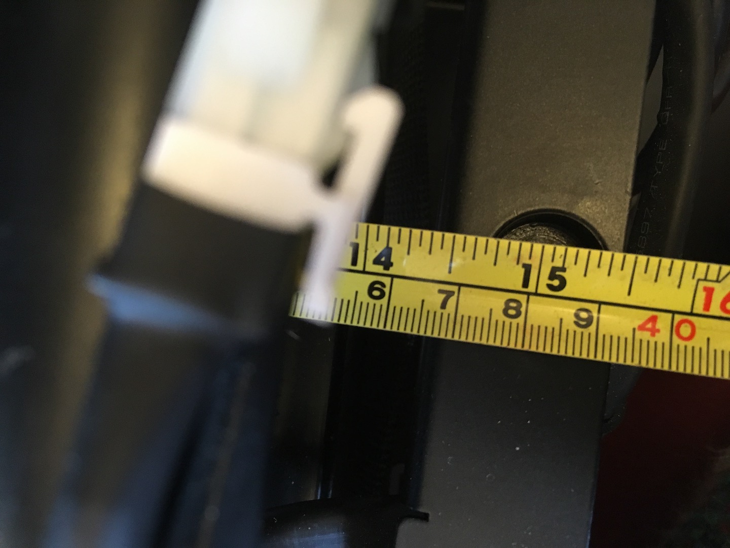

BM Couldn’t remember precisely what measurements you wanted so took a whole load of Photos. If you Have any queries regarding the photos I’ll be back on my laptop later on

Battery compartment is 14.5" long by about 9" high. I forgot to measure width but I can do that tomorrow if need be. But it looks to be about 1" wider than the sonnensheins.
There is however A LOT of room above the batteries. There are two chassis tubes that run crossways over the batteries. Tubes must be >3" above batteries. I can measure more accurately when T/E unit is removed for dump modification

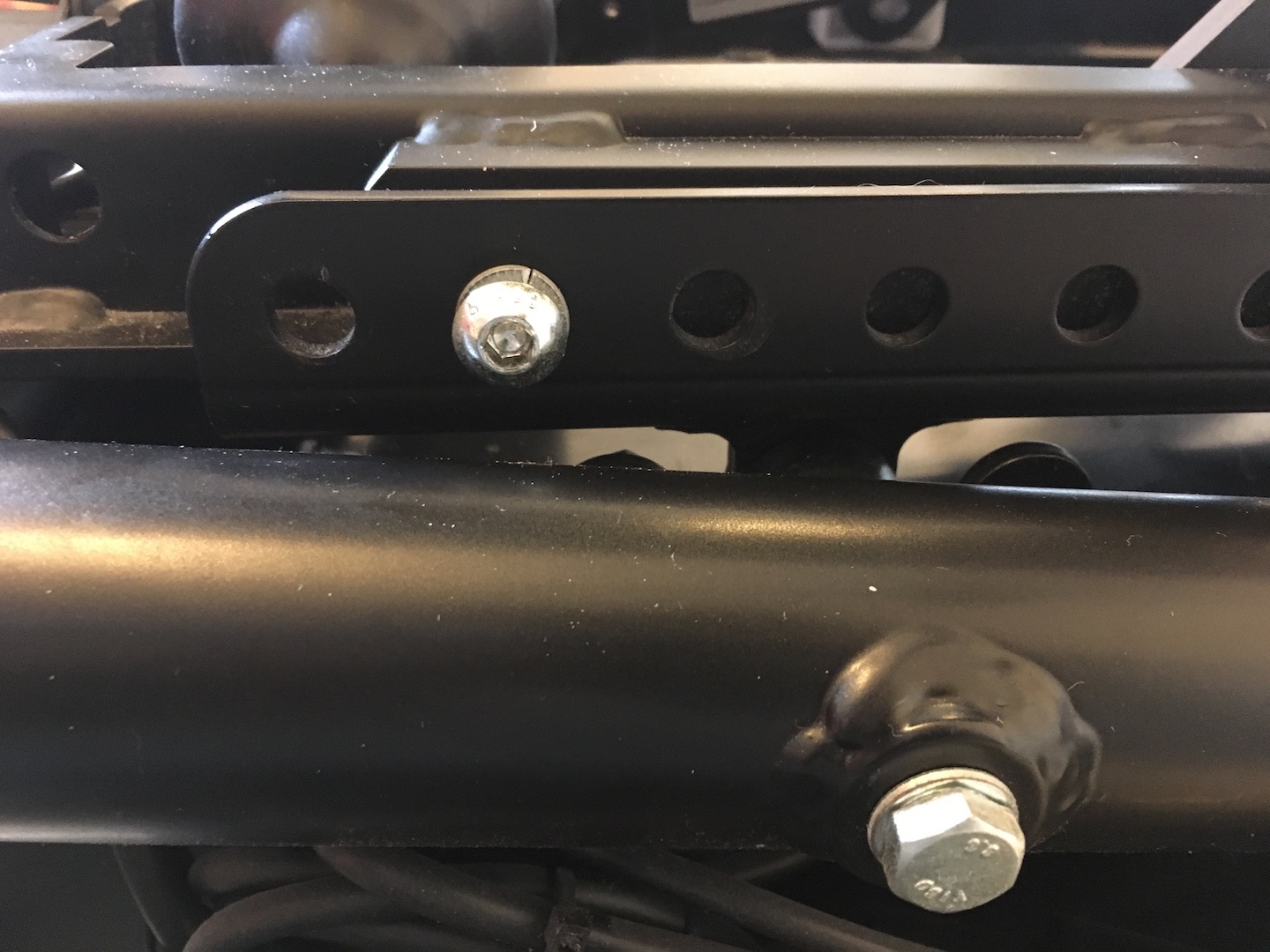

Re T/E unit dump.
Job lot of photos here: https://flic.kr/s/aHsmgH55ZE

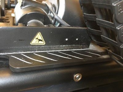

I worked out that if I remove this flange here:
Bolt T/E unit in this position:
Then maximum dump can be achieved on front lugs here:

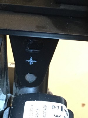

The decision now is whether to dill ONE hole, or TWO, equal distance between existing lug holes. Two looks to be quite tight but would give four dump positions. As I'll be hand drilling with small rechargeable it might be best to play safe and just drill one?
Opinions sought?
PS: Scratchy head re purpose of flange which doesn't seem to do anything apart from get in the way. Then lightbulb moment! The whole point of it is TO GET IN THE WAY. It's there to stop the T/E unit being bolted into rearmost position with maximum dump. It's obviously a safety feature so rider doesn't go A over T with seat at max T/E.
If you drill a hole in between the two existing ones, as I did, and make the rearmost lift to rail mounting bolt hole oval with a rat tail file, you can have more dump, and the lip rides over the rear frame rail. So best of both.
