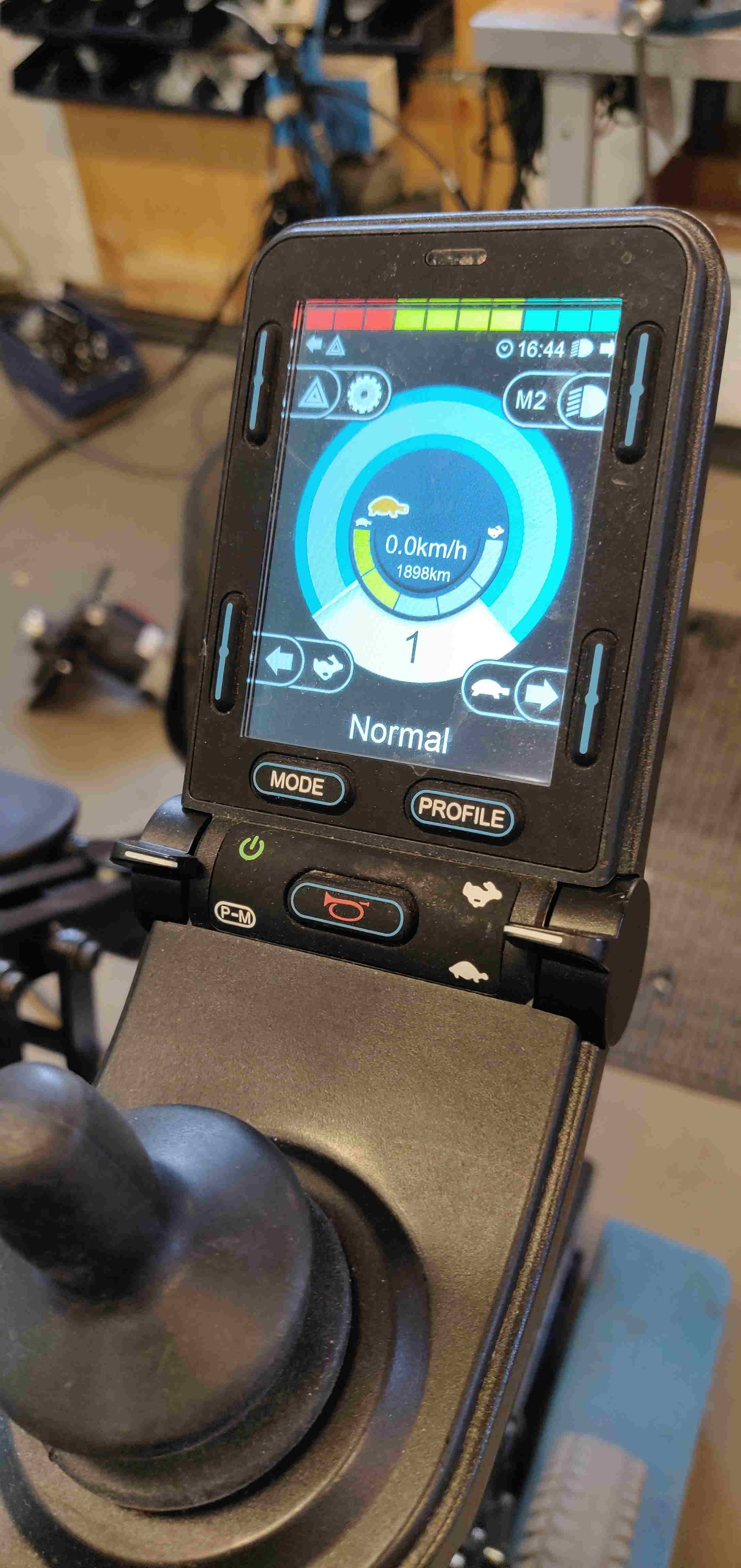

Postby Roadrunner » 20 Mar 2021, 17:47
Here´s what it looks like.

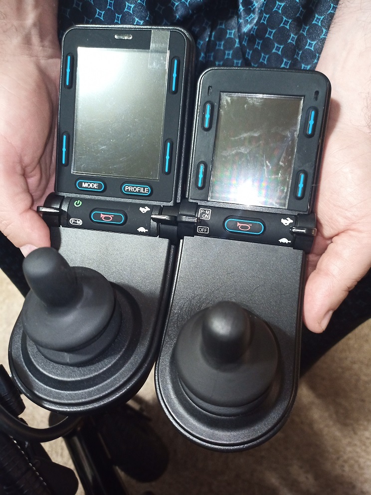

Postby steves1977uk » 21 Mar 2021, 13:30
That pod looks like a standard PG CJSM2, not the smaller Permobil style.
Also I'll have to try adding the missing side options to one of my spare 120A PM's since I have a few. Although I think the generic software don't have the missing settings in its data files which is probably why they're not shown.
