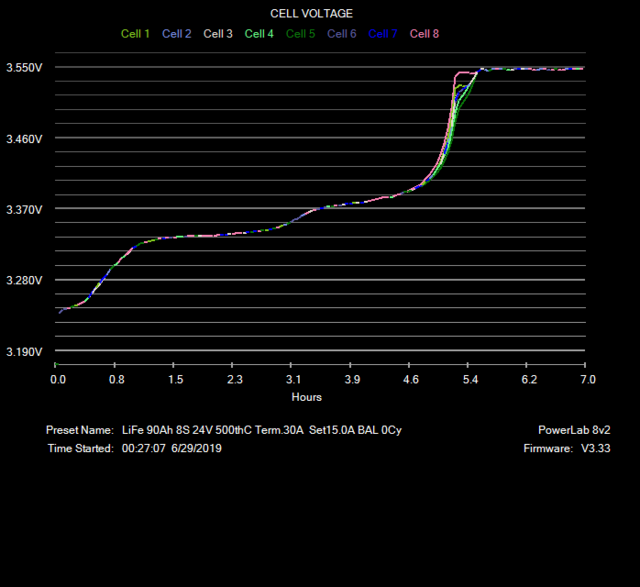

shirley_hkg wrote:Only 1 mV , while discharged to the last 0.1 . . . . amphere hour. goodpost
Top banana shirley! :thumbup:
You've achieved perfection, best graph ever!!! :worship

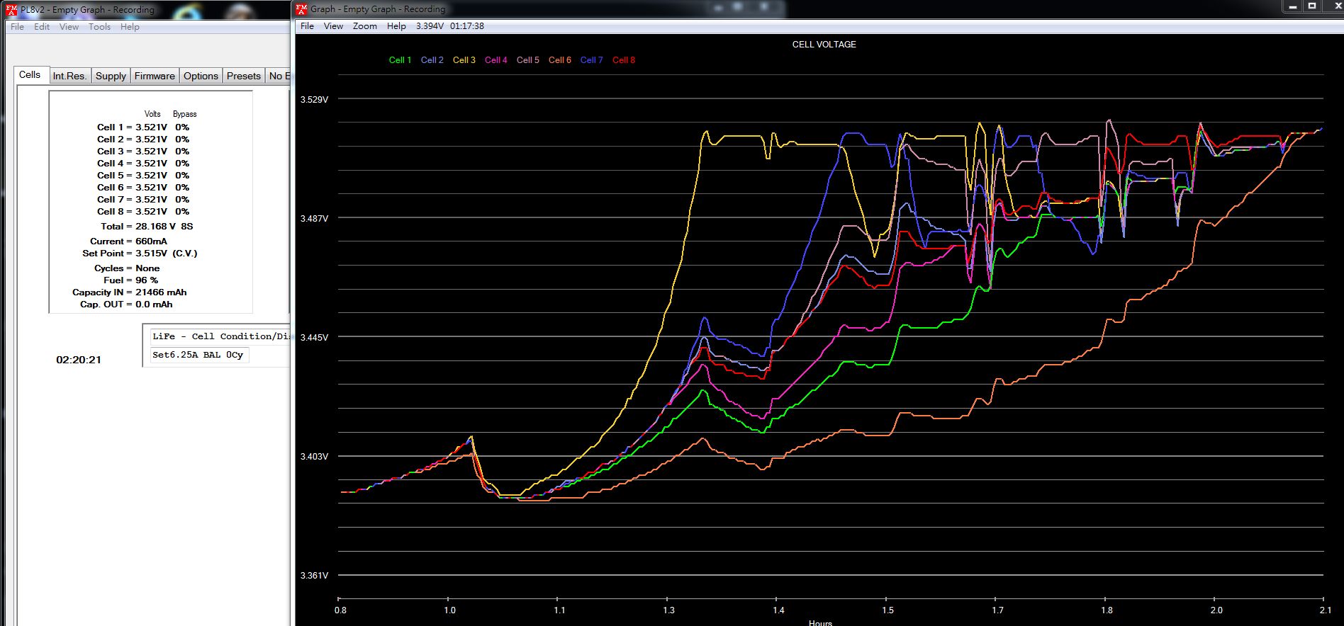

Those extra pouch cells just gave me the most messy balance ever . banghead butred

Postby Scooterman » 10 Jun 2019, 18:55
Ooh that's a bit wiggly Shirley czy .
Why only charge to 3.5v?
Is it not 4.2v for all non-lifepo4 lithium cells? :problem:

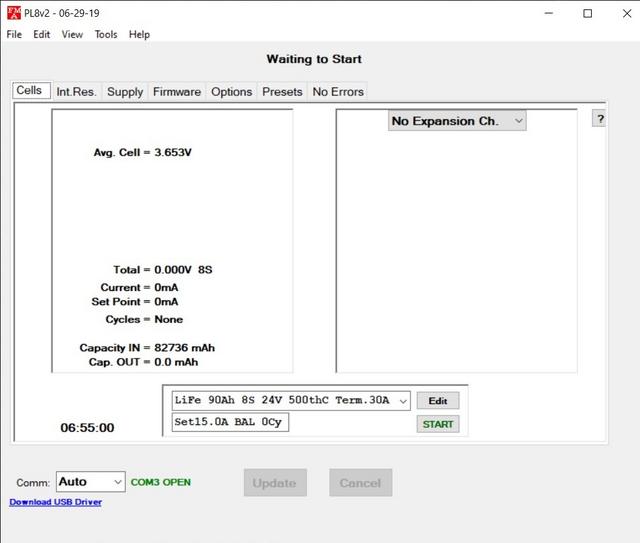

Postby Gnomatic » 29 Jun 2019, 15:56
When I charge I have my CV set to 3.55v ...
But when the charge is complete, the PL8 says the average cell is 3.653v ...
This is typical in my experience, but why?
Postby Burgerman » 29 Jun 2019, 16:37
Because it hasnt measured anything yet. Its waiting to start. Should read ------ instead.
Choose monitor. Or charge. Or discharge. And it will guess at an average voltage. Based on many things. But you can read the actual cell voltages instead.
Postby Gnomatic » 29 Jun 2019, 22:02
That's the CCS screenshot right after I disconnected the charger in the morning.
Postby Burgerman » 29 Jun 2019, 22:20
Yes, but it says "waiting to start" so its ended everything. Including monitoring volts. That reading isnt your battery. Its just some random voltage on the floating line somewhere inside the charger. It really should read blank. But I didnt write the software...
As soon as you choose monitor, charge, or discharge, and click start it will correctly read battery volts.
Postby snaker » 30 Jun 2019, 01:26
When charging is finished, the button is "STOP" and the software still monitors and displays the cells and pack voltages. If you click on that STOP button, it will become "START" and the software stops monitoring. It should clear all info in this case. That 3.65V is meaningless, maybe a random value or a software's bug. PL8 software was not well designed, it seems written by an unskilled student.

Gnomatic wrote:That's the CCS screenshot right after I disconnected the charger in the morning.
Once the charge is complete, the charger monitors the cells and cell voltages drop very slowly until the STOP button is clicked. Maybe a bad/dirty connection somewhere Gnomatic?
Postby Gnomatic » 30 Jun 2019, 16:05
