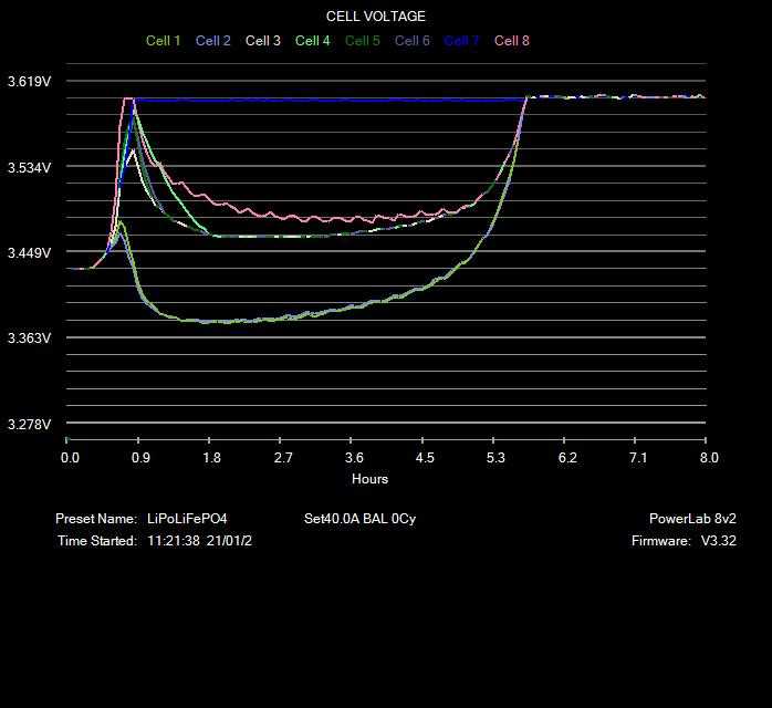

Postby steves1977uk » 22 Jan 2015, 20:19
Here's my charge graph from yesterday.......
Notice how it starts to balance and then go out of whack.... Would this be because of using thin wires on the balancing connector?
I use a metre cable from the charger to the OBDII male plug, then about 75cm from the female side to the battery pack.
Postby Burgerman » 23 Jan 2015, 03:08
You are using a LiPo preset? Use a high power A123 one. For now.
Well thin wires doesn't help, I use the same connector but heavier cables. but if this is less than a week from the last charge you have other problems.
Maybe a bad cell, or more likely a loose connection ot bolt or 3...
They shouldn't take more than a few mins to balance. It goes out of wack because it has to throttle back charge to stop the full ones going too high. Something a BMS just mostly ignores! Its supposed to do that.
Do a full balance but set it to do this:
Balance for full charge: Choose NO. It will then only balance right at the end and you will see balance at CV in grey.
Choose 100mA (NOT C5, C10, C20 ETC) for termination current. It will take longer, at least the first time or two. But allow it to end if possible. This will properly balance the cells and complete the charge probably for the first time...
Choose CV to continue indefinitely. No time limit.
Then send me your pre-set. Save it on your desktop and email it to Burgerman@ntlworld.com. So I can see what you have set up.
Then do a full charge. Drive it a few miles, then try charging it again... Lets see what it does. Should be fast. At least closely in balance. I haven't tried this charger on lithium ion phosphates yet. But that should work and properly charge them.

Postby steves1977uk » 23 Jan 2015, 13:05
Hi BM,
I charge my lithium chair every 7 days at least, and it's always done the charge like this. I don't go out much in winter due to it causing pain in my left leg (ugh!)
My local engineer was going to re-do the wiring on the pack with 12-core trailer cable which will have heavier wires. Will have him check the bolts too.
Thanks for your help and time BM,
Postby Burgerman » 23 Jan 2015, 13:10
It shouldn't always do that. Maybe after a month left uncharged it will.
You have a bad cell or two, unlikely.
You have a bolt or half a dozen loose. Use CAP SCREWS and test every one twice. A lot of bolts, easy to miss a couple.
You have never had a full proper balanced charge? Cant know without seeing your settings file.
Wires being thin might not help.
