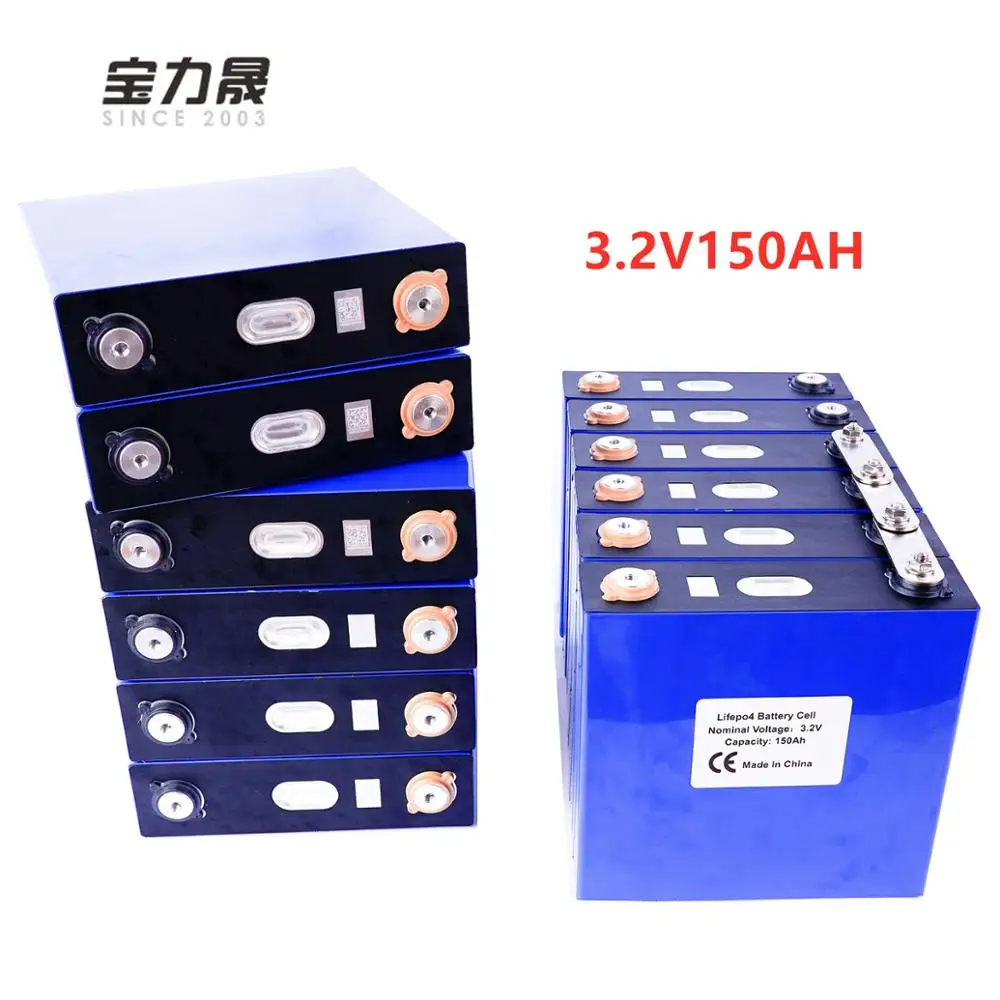

Postby Scooterman » 16 Oct 2019, 19:39
https://www.aliexpress.com/item/4000224 ... 0224208689 + ultra lightweight chair and rider = :dirtbike
and 8 cells so less :hammer
Postby Burgerman » 16 Oct 2019, 20:09
But those are a difficult size that does not fill the battery compartment? They are lower, mostly.
Posts: 70467
Postby Scooterman » 16 Oct 2019, 20:22
Burgerman wrote:But those are a difficult size that does not fill the battery compartment? They are lower, mostly.
Oh :(
