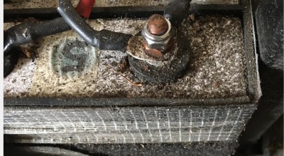

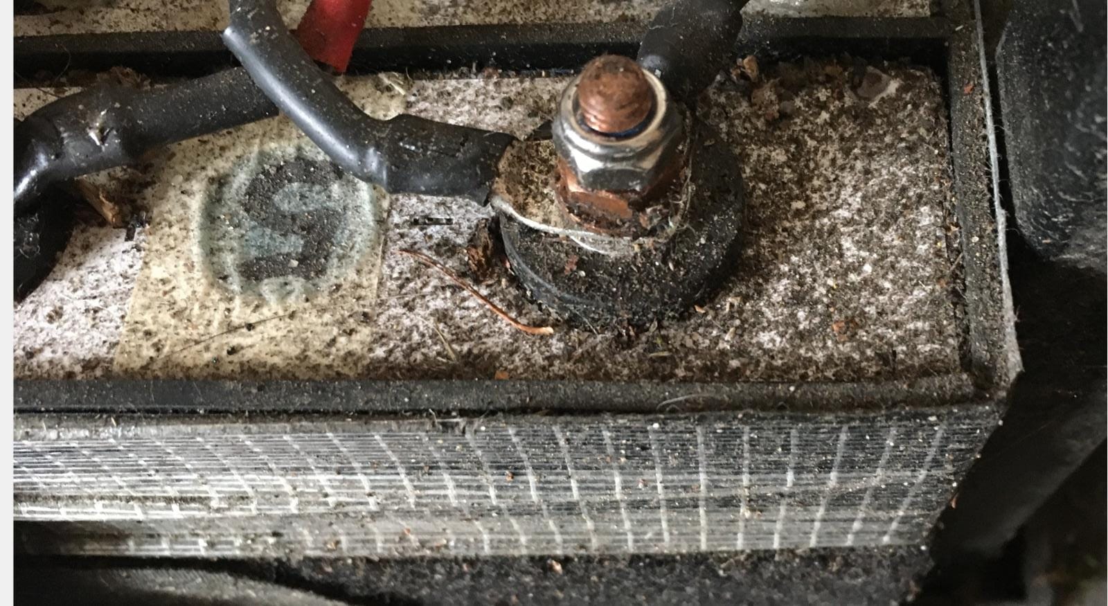

Postby Scooterman » 20 Nov 2019, 07:47
I dismantled the 180Ah mob scooter lithium pack yesterday and have ditched the horrible stiff pvc 6mm links and m6 copper studs. When I built the pack in hurry back in the spring I put a dab of superglue on the end of each stud and was nervous I wouldn't get them out. But 85% came out with no effort, the remaining were a bit tighter but came out okay with a squirt of freeze spray and penetrating oil.
I will be replacing with silicone, stainless - studs, washers, and nylocs.
Expresso's 200A build gave me the idea that I should be able to use 12 awg for the inter-cell connections? As I will do the series links in parallel again like I did last time and 12 awg is easier to bend
It's a only a single channel controller 120A max, so max current going through each 12 awg cable is only 60A. And previously I have worked out that 10mph speed on the flat mob scooter draws about 20A.
The pack/s have only been in for about 6-9 months and they're filthy, I'll need to do something about that :problem: .
Trouble is the rear bodywork is one piece which doubles up as battery cover and rear wheel arches. And all the road spray and road crud from the rear wheels get flung up inside the bodywork.
Any suggestions? I was thinking perhaps think polythene over the cells once everything is wired up? I'm in no rush to rebuild the pack as I won't be using the mob scooter again until the spring.
Posts: 2892

Postby shirley_hkg » 20 Nov 2019, 09:34
That's really filthy !
I'm more concerned with the filthy water that came with. It needs shelter.
Posts: 4482
Postby Scooterman » 20 Nov 2019, 09:57
:lol:
Oh yes I didn’t think of that Shirley :oops:
I wonder where it went? Are the cells waterproof? :shifty:
PS: and all that crud was just the UK summer weather, not winter.
Posts: 2892
Postby Scooterman » 20 Nov 2019, 11:11
I just had the idea that I could spray a load of your expanding foam over the cells shirley. Good idea/Bad idea? :lol:
Posts: 2892
Postby shirley_hkg » 20 Nov 2019, 13:11
I'd say NO.
Simply a thick plastic bag will do. Cut to appropriate size. Hang the sides down and tie it up.
Just let water flow down and drain away.
Posts: 4482

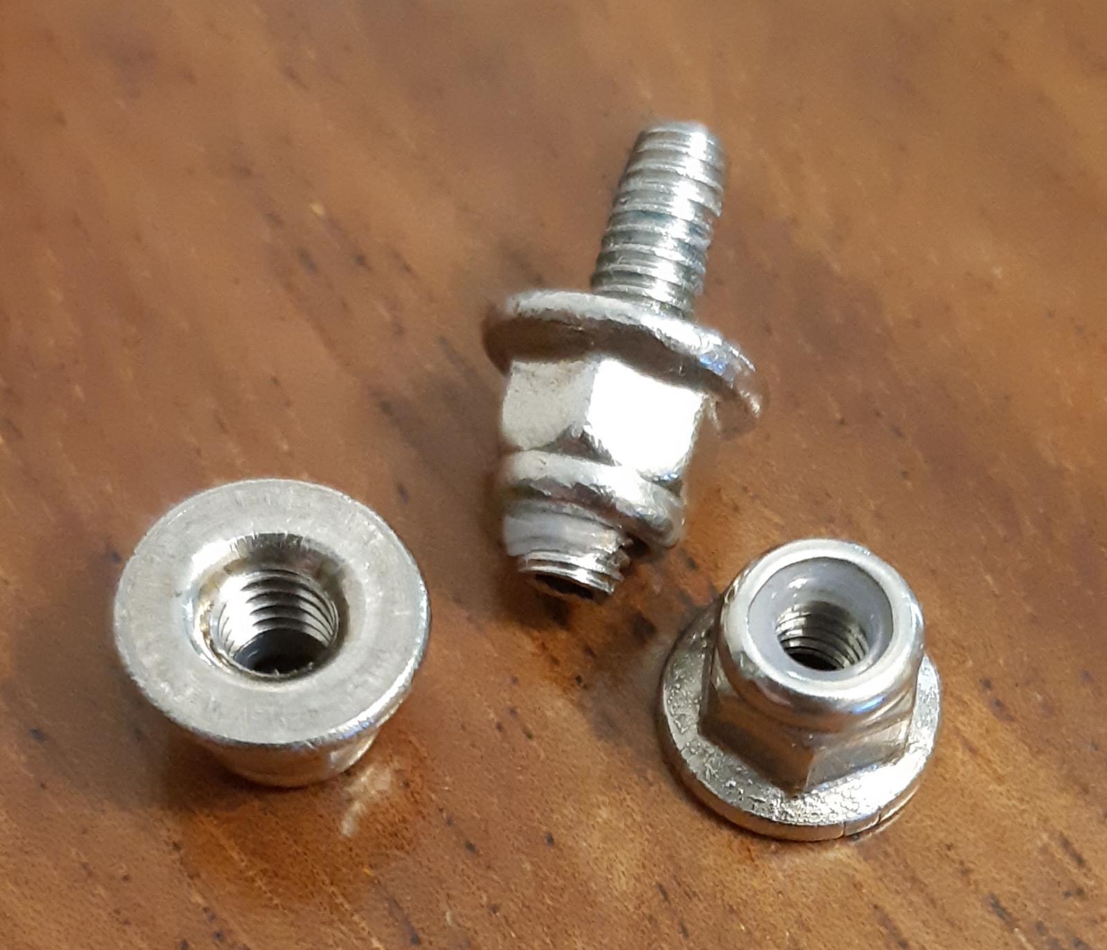

Postby shirley_hkg » 20 Nov 2019, 13:36
I like this SS M4 flange lock nut.
Large contact ,
Plain base ,
Thick means more threads .
Will grease it for perfection . :wave: :clap

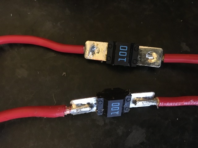

Postby Scooterman » 25 Nov 2019, 14:44
Do these go open circuit at 100A then reset when current drops below? Or does it reset when internal temp drops below certain value?
I’ve never come across them before.
Posts: 2892
Postby Burgerman » 25 Nov 2019, 15:02
No they go bang and thats it!
Posts: 69908
Postby Irving » 25 Nov 2019, 15:17
Scooterman wrote:Do these go open circuit at 100A then reset when current drops below? Or does it reset when internal temp drops below certain value?
You're thinking of polyfuses. Sadly they don't come in 100A+ sizes (AFAIK).
Postby Scooterman » 25 Nov 2019, 15:52
Burgerman wrote:No they go bang and thats it!
Oh do they, that's not very good is it. Not easy to change when out in the field :thumbdown:
Thank you that's interesting. :thumbup:
