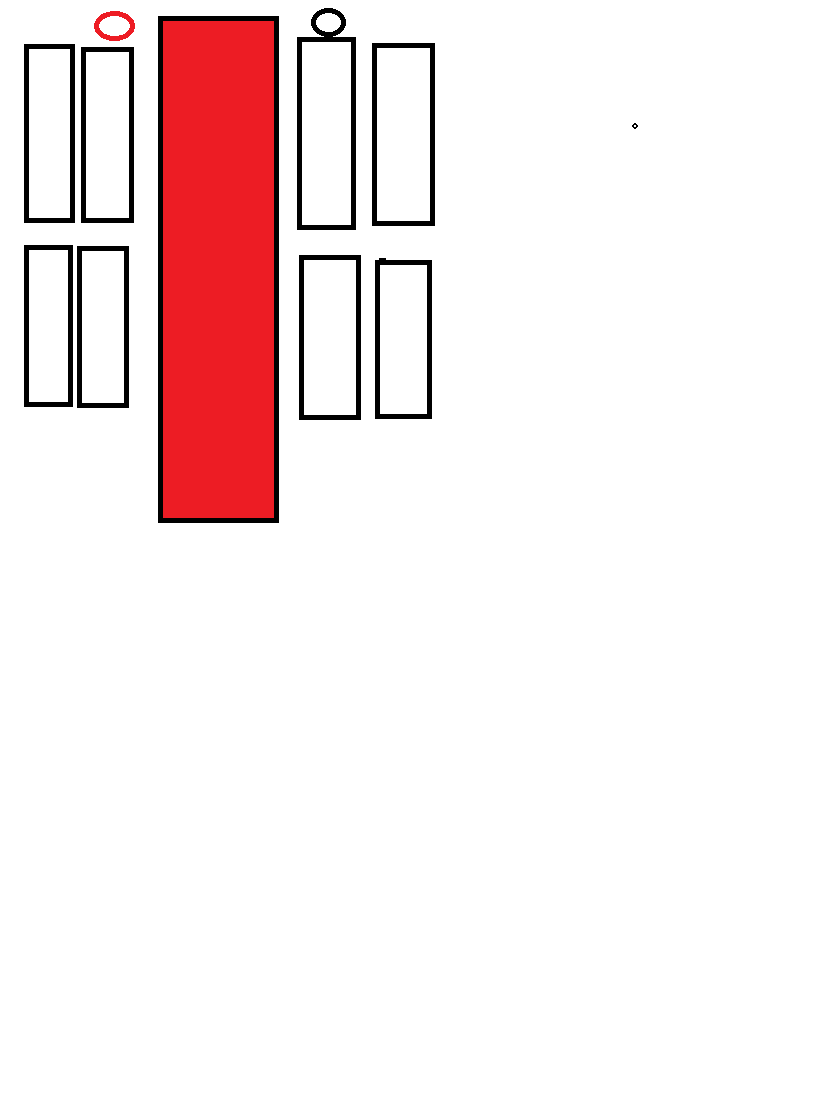

I will have to change the layout of the cells.
It's because the R-Net is placed down the centre of the battery bay. So I need to put the cells like in pic below.
Can it be done? Thanks in advance

terry2 wrote:I will have to change the layout of the cells.
Yes, you wire in series + to - on each side and then one wire + to - across between the two sets of 4, leaving a free + on one side and a free - on the other.

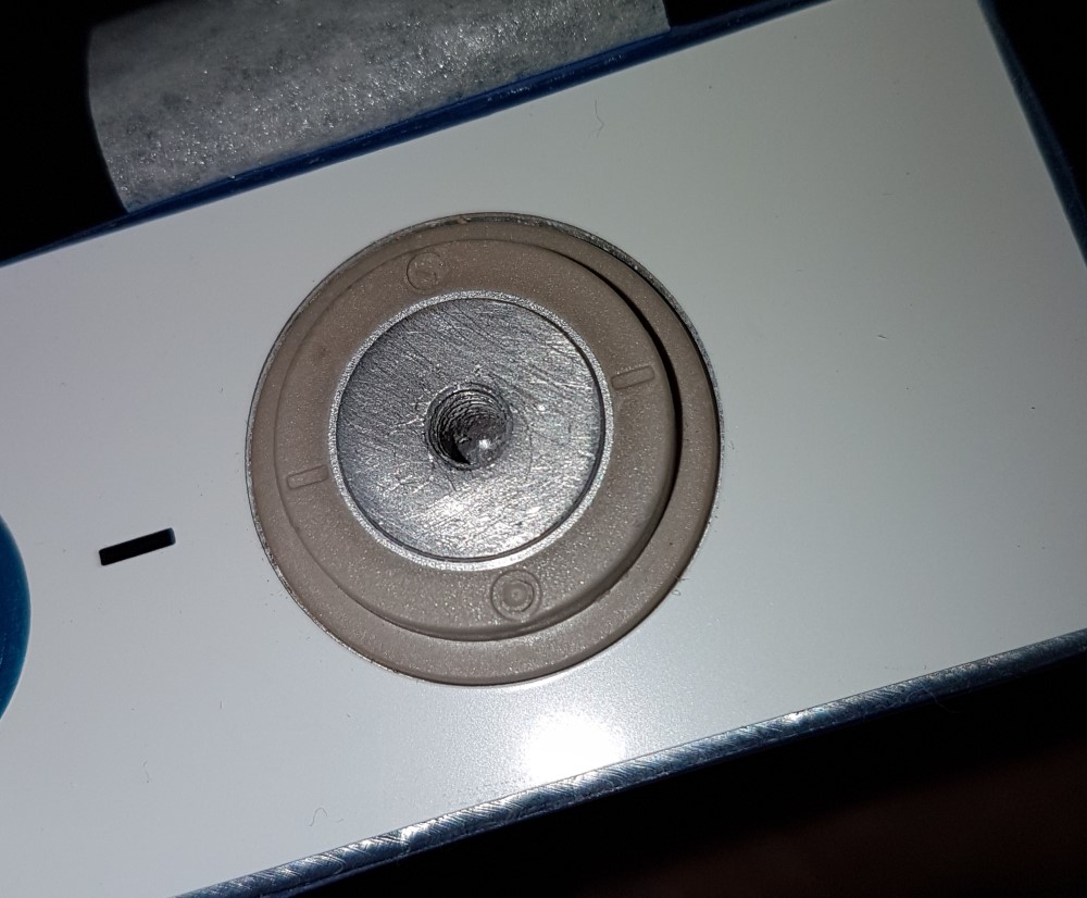

Received 16x015aH cells from BTS yesterday, it caught me on the hop as I haddn't been expecting them yet, I ordered them on 04 Jan so exactly a month to deliver.
I've performed a visual inspection and checked voltages, all ok except for one where the negative terminal looks like this :-
So I'll have to open a dispute with them about it as it doesn't look right! To me it's either an old cell or maybe it's a new cell but it's been subjected to arching?

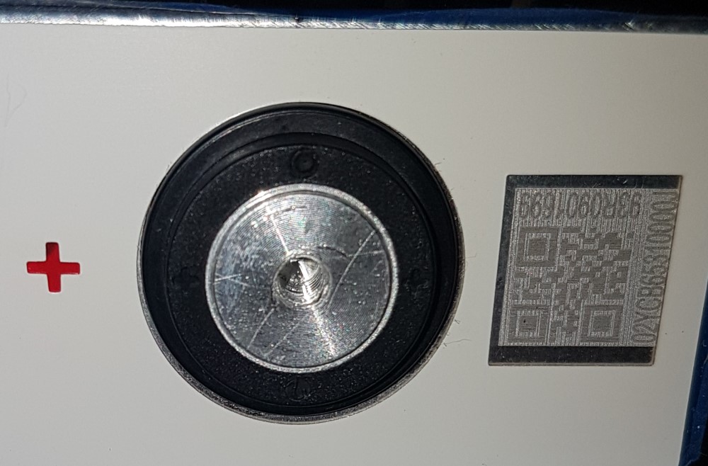

Here's the positive terminal of the same cell for comparison.

Postby Burgerman » 05 Feb 2020, 12:33
Yep, used, burned and filed or sandpapered. Where are they from? I would capacity test one. If not all.
Fully charged and then discharged at 20C to 2.9V you should get 95% of what was claimed. And 100% +/- 2 or 3 % at 2.5V but I wouldnt go there if they were mine. They buy them untapped. And do it badly themselves in some cases. Use stainless studs, and red loctite.

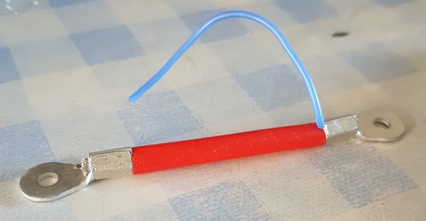

Postby stevelawiw » 05 Feb 2020, 16:48
I'm using 8awg. Don't know what others think?
The 24awg blue wire is for my balance wire and I'm yet to solder and add some shrink tube on each terminal.

Postby Burgerman » 05 Feb 2020, 17:40
Yes. Or use a seperate terminal gor the balance connection loom. Or things will get complicated.

Postby steves1977uk » 06 Feb 2020, 13:07
I used seperate terminals for the balancing wires on my build. Makes it easier to diagnose any issues if they arise. :thumbup:

Postby foghornleghorn » 06 Feb 2020, 18:04
steves1977uk wrote:I used separate terminals for the balancing wires on my build.
Same here. More likely to get a good connection with the correct size crimps for the different wire gauges.
