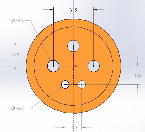

Seajays wrote:Woody, The best I can do is the Spring pins a 25 mm x 0.053. The holes are 4 mm OC apart and 8 mm up from the centre of the bottom pin. The spring end sticks out 9 mm Very hard to get an more accurate measure. The spring end of the pin is a smaller diameter so there is some play there. I used a 0.051 drill and some Crazy Glue. Hope I can get the cable stuff mastered. Might be back to you with some questions.
Hi Seajays,
I made a model see if the size match?

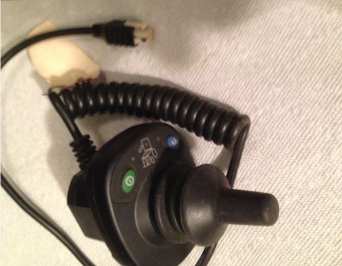

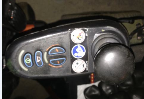

My chair is Q6 EDGE, and used the joystick and attendance joystick as the pictures attached. Sorry I don't even know what control system is used, can you help me to figure out it based on the joysticks?
Best

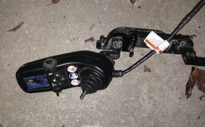

3. for now, may I use a Q6 wheelchair for the Q6 edge? Q6 joystick as pictures attached.
Best
Adam

You cannot mix and match joysticks or controllers from different manufacturers or types from the same manufacturer.
enAble® 40 , enAble® 50 or Q-logic made by Curtis and used Pride and Ottobock.
Q-logic 3 made by Curtis used by Pride.
Pilot+,VR2,Vsi and R-net are made by Penny and Giles now owned by Curtiss-Wright .http://www.cw-industrialgroup.com/About ... ology.aspx
DX , DX2 Shark and LiNX made by Dynamic . https://dynamiccontrols.com/en/
The above are the main wheelchair control manufacturers.... but there are others.

Hi woodygb thank you.
I bought a used wheelchair and separated it and used the motors and Q-logic, but now the joystick stayed at the STOP LIGHT red on.
All things I do is try to remove the red light. or I have to change another one.
I was trying to do program, also for remove the red light even I don't how to do yet.
Do you have this experience?
