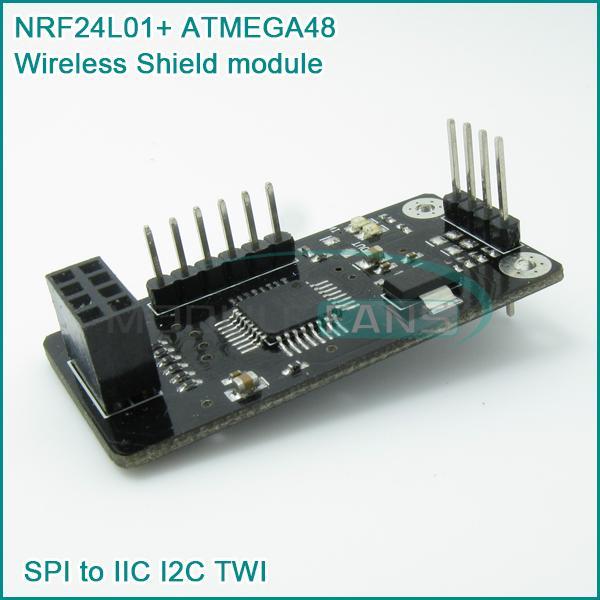

Postby gcebiker » 12 Aug 2015, 09:05
A work in progress..
I know ill need a different .h library as the current one has no Joystick button implemented to save coding space but i would like to use it as the on/off button.
Code for Wii Remote I2C data (can also be used for wired Wii Joystick)
Analog Output for DougL Jazzy (forget the model)
New Arduino boards in the mail from AliExpress...maybe can do away with two Arduinos on receiver end... /fingers crossed.
Maybe ill also be able to use the NRF2401+ on both ends to get better range, even if i have to bust open the nunchuck case and stuff it inside... .
http://www.aliexpress.com/store/product ... 78020.html

Bugger, seems like that's just a shield for the RF24, i thought it was stand alone arduino board...no wonder i could not find any Analog or Digital in/outs.../doh
Silly me. :oops:
