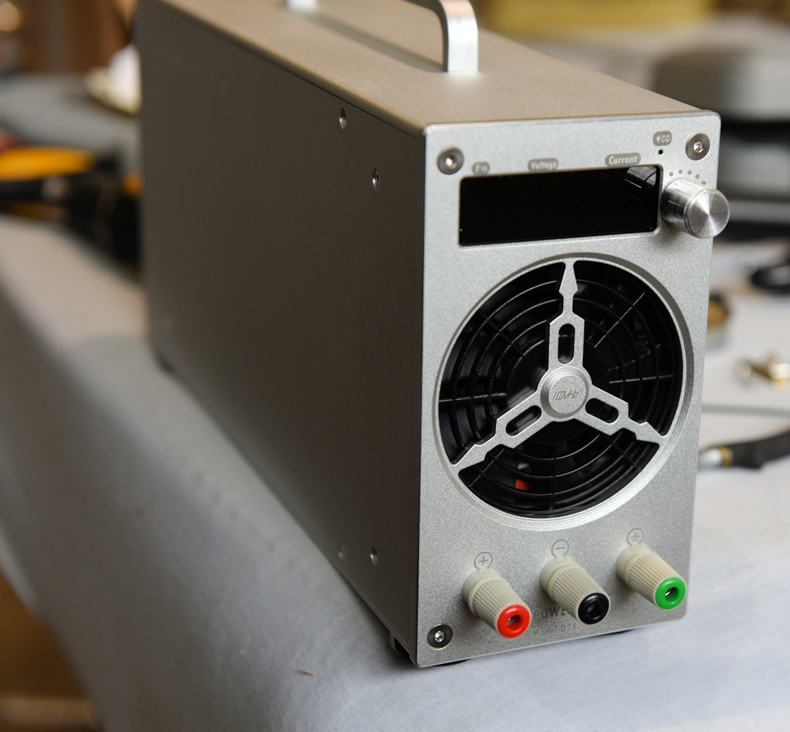

Postby shirley_hkg » 23 May 2018, 02:07
Never thought of using it this way ! Brilliant !. :dance cheers drunk2
Postby Burgerman » 23 May 2018, 02:09
Instruction turned from shirley english to my english so I dont get a headache! :shh:
INSTRUCTION, MENU, OPERATION
It has quite some useful features apart from just a 0-60V / 0-50A CC/CV power supply.

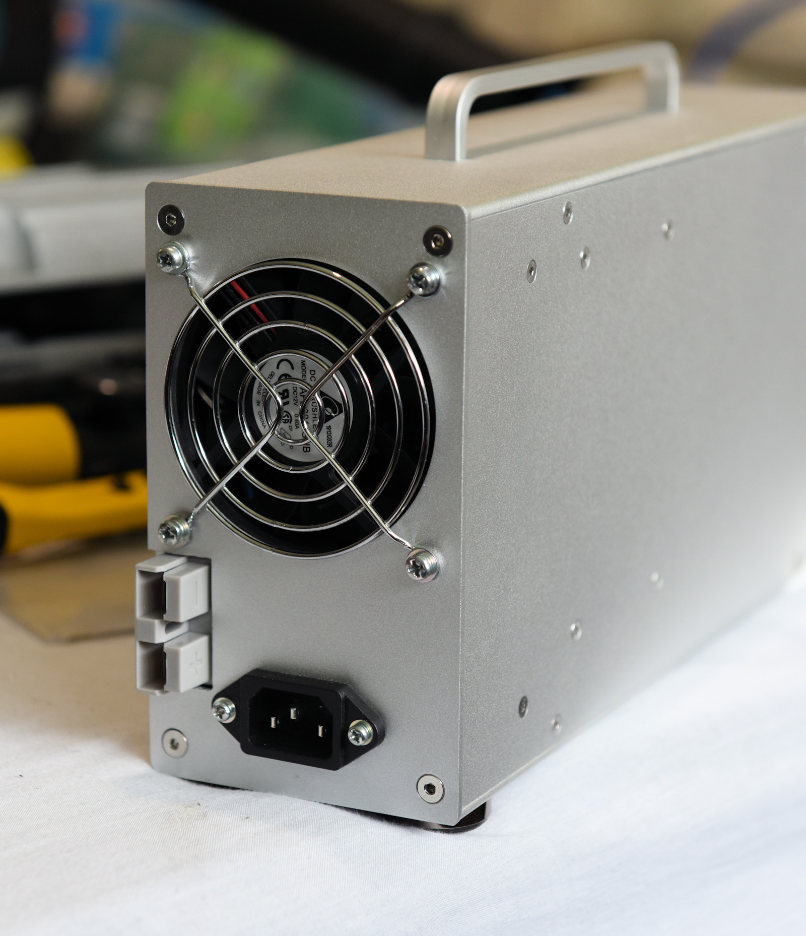

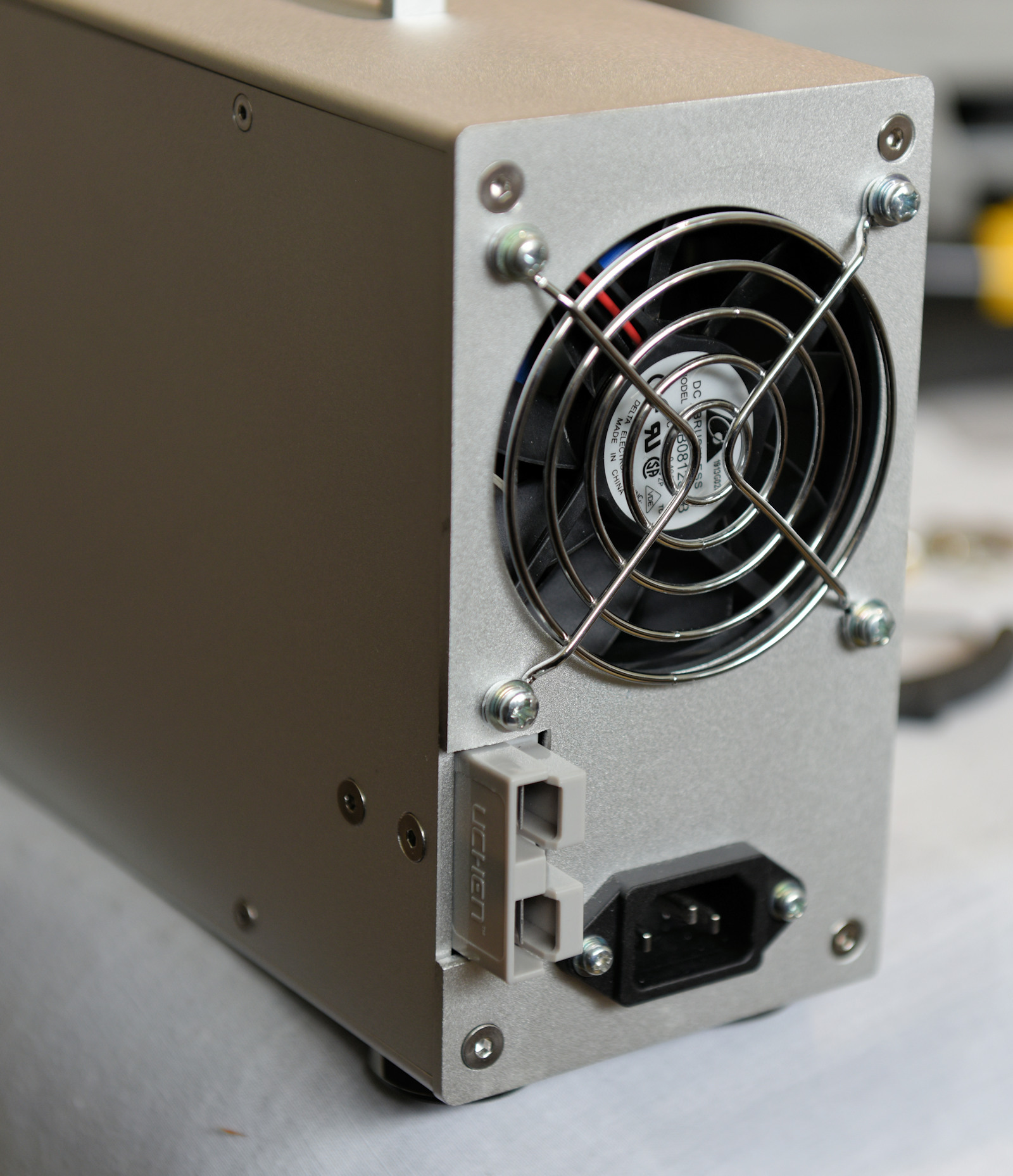

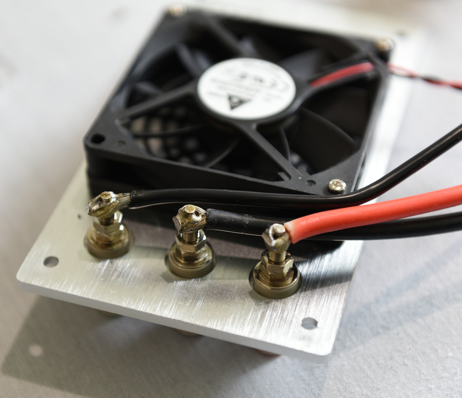

Well I now have heavy wiring, and an Anderson on the rear...
And a fan grill that lets some air flow through! The stock one all but stops air flow. So fans are reving, supply gets too warm. This one is adequate for fingers, but flows some air.
Posts: 70440

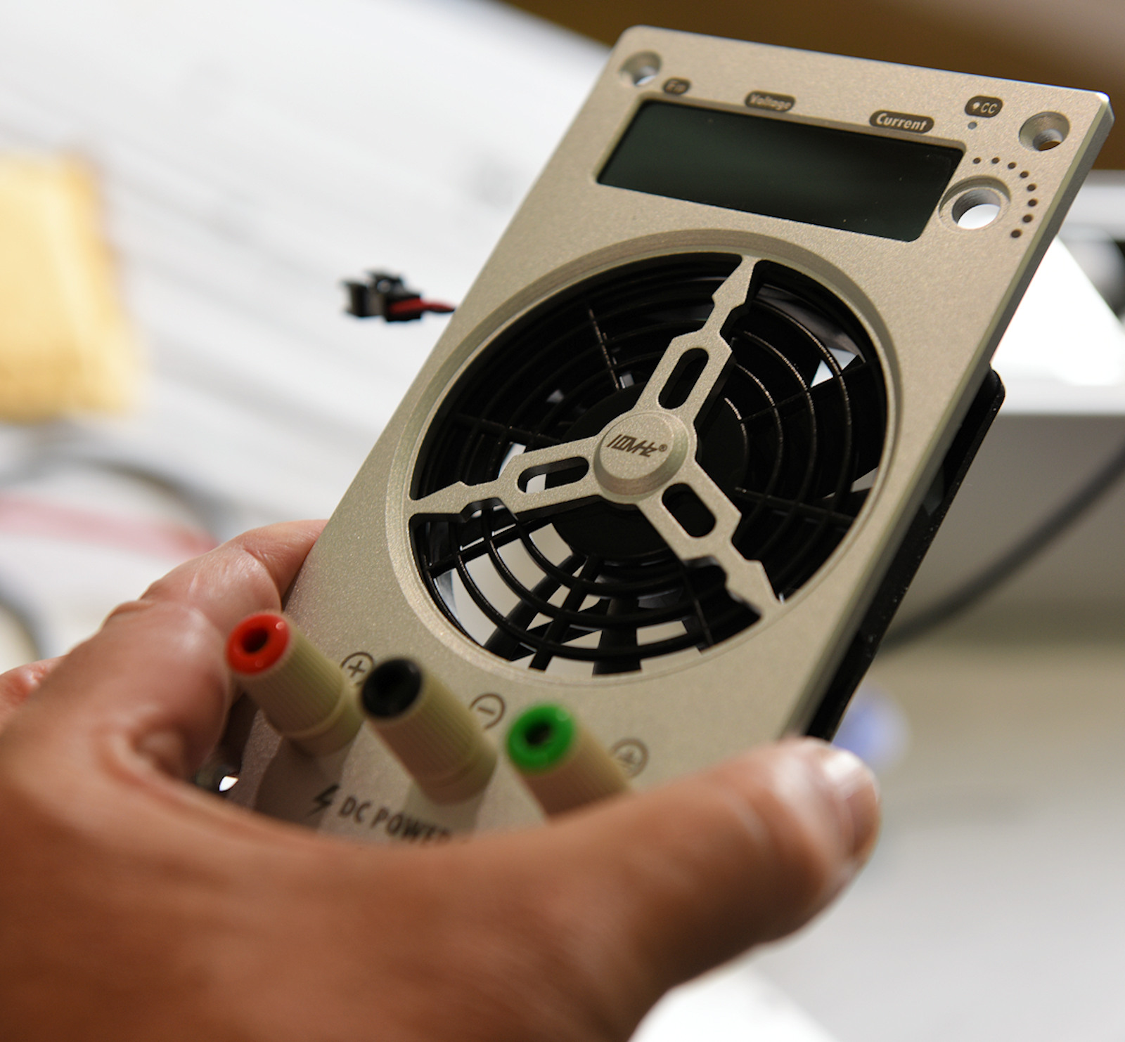

Postby Burgerman » 23 May 2018, 17:59
Looks easy no? You should see my room. Its a war zzone, and now I am running over most of my tools, screws, cables, and worse. And my bed is full of metal from the disk cutter, why does everything need to use so many tools and materials :fencing
Posts: 70440
Postby Burgerman » 23 May 2018, 18:05
Edges of the cut out need tidying up with a file, and I have a lost fan screw, and a lost case screw! :argument
Those will be on the floor too. Along with a full set of 52 drill bits that are no longer in the case. All over! And I am driving in flux. :cussing
Evcerything you do from a wheelchair is an ordeal and a pain is the but. Of course the 11 anderson connector I needed in out of reach. The only tools on the flloor are the very ones I need. The grabber is in the same place and I ran over it all day.
Posts: 70440

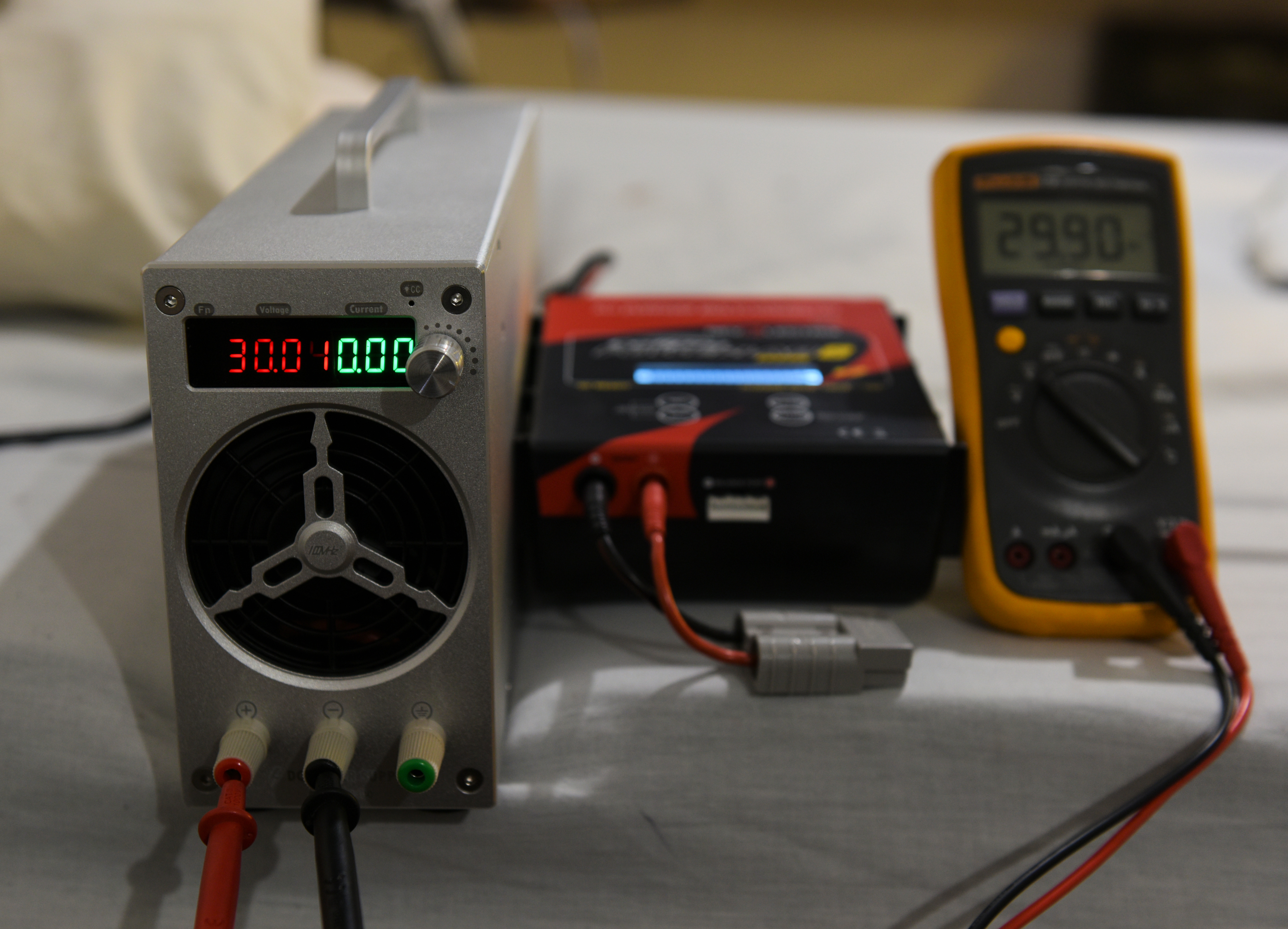

Postby steves1977uk » 24 May 2018, 10:29
Nice work BM! My PL8 shows 29.35v unloaded when the PSU is set to 30v. Does my PSU need calibrating?
Postby Burgerman » 24 May 2018, 11:30
You could, but many voltmeters are not actually very accurate. Most are. But you need to know. So if you bother to go to the trouble then borrow a calibrated high end agilent, fluke or similar. Or use one to check your meter against. Those are accurate to under 2 mV.
Or get a cheap ebay chinese calibration tool: https://www.ebay.com/itm/AD584-High-Pre ... Sw5cNYfwo- reference. Turns out those are very accurate too. I have one and its spot on according to my calibrated fluke 289. To about 4 decimal places or better. I also calibrated my smaller cheaper fluke meter, and my other bench supplies the same way. I will do the shirley new one today. But its close anyway.
But unless you are using it for regular electronics stuff, or charging lithium directly, without a charger where accuracy is important, dont worry. Its close enough. For power supply use even the nearest volt is close enough.
IF you have a quality accurate voltmeter, and you know its accurate, then do it. Why not? Be sure your room is at a normal 20C, turn on volt meter, and power supply for 30 mins to stabilise before setting it or it may be wrong!
Posts: 70440
Postby shirley_hkg » 24 May 2018, 12:06
steves1977uk wrote:Nice work BM! My PL8 shows 29.35v unloaded when the PSU is set to 30v. Does my PSU need calibrating?
You got volt drop , whenever there were current flow , though its small as 0.2A .
PL8 isn't that accurate after all.
Postby Burgerman » 24 May 2018, 12:12
I may add that its almost spot on at 60V to 0.02V,
0.11V low at 30V as shown,
Perfect at 5V (to 4 decimals!)
and not very accurate at all below about 3...
Now, after calibrating today if I bother, it may be perfect at the set voltages, which may make it perfect everywhere. Or likely it may not!
And how accurate it will be under actual load, or under various frequencies we use, is another matter altogether!
My fancy 289 fluke can meaure all of this, inc peaks at its 100k frequency, or the 3 load frequencies of the pl8v2.
In other words, knowing the unloaded DC average voltage alone doesent tell us much.
Posts: 70440
Postby Burgerman » 24 May 2018, 12:27
Within 8mV worst case. 3mv balance. And mine are at least that accurate. And tracable by nist apparently. And yes only unloaded voltages can ever be accurate. Cables/connectors have resistance.
Posts: 70440

Fans.
If you add the stock black perforated sheet as intended, it reduses airflow by more than double. Or is that half? :cussing It also makes the fans run faster. Instantly since they cant get any air. But airflow is very restricted. It does quieten the thing though. Till it gets hotter!
It actually has more airflow with front fan stopped, and only the rear fan running without that dust filter. So... I have fitted my new free flow one, and added a resistor (speed reducing plug in one for a pc) to each fan. Now its quieter and has better air flow. Just in case you are sleeping next to it.
Posts: 70440
