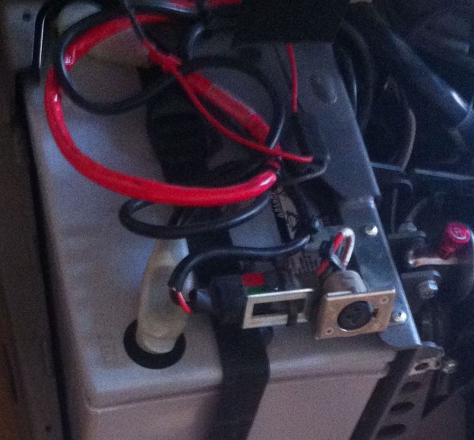

My Permobil C500 has two XLR receptacles, one under the joystick, and one on the side of the chair. Is the 12A limit for charging with the XLR more for the typical plug that goes in the controller?
The one on the side of the chair is much closer to the batteries and has more substantial cables. Right now, when I'm charging at 12A with the PL8, the XLR plug and cable do not seem to get warm at all. Could I potentially charge at 15A or higher? Or is it the actual XLR internal connection that is the limit?
Here's what the side plug looks like with the cover off.

Postby Burgerman » 23 Dec 2018, 15:04
You may get away with 15 on that. Although the tech limit on those connectors is 12A.
You wont do much harm trying that on that connector alone. Dont do it via a joystick pod.

Postby shirley_hkg » 24 Dec 2018, 00:44
jefferso wrote:The one on the side of the chair is much closer to the batteries and has more substantial cables. Right now, when I'm charging at 12A with the PL8, the XLR plug and cable do not seem to get warm at all.
It's the contact between pins that matters , not the wires yet .
15A ? My experience said NO

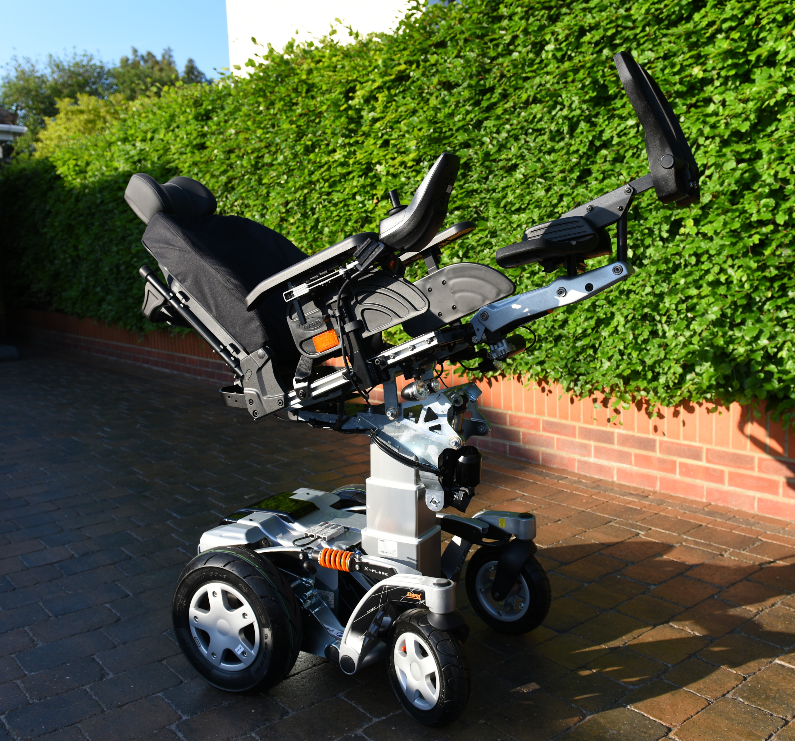

I plug mine into my van from the driving position too, so when I start my van I have THREE batteries doing the job. 2 on the chair, 1 where it normally lives on the van. Even if its dead, it still starts. Then I start motor, and the vans 100A alternator charges all 3 batteries at 14.4V as I drive. The lowest battery charges the fastest. After around half an hour driving all are quite well charged and are at CV. And you are now safe to drive for 8 hours non stop. Current drops away naturally as they charge.
CABLE with 12V PARALLEL adapter to charge from, or start the van!
CHARGING AT 49A as I drive here:
CHAIR CABLES, ALL SOLDERED:
FITTING
VAN INSIDE CONNECTOR IN DASHBOARD. Allows direct charging lead. Or lithium charging via PL8. Or van starting!
ANOTHER EXTERNAL CONNECTOR (so I can charge a chair in the sun, connect my PL8 to charge a quad-copter or plane, or another chair. Or so I can start the van, or lower the ramp to enter if battery is flat... Or to plug in an inverter to power 240V stuff like vacuum cleaner/polisher or an over winter float charger.)
DETAILS: http://www.wheelchairdriver.com/faster- ... arging.htm
Posts: 70132
Re: Power Supply for PowerLab8 v2
Postby Burgerman » 01 Jan 2019, 13:25

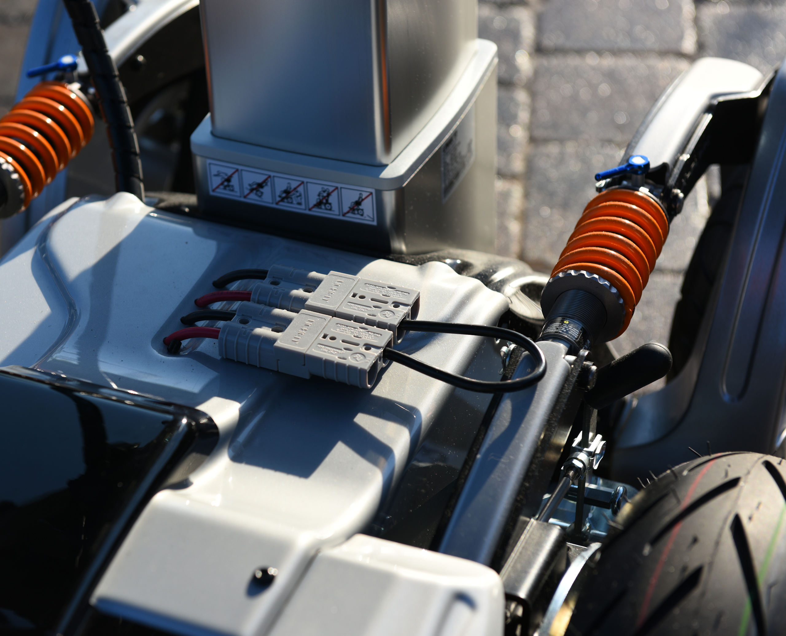

ALL my chairs, have the same setup.
Here, 12 / 24V setup installed on my Storm 4 chair with the drive loop plugged in.
That loop is also useful when storing the chair as once removed, the battery is totally disconnected from the chairs control system. So can be stored 3 to 4 months without charging if already 100% full.
Want some power while in a chair? 2KW mains AC 240V available here from your chair or van.

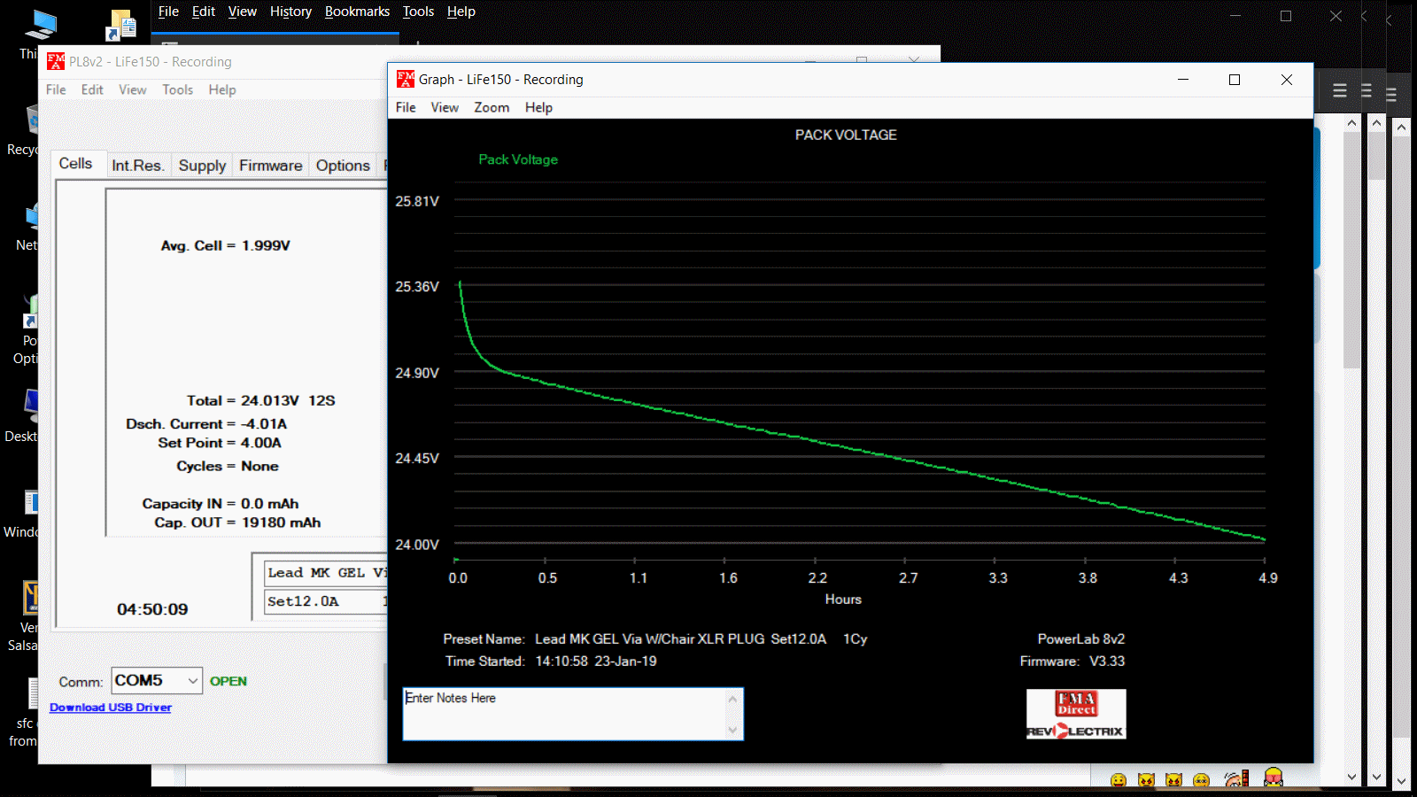

Of course. Discharging a set of MK Gel 73.4Ah GRP24 batteries here to determine the ACCURATE CONDITION.
The PL8 graphs and records it as you charge or discharge. Amps and Volts and time. And capacity taken out or returned. And lots of other things.
For e.g. This screenshot shows that the MK batteries are in series, and have been discharging for a little under 5 hours.
At 4A continuously. Thats a slow discharge at approx the 18 hour rate. So I would expect to get 71Ah out when it hits 10.2V. As per spec. IF 100% as new.

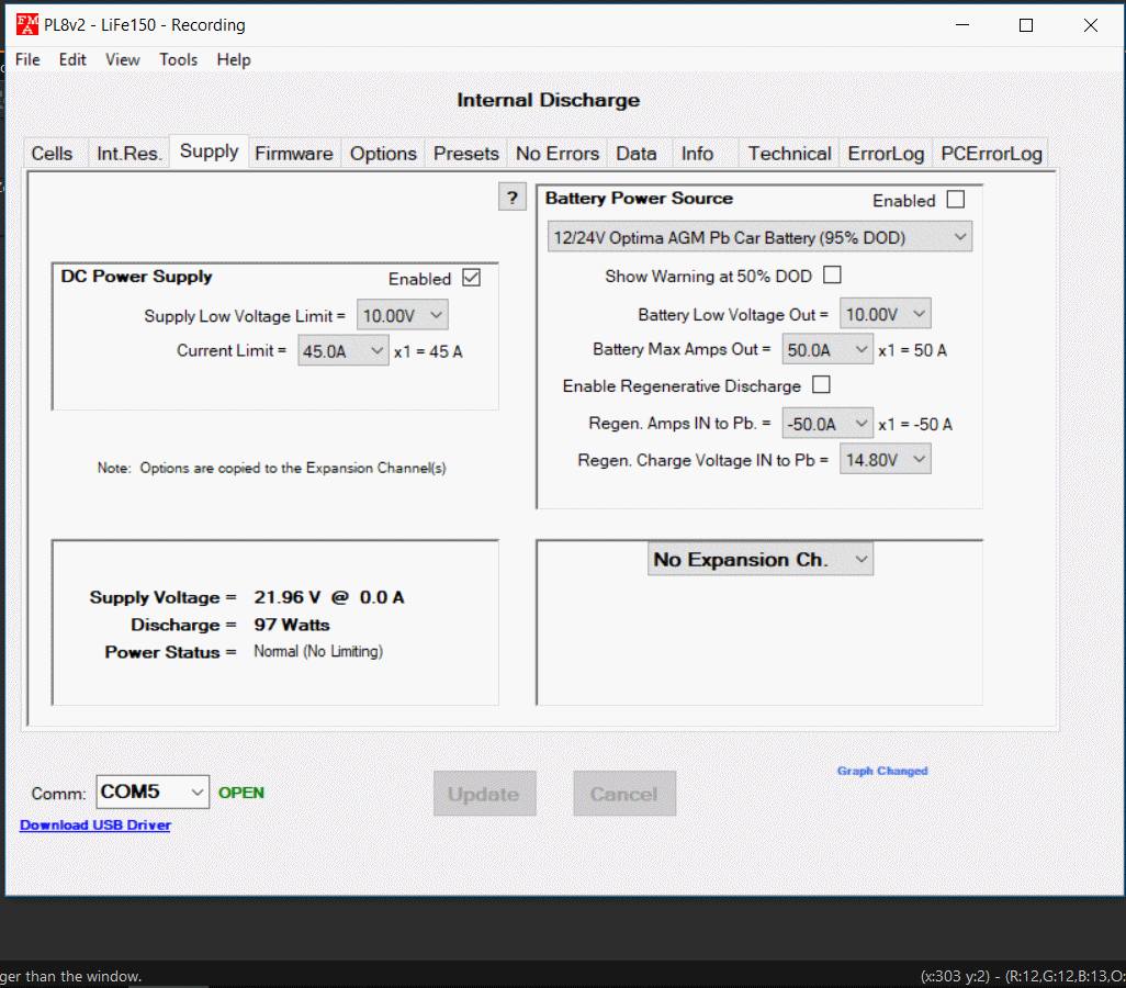

This shows:
The battery has been discharging for 4 hours 50 mins 09 seconds...
That the AVERAGE cell is down to 1.999V
That the pack voltage is 12.01V per battery or 24.01V.
That so far 19,180mAh or 19.18Ah has been removed.
That the target discharge rate is 4.00A
That its actually charging at 4.01A
That the supply voltage is 21.96V
That discharge watts are 96
That supply current is 0.0A (since its discharging)
Then it graphs Volts V time, Amps V time, cell volts, and amps, individually over time for lithium, returned Ah over time, resistance per cell over time, etc. Also graphs loaded and unloaded supply or current over time.
Discharge details during test
Supply volts, amps, watts
Posts: 70132

And one look at this shows why lead batteries are crap. And gel are worse than odyssey.
Its down to 12V where your lights warning light start telling you its dead, after a slow 4A discharge for under 5 hours. Its not actually anywhere near dead, you are seeing the voltage depression caused by loading a gel battery. If I stop discharging it, will rise from its depressed 12v to 12.8V after say 16 hours... And so you get a full set of battery level light back.

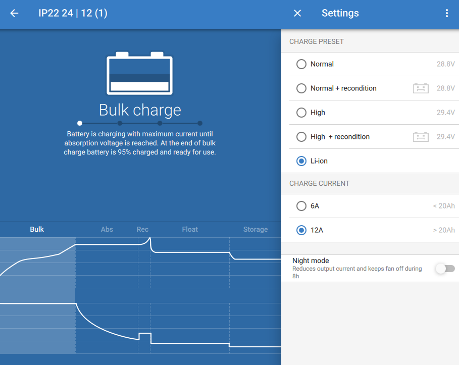

I ordered one of these Victron Energy Blue Smart IP22 Charger 24/12 chargers as a travel charger:
https://www.batterymegastore.co.uk/vict ... 42002.html
It's not cheap, but it's light and small compared to similar 12A chargers and it already has a euro plug if I go to Europe (slight annoyance to take a euro -> UK adapter for travel not in Europe, but not a big deal).
It has screw terminals so had to solder an XLR cable and put the bare ends into the terminals.
It has bluetooth so I can monitor the charge on my phone or laptop with the VictronConnect app.
The only trouble is, it's the wrong voltage for the Lead profile. It's got 28.8 and 29.4 v settings at 6 and 12A. It also has a Li-ion profile which does 28.4v which is closer to the 28.2v I need for the gel batteries. I will try to charge with the Li-ion setting and watch the graph to see what it does.
I might also make another XLR cable with diodes in line to get closer to 28.2 with the lead setting. I guess having the 29.4v option might be helpful if the diodes drop too much for the 28.8v setting.

Set to lithium it will likely only do CC, then some CV and turn off. So the battery willl not be full...
Set to 14.4V it will upset the batteries... So the diode thing may help, but it also drops the float voltage. So you might want to monitor to see what it actualy does.

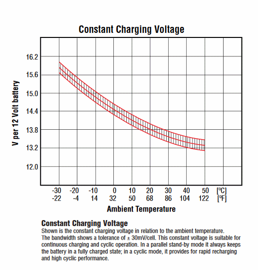

Remember that the 14.1V or 28.2V thing is the highest voltage allowed. At room temp 20C or 68F. In summer temps above 20C where your battery will be a few degrees warmer than ambient after use, and will stay warmer as you charge then thats too high. It actually says that the extremes at room temperature are 13.8 to 14.1V and the ideal voltage is 13.95! Since we only have overnight we choose to be at the top limit. To ensure a full charge with least damage.
Theres a MK chart here: https://www.intercel.eu/media/datasheet ... ochure.pdf
Screenshot of that here:
