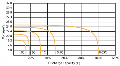

This shows the same thing.
The number of Ah you think you got depends on discharge rate, very very heavily and on the internal battery resistance and on the battery peukert level.
So small battery scooter = disaster!
