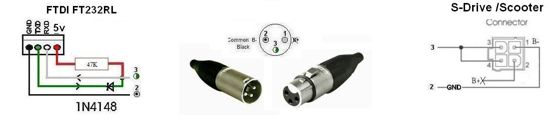

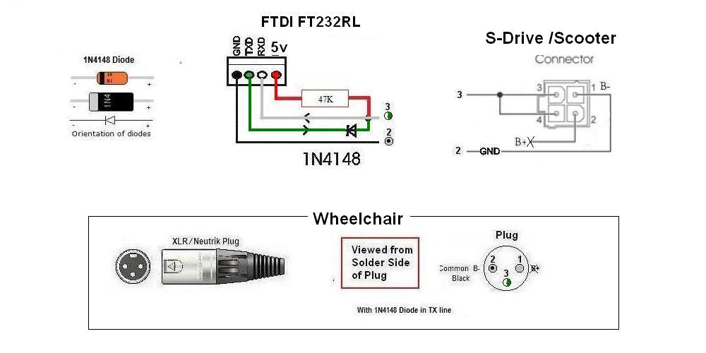

Postby woodygb » 07 Jan 2015, 14:39
This is how I mod the present FTDI chip based cable
1N4148 diode and resistor ... the resistor value that I use is 47k ... I've seen other schemes with 10k ...and the pic shows 3k

The drawing is how I make my leads.... the photo simply shows a wheelchair programming lead with an additional adaptor for the S-drive.
I hope the cable arrives soon.
Postby woodygb » 02 Feb 2015, 10:38
The cable in the photograph is constructed like this.... and is dual purpose.
