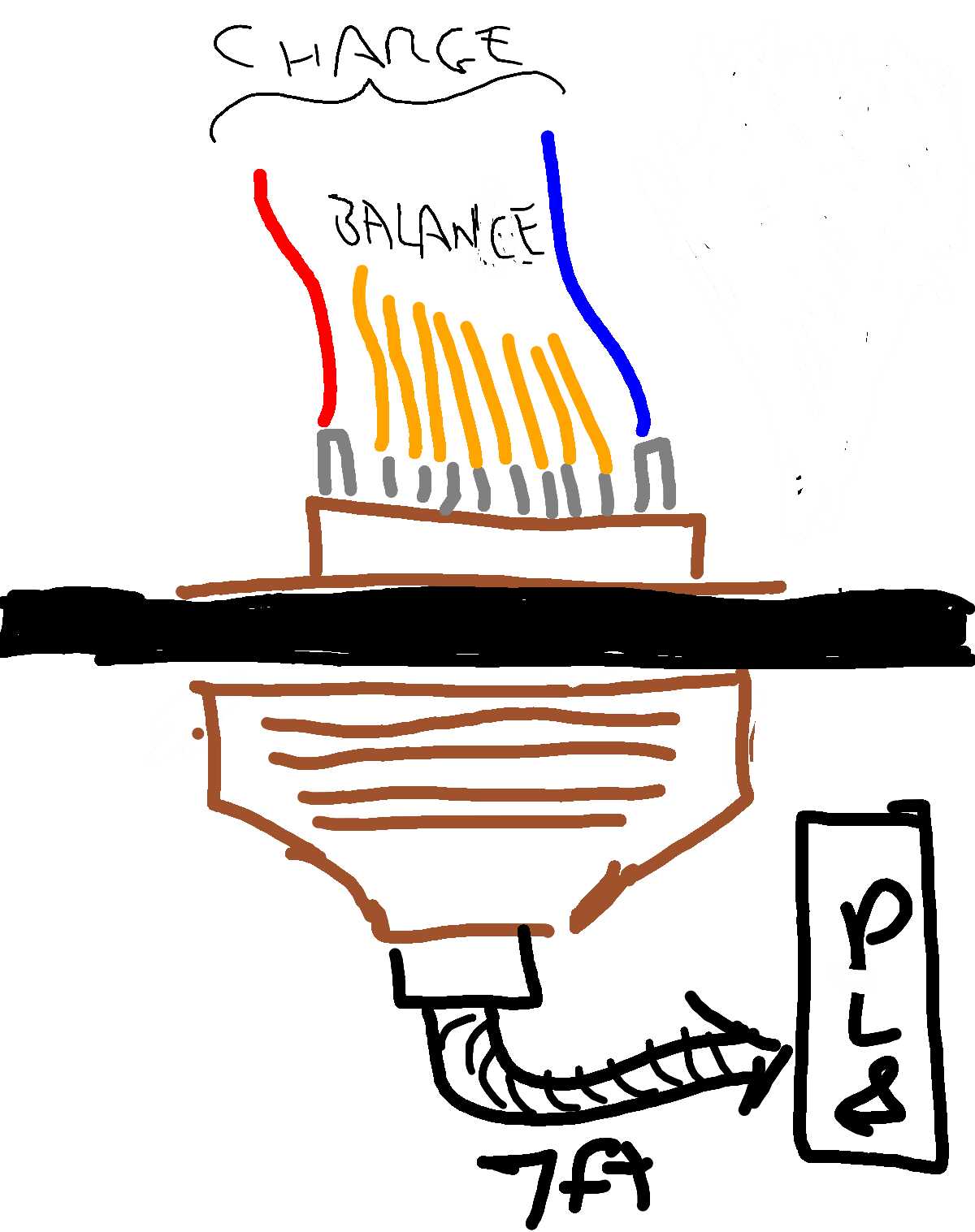

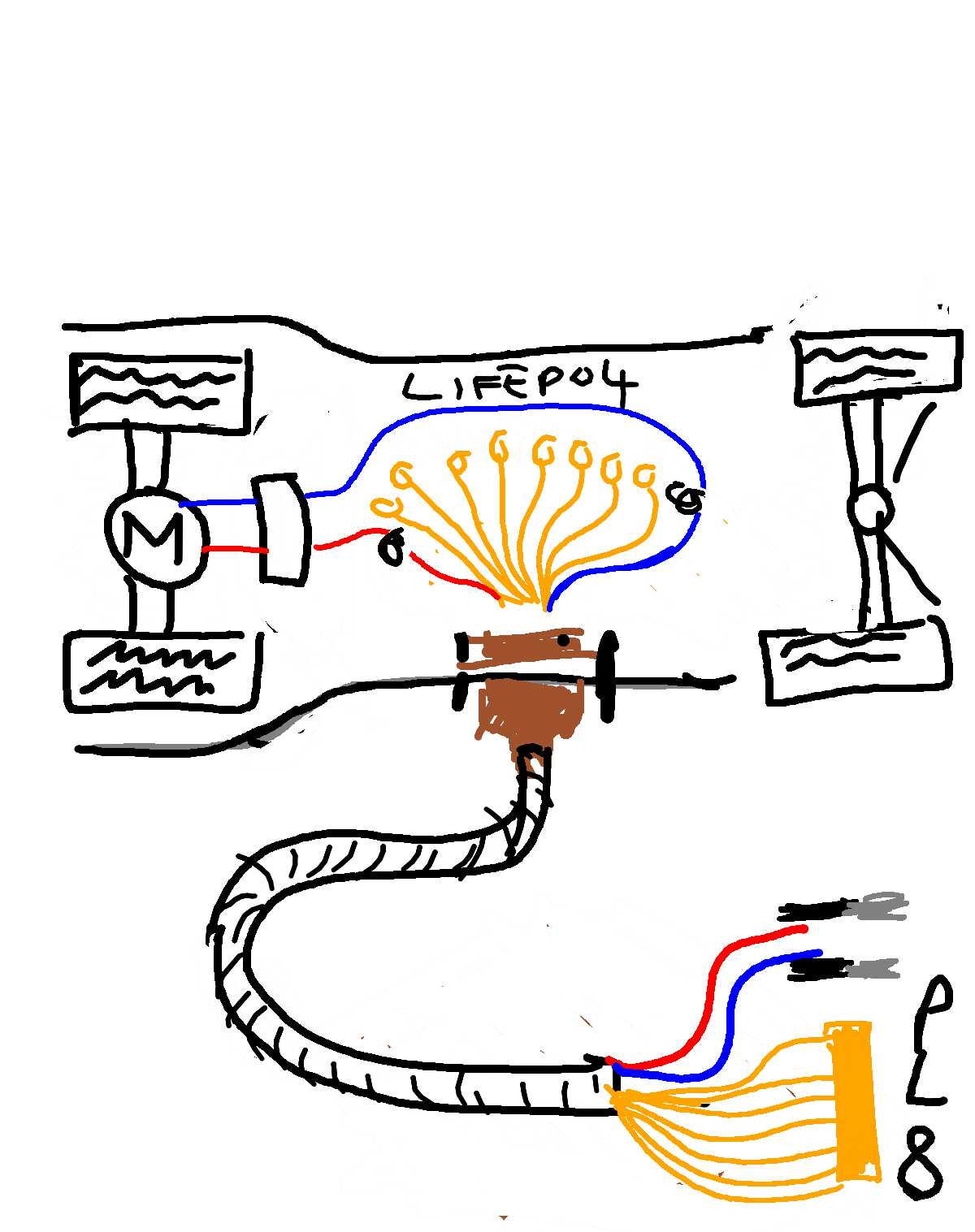

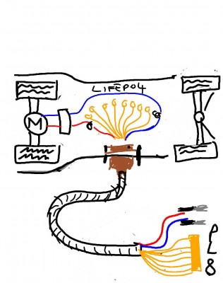

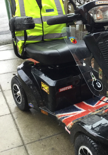

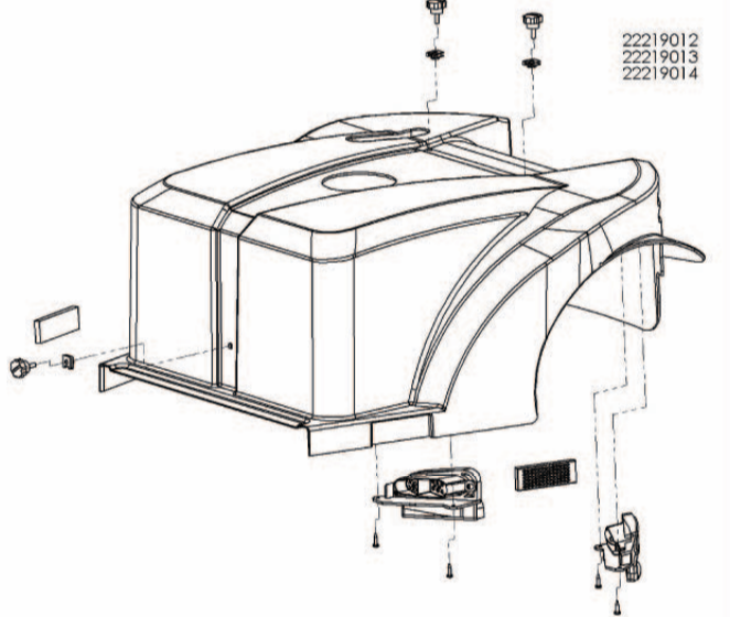

For the lithium conversion of my mobility scooter I need to sort out how to connect the charge/balance cable.
The batteries are under the plastic cover with the NGK Motul stickers. But it is a large one piece cover/shroud unit see diagram.
I initially thought of cutting a slot in the bodywork and fitting a sub-d type connector. Which would be neat and tidy. But the problem would then be that I wouldn't be able to lift off the battery cover because of the battery charge/balance leads.
I could bring a short charge/balance cable up through the seat post hole and perhaps velcro it to the bodywork under the seat. At least that way I can still lift off the bodywork by threading the short balance/charge cable through the seat post hole in the bodywork
I could use either sub-d or the +D9 and anderson as shirley suggested.
What you think would be best?
Postby Scooterman » 03 Jan 2019, 11:57
This is my original idea of the panel mounted sub-d but perhaps not so clever because of what I mentioned above
Postby Burgerman » 03 Jan 2019, 12:00
My battery has some extra connectors at the battery. So you can remove it while leaving the subD bolted to the chair.
download/file.php?id=4301&mode=view
The black/white connectors... For balance. And an Anderson will be for power. BETWEEN the batt and the SubD.

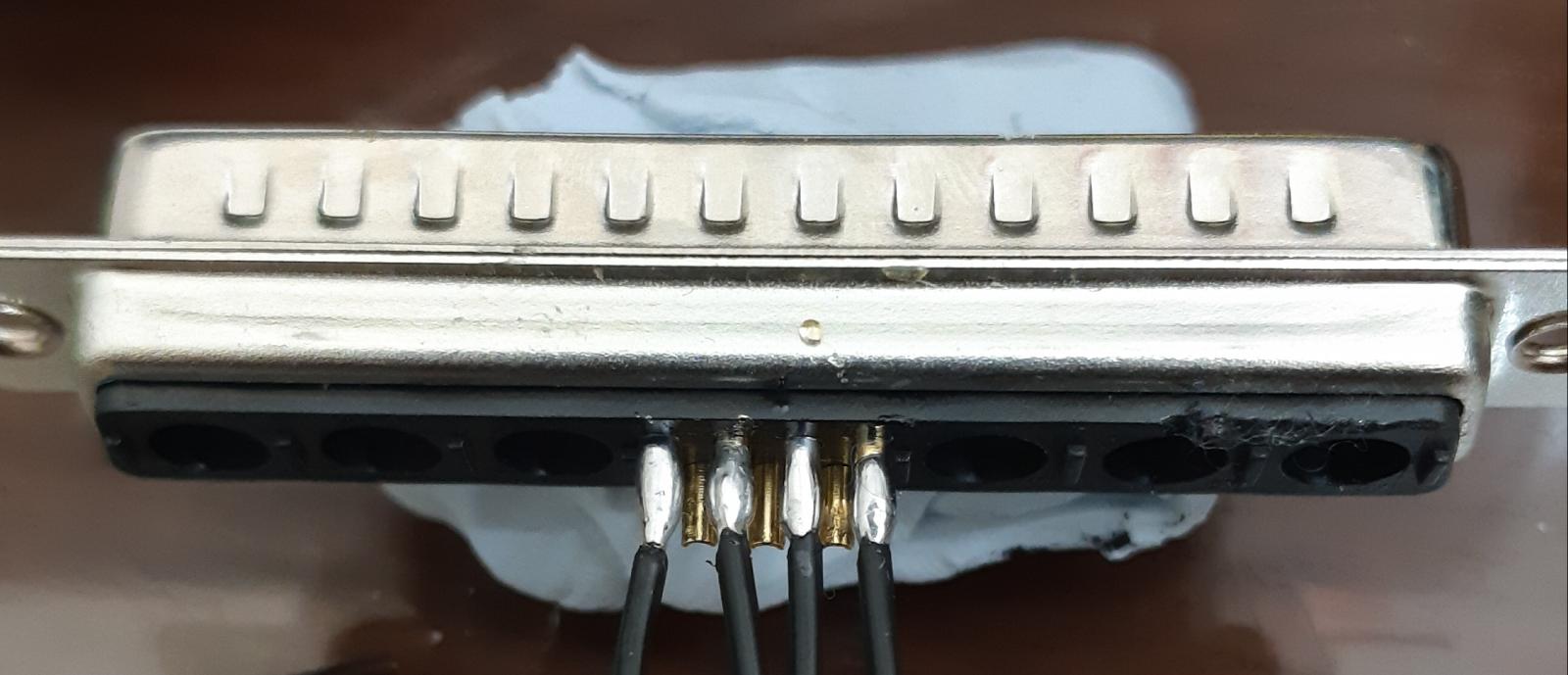

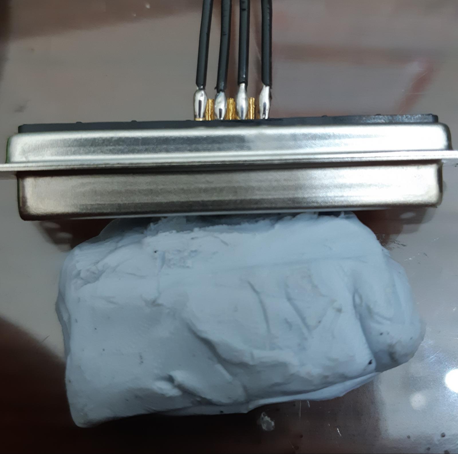

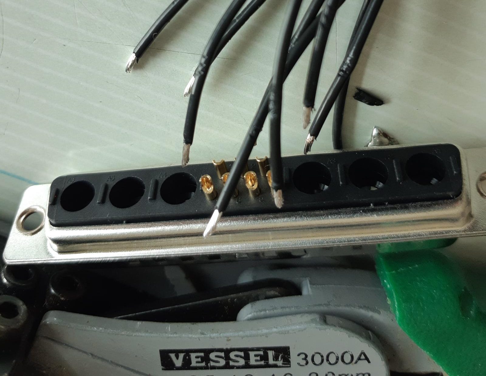

Postby shirley_hkg » 03 Jan 2019, 14:17
That may be complicated for me. drunk2
I was about to make you the female D-sub of the battery end. It has 2 holes , that you can bolt it to a bracket .
Simply secure a mounting plate to the plastic shroud to accept the D-sub .
Unbolt two screws and you'll leave the complete harness behind .
:thumbup:
Postby Scooterman » 03 Jan 2019, 14:18
shirley_hkg wrote:That may be complicated for me. drunk2
:thumbup:
That will be fine Shirley thank you :thumbup:

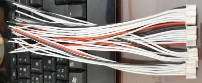

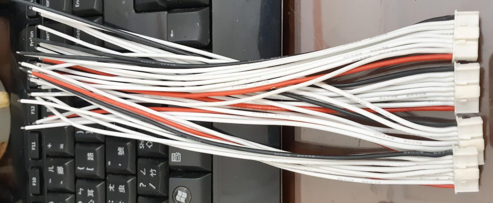

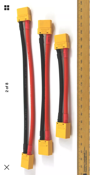

Postby shirley_hkg » 12 Jan 2019, 01:26
Grab some spare @£1.00 each .
Postby Burgerman » 12 Jan 2019, 01:27
Those are too short unless you lengthen them. I buy the 36 inch long ones.

Postby shirley_hkg » 12 Jan 2019, 01:39
Lengthen to 7 foot long. Better and thicker wires will be employed.
Battery end has another 30 inches or so .
Silver coated 0.75mm audio grade one to overcome long resistance .
goodpost

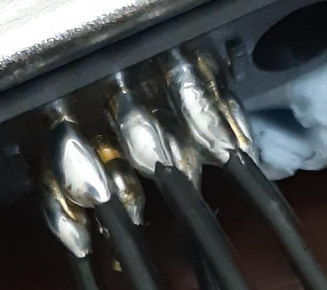

Postby shirley_hkg » 12 Jan 2019, 14:05
First try of Scooterman's new iron .
@310℃ :fencing
Postby Scooterman » 12 Jan 2019, 19:38
Ooh I'm sorry Shirley, I missed your updates on this thread.
It's all looking good :thumbup:
Would I be able to have a few of them £1 PL8 tails in the photo, and some of that silver-coated audio wire you used please?
Basically everything I need to clone the charge/balance cable you've made for me, and to clone of the d-sub battery tails for the second d-sub socket I plan to mount on the other side of the scooter (as mentioned in the PM). Plus the spare d-sub/s etc.
Thanks :thumbup:

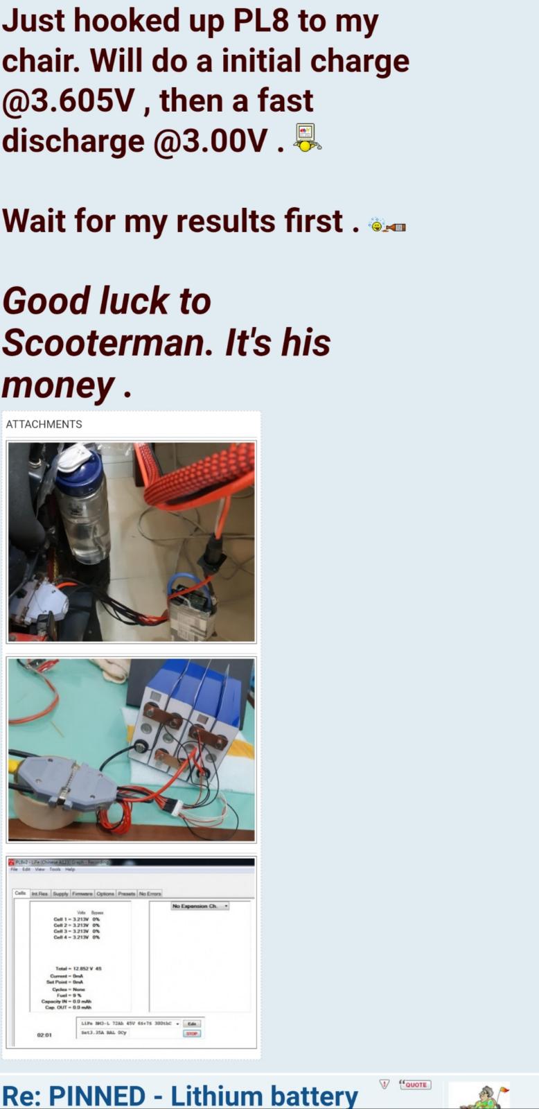

Postby Burgerman » 12 Jan 2019, 19:56
20A discharge. What on earth did you use to discharge 85Ah into? Never mind, just realised it was 12V 4S...
Posts: 71086
Postby shirley_hkg » 13 Jan 2019, 02:57
Burgerman wrote:20A discharge. What on earth did you use to discharge 85Ah into? ..
That's impossible to use PL8 alone . . . ≤ 100w , so it was my chair . .
Postby shirley_hkg » 13 Jan 2019, 06:55
Getting used to the new soldering iron, makes it much easier .
Damn ! I didn't use Blu-Teck long before . banghead
It's so handy .

Postby shirley_hkg » 13 Jan 2019, 11:54
Yes. Need magnifying glass soon .
goodpost
One question , discharged 85Ah , put back 87Ah. Pretty close .
May not need to take the 87% conversion efficiency into account then .
