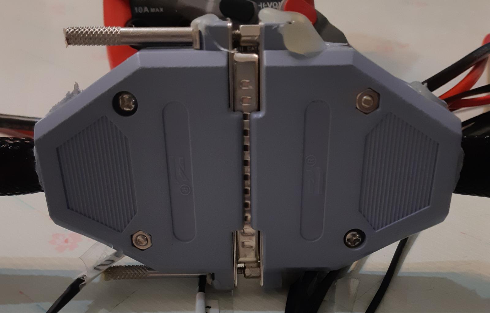

Postby Burgerman » 19 Jan 2019, 18:38
I spit on your blutac.
Mines bigger!
And more abused and dirty. Dirty blutec works better... My soldering iron is clean and tinned. Just did it.
Posts: 71086
Postby shirley_hkg » 20 Jan 2019, 14:16
Burgerman wrote: Dirty blutec works better...
Yes . Too sticky when new .
