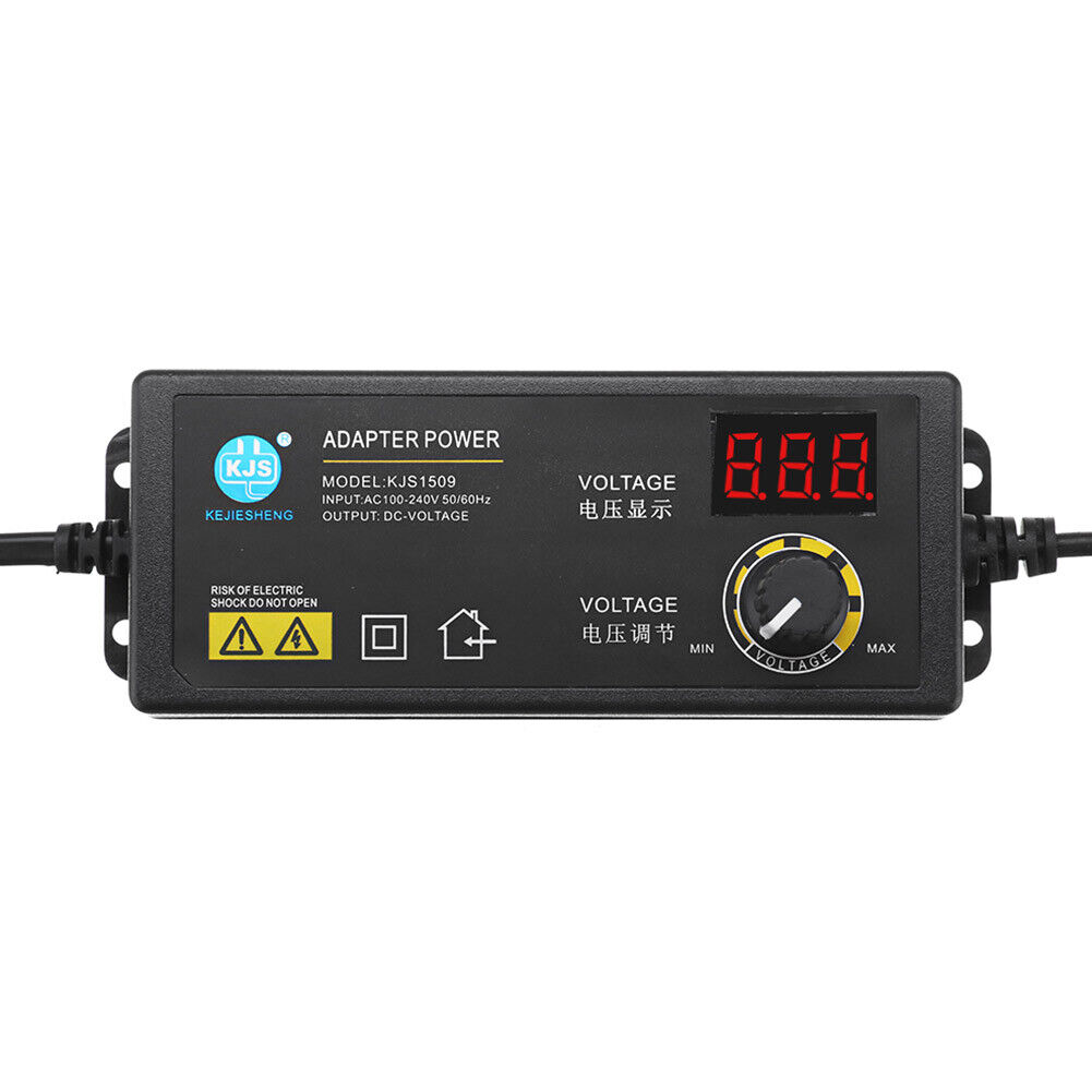

I bought this https://www.ebay.co.uk/itm/405108313343
If a chair is fully charged then after a few hours it will read around 13.2V give or take a little. After a week it may be at 13V approx. If it reads 12. anything at all it needs charging. Why does it drop? Batteries have an internal loss, called self discharge. And the chairs system has anything from 3 mA to maybe 15mA residual drain on top of this, 24/7 even when turned off. So if not using a chair DISCONNECT the battery. Or top off frequently like every 2 weeks max.
Any battery that is sat below its max fully charged voltage IS slowly sulfating and losing capacity long term. This is ONE of the things that kills batteries.
(Other things are higher average depth of discharge (so fit a big battery! Or charge intermittently as well as overnight for a few hours during the day)
If you want a easier long term storage solution hat YOU can choose the long term float voltage easily, do what I did and get one of these!
For under £10 you can just buy a cheap chinesium "power supply" that is 3V to about 36V. These are regulated and have just 1 adjustment knob! You must set this to the voltage you want. Then just plug it into the chair. Now the battery will be held FULL with almost no current and under 1 watt of AC power indefinitely. These are weedy. At 2A max. So are crap as a charger. But in the case of storage thats all we want!
So order one. https://www.ebay.co.uk/itm/405108313343
Whats bad about them? They fit crappy thin short AC cords!
They fit a long enough and equally thin DC cords. Its big enough for a weedy 2A supply electrically but a bit fragile physically!
Anyway, these are so cheap it doesent matter.

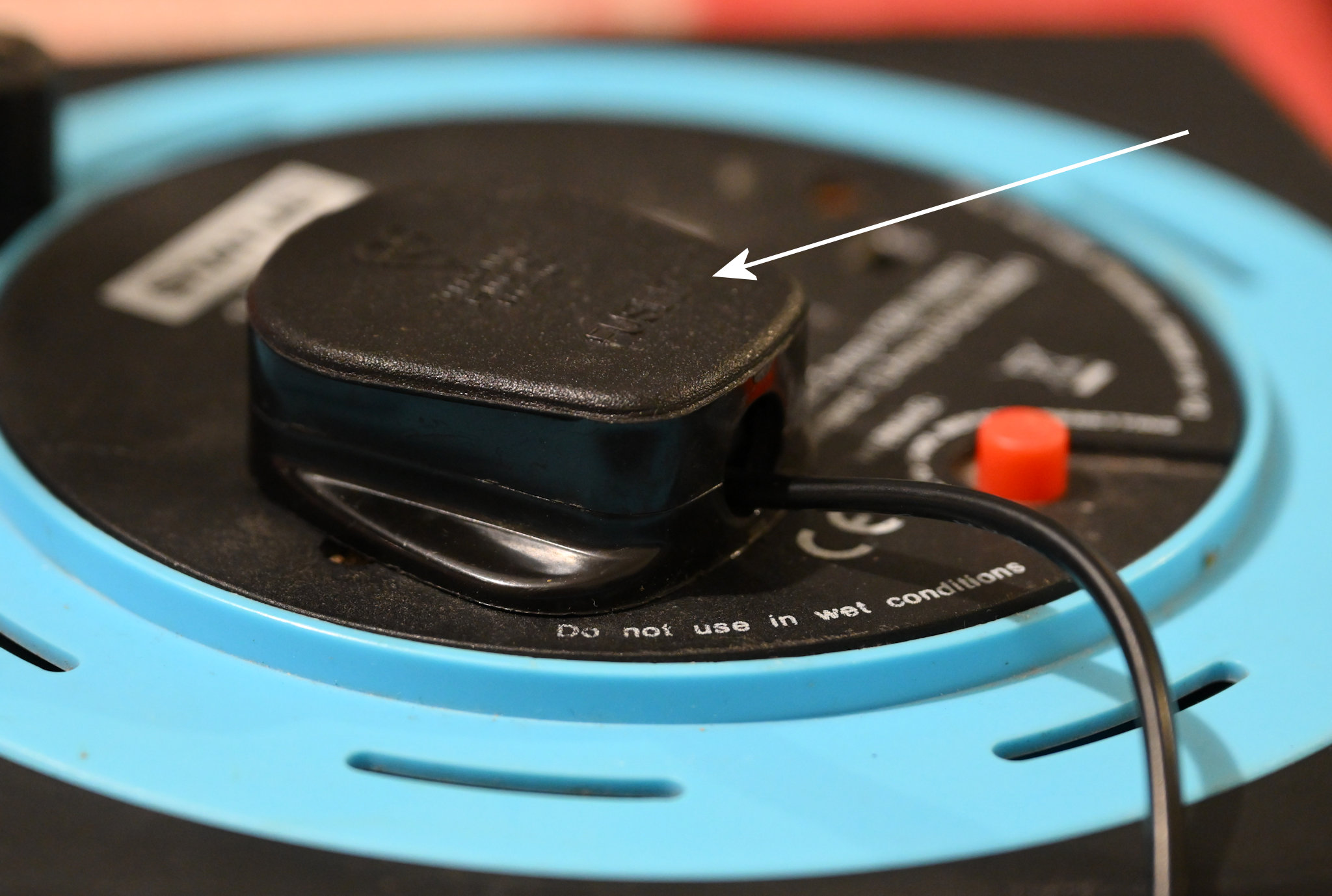

So FIT a AC plug to match your country (mine came with a terrible and illegal adapter! So I fitted a UK plug and a tiny 1A fuse.
I also fitted an XLR connector so I can charge a chair.
I CHECKED the voltage matched the displayed voltage and mine is pretty close. That doesent mean yours will be! So best to check before use.

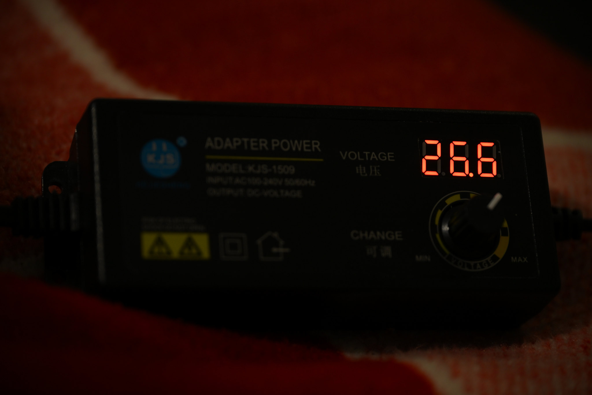

First. Plug into chair, dont turn it on. READ the chairs battery voltage. Disconnect from chair.
Second. Turn on, adjust the voltage to what you want - probably 26.6 for long term indoor storage.
Third plug XLR into chair.
Leave for days, weeks, years as needed.
Once battery reaches the voltage set then current falls to almost xero, and drain on AC is around 1 Watt, (under 1 watt!) measured.
To TOP OFF a chair that is basically full, say a week on non use, set to 13.8 or 27.2V for 12 hours. Disconnect for a few hours.
Then set to 13.3V (ONE BATTERY!) or 26.6V for a powerchair with 2 batts in series, for LONG TERM storage...
DONT TRY TO CHARGE ANY BATTERY THAT ISNT ALMOST FULL WITH THIS! THATS NOT WHAT ITS FOR!

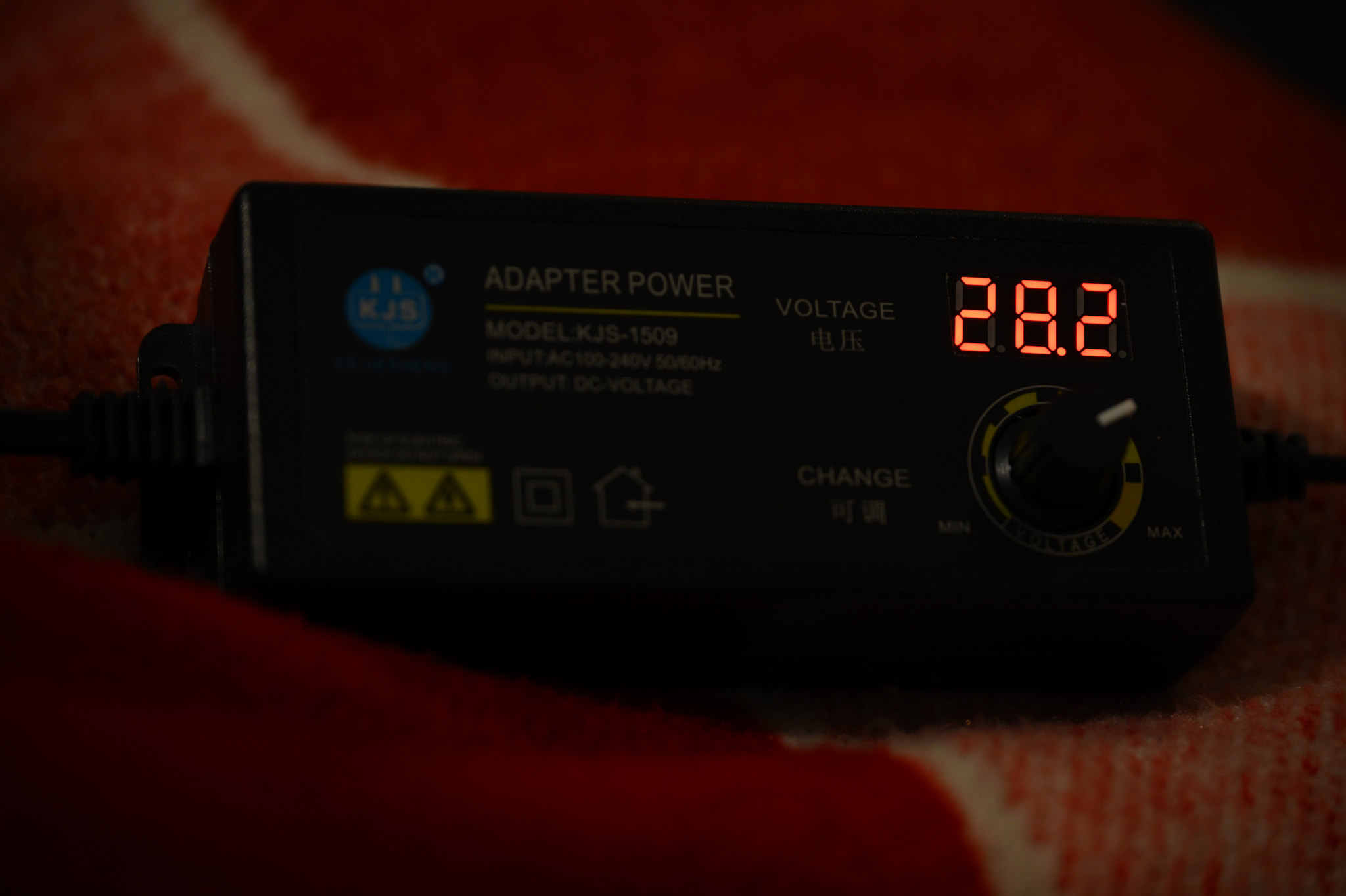

TOP UP CHARGE OF ALMOST FULL CHAIR 8 TO 24 HOURS MAX!

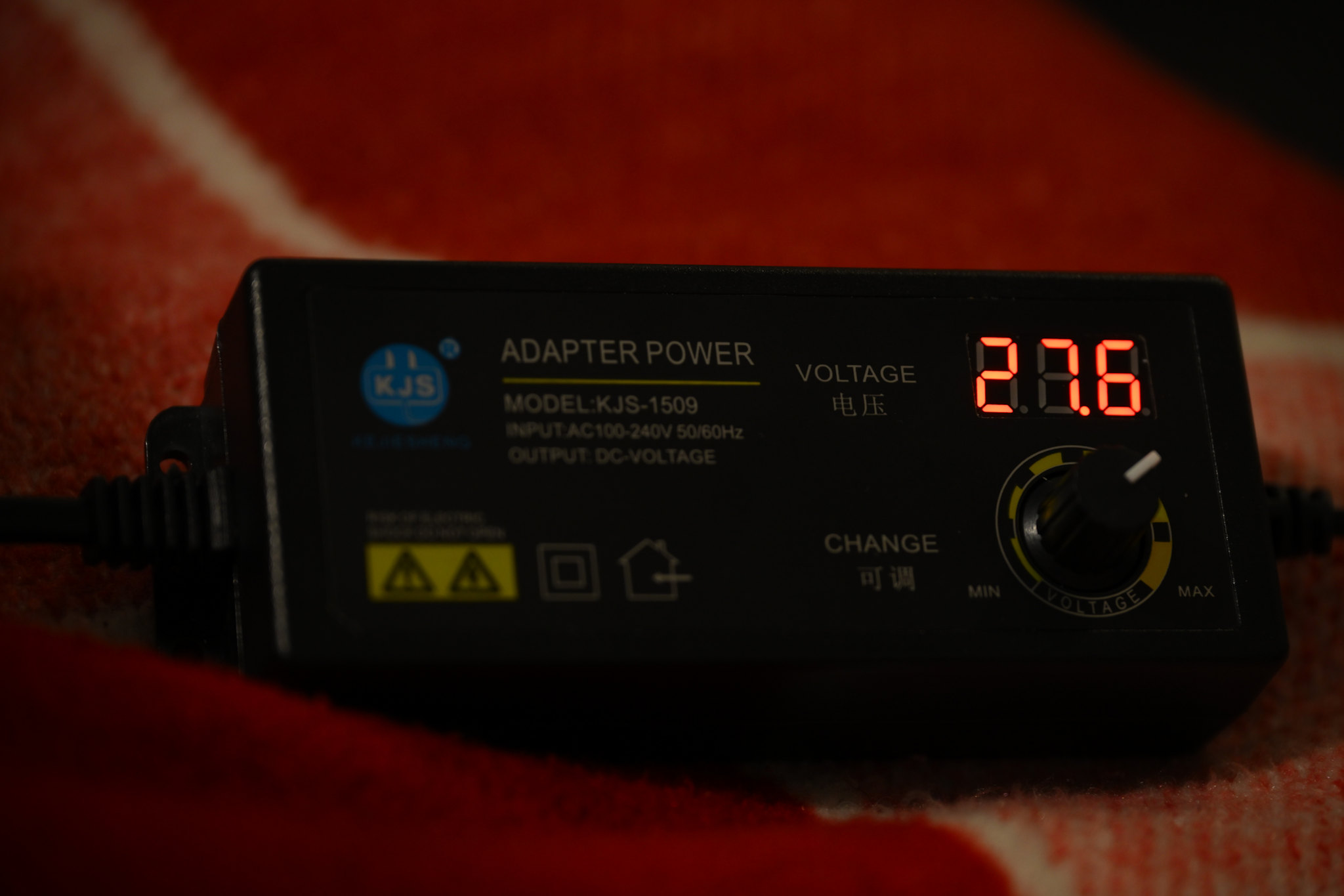

TOP OFF AN OTHERWISE ALMOST FULL CHAIR, UP TO A WEEK. THEN USE IT OR SET FOR LONG TERM FLOAT

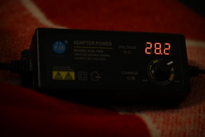

IN A HURRY? If a chair has been stored a week to a month then charge GEL at this level for 6 hours. 4 hours if its almost full. 8 hours max if its below 12.95V when you begin.

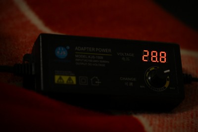

IN A HURRY? If a chair has been stored a week to a month then charge AGM at this level for 6 hours. 4 hours if its almost full. 8 hours max if its below

But the real reason you need one is for LONG TERM STORAGE!
Set to 13.3V or 26.6V and plug it into your chair. Best way to keep battery as close to new as possible for months to years.
Charging a chair (at any higher voltage) means some current long term and that causes grid corrosion, electrolyte losses etc and so gradual deterioration.
Not charging it means the chairs continued small drain even when off, combined with the battery slow internal self discharge garantees capacity loss over monhs to years.
Charging monthly or bi-weekly overnight causes less sulfation, but some battery wear/corrosion etc but is quite effective.
Long term float, means holding a battery at the 100% full point (so no sulfation can happen) but at a really low current so that negligable wear or corrosion happens. On most batteries at temperatures that WE are comfortable at, this happens to be around 13.3 volts. On AGM and gel.
So if its charged already, then set it 26.60V, connect it, and forget it!
LONG TERM STORAGE VOLTAGE. CONNECT AND FORGET. Takes under 1W from the AC.

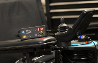

Postby Burgerman » 21 Nov 2024, 19:16
Heres my salsa getting a bi-weekly (to a month max) 13.6V (27.2V) safe storage top up. A full day is OK for that if it hasnt been on or moved at this voltage. Up to a few days/a week max. Not very time sensitive. Will end up at 100% charged. Ignore the pile of junk on the seat.
13.8V (27.6) will also do this faster in a 12h to 24h session. And more time sensitive.
Once I know its full, I can then just leave it set to 13.3 (26.6) indefinitely. Long term. Safely. No danger of overcharge damage or sulfation. AGM or Gel, @ room temperature. Under 1W AC draw.
This thing is really bright clear red. Looks orange and very dull in pictures as its flashing/on/off at high frequency so doesent photograph well. Quite odd. Quite sensitive to set correct voltage. Once set its super stable over time, never changes.

Postby scottnj@gmail.com » 24 Nov 2024, 03:05
That power supply looks like a good idea for a battery maintainer. The only thing that I would be worried about is someone else in my household accidentally knocking the dial up to full voltage and me not realizing it until the batteries are fried.
Do you know of any others that might need a screwdriver to adjust the potentiometer or something else that can't get accidentally changed?

Postby Burgerman » 24 Nov 2024, 03:33
No. But I do have a wall wart that is 1A and JUST HAPPENS to be the right voltage with a diode in series and no adjustment.
So its worth looking at a few. But no clue whare that came from.

Postby LROBBINS » 24 Nov 2024, 08:14
A dab of goop or similar will "lock" a knob, yet can be easily removed with mild heat if you need to.
Re: Battery / chair storage
Postby Burgerman » 24 Nov 2024, 11:13
Or a quick dab with hot glue gun.
