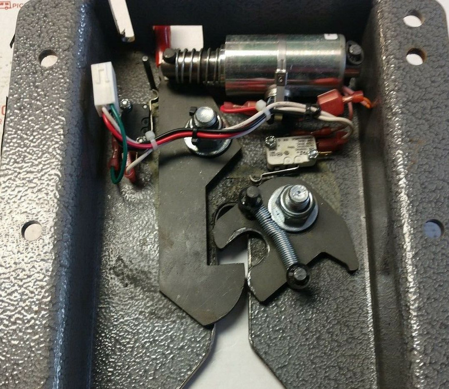

I found this image of the underside of an EZ LOCK BL-6209

You have checked that:
1. its not jamming on the burred edges and that the mechanism moves freely?
2. electrical connections and microswitches?
3. resistance of the solenoid?
4. actually connected 12V to the solenoid directly? Because they seem pretty substantial electrically.
The only thing that can realistically burn that out would be if it remained powered up due to mechanically jamming (the burred edges, bolted to tight, etc, or a failed or incorrectly positioned microswitch. Its more likely a bad switch, bad connection, or mechanical positioning or friction problems. Operate it on the bench with a screwdriver instead of the chairs bolt. And test the solenoid alone.

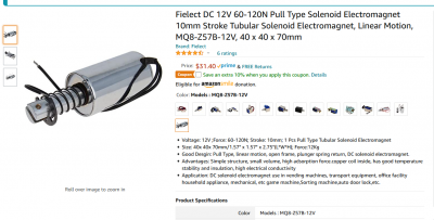

Postby cdb0ewm » 12 Feb 2021, 01:27
Well after many gyrations in that EZ Lock wouldn't sell the solenoid directly to me and the local dealer wanted $200+ to replace it, I finally figured out who made it for EZ Lock. When I contracted them, not only wouldn't they sell me one but said the specs were proprietary by EZ Lock and they couldn't help. After a little research I found the solenoid below on Amazon. I had to mount it slightly differently but it works great and was cheap.
