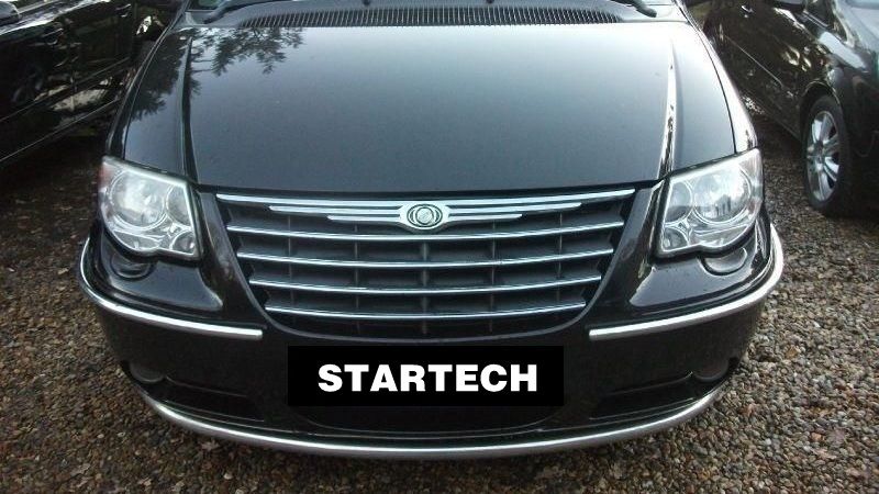

I need the front of my 2007 "57" Braun Entervan lifting, What do I need to purchase in order to get it done?
Its a struggle to find a kit, Im thinking of a spacer on top of the strut's ?
I slow way before the speed bumps & roll over as gently as possible, the plastic lip still catches every time. (nothing wrong with them, just stock voyager)
Soon to fit startech rims with 245/45r19 (lets not get off subject). Even with the wheel/tyre swap its still too low.
Needs a good lift so I can fit my Startech Stainless Bar kit without wrecking it... Lower bar attaches to the plastic lip :(

Postby Burgerman » 05 Sep 2014, 21:53
http://www.wheelchairdriver.com/images- ... medium.jpg
The front is miles off the deck. I cannot understand how you are hitting it. The bumps must be at least 12 inches high?
