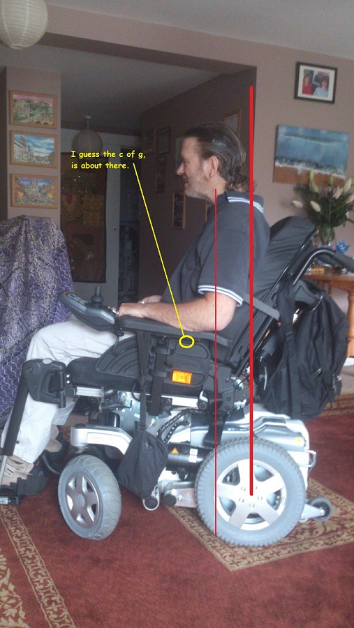

Re: Storm 4 is brilliant!!! (Revisited!) pictures.
Postby sakima » 31 Oct 2014, 17:51
DSC_0002 (6).jpg (148.58 KiB) Viewed 3840 times
DSC_0001 (8).jpg (166.45 KiB) Viewed 3840 times

Your C of G is about 1 inch in front of your belly button. In the centre of that post. That's why it is positioned there. Look at image 1. Legs are heavy. Total CG is slightly in front of the rear wheel.
That photo shows the same chair that I tested a couple of years ago. Complete with the Dynamic controller with all the steering accuracy, confidence and delay issues. It forces you to slow.
But you are correct that the lighter you are the greater this nose heavy thing gets disguised. An empty chair driven by RC always steers much better as an extreme case. Or try a sandbag on the footplate. That ruins steering and control beautifully.
