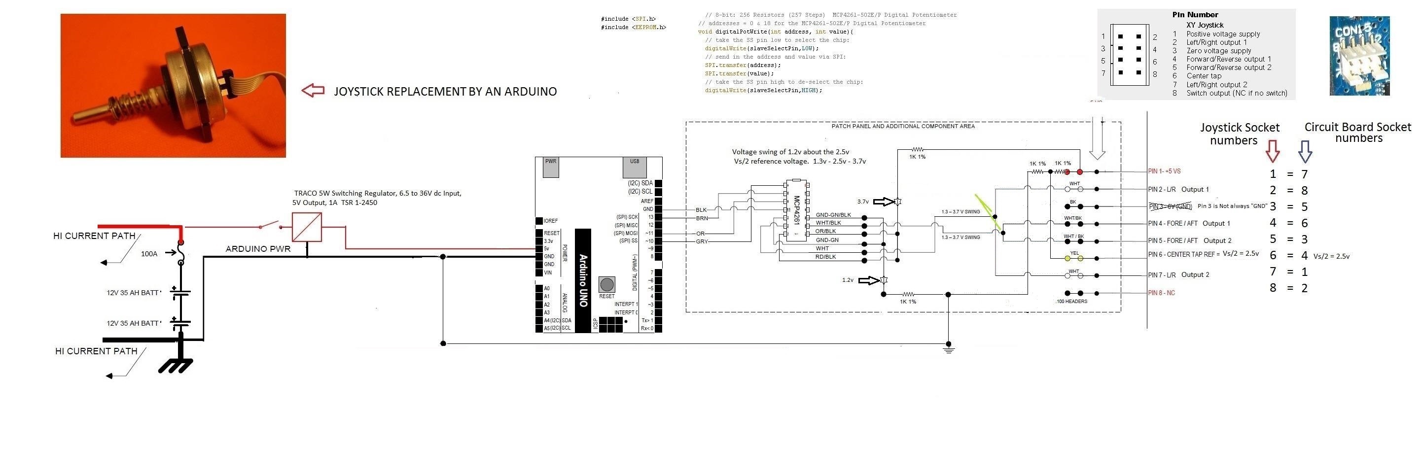

I've tried to find a schematic of the voltage divider joystick emulator, but so far haven't found one. The oldest I've found in my files is one from 1999 but it is a 4066-based adapter for a Dynamic 4SW digital, rather than analog, interface (and it is more complex as it has switch control of Rachi's voice-output computer as well as for driving). In the meantime, I'm attaching the spec sheet for a fairly common type of joystick as it might be useful. These use Hall effect sensors, while yours may well use inductive sensors, but the wiring layout and various sensitivity and voltage options are similar for both.
Ooops, that file is too large to upload here, so here's a Google Drive link that you can use to download it:
https://drive.google.com/file/d/1VwBL2nrOFba-bxkxgoOjpIQelE2W92Ra/view?usp=sharing

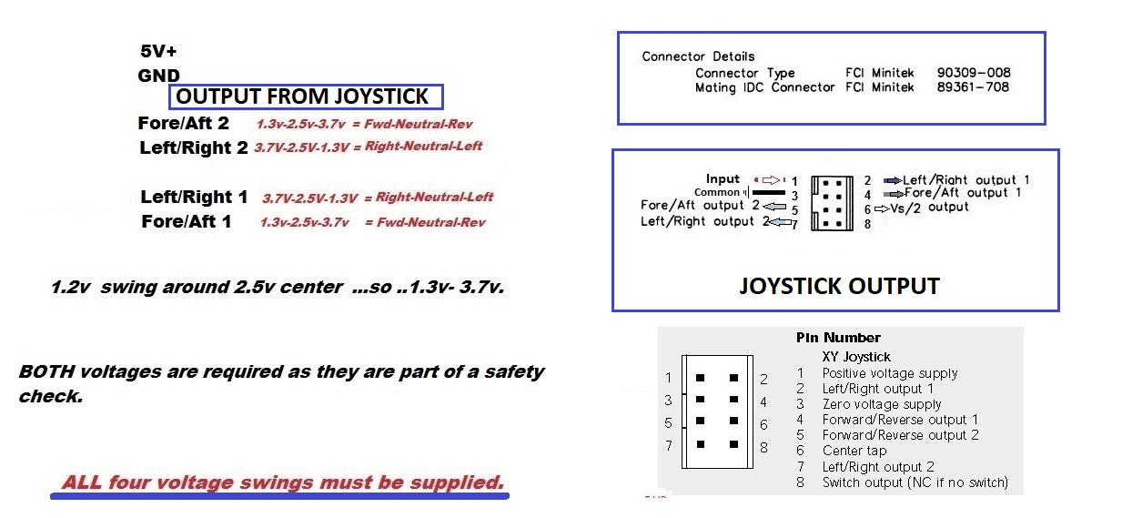

The Vsi will contain a JC2000 or MAID joystick.
https://www.farnell.com/datasheets/30691.pdf
The easiest way in my opinion to control the motors is to emulate the joysticks output.
NOTE:- That each Axis ... X & Y ...has dual ( two ) voltage swings that must match each other within a set % .
The voltage swing is 1.2v - 1.3v each side of a 2.5v center.
Here is a vid of project that I did.... the PP3 battery holder contains everything required ...this being a 5V regulator , Arduino Pro Mini , HC06 Bluetooth module and a MCP4261.
youtu.be/KQy1xbo9tNE

LROBBINS wrote:I've tried to find a schematic of the voltage divider joystick emulator, but so far haven't found one. The oldest I've found in my files is one from 1999 but it is a 4066-based adapter for a Dynamic 4SW digital, rather than analog, interface (and it is more complex as it has switch control of Rachi's voice-output computer as well as for driving). In the meantime, I'm attaching the spec sheet for a fairly common type of joystick as it might be useful. These use Hall effect sensors, while yours may well use inductive sensors, but the wiring layout and various sensitivity and voltage options are similar for both.
thank you so much LROBBINS! I am glad to be able to learn so much knowledge from you

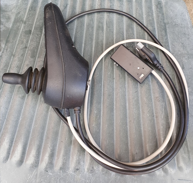

Update: Just received the wheelchair with the controller. Will be opening it up next week

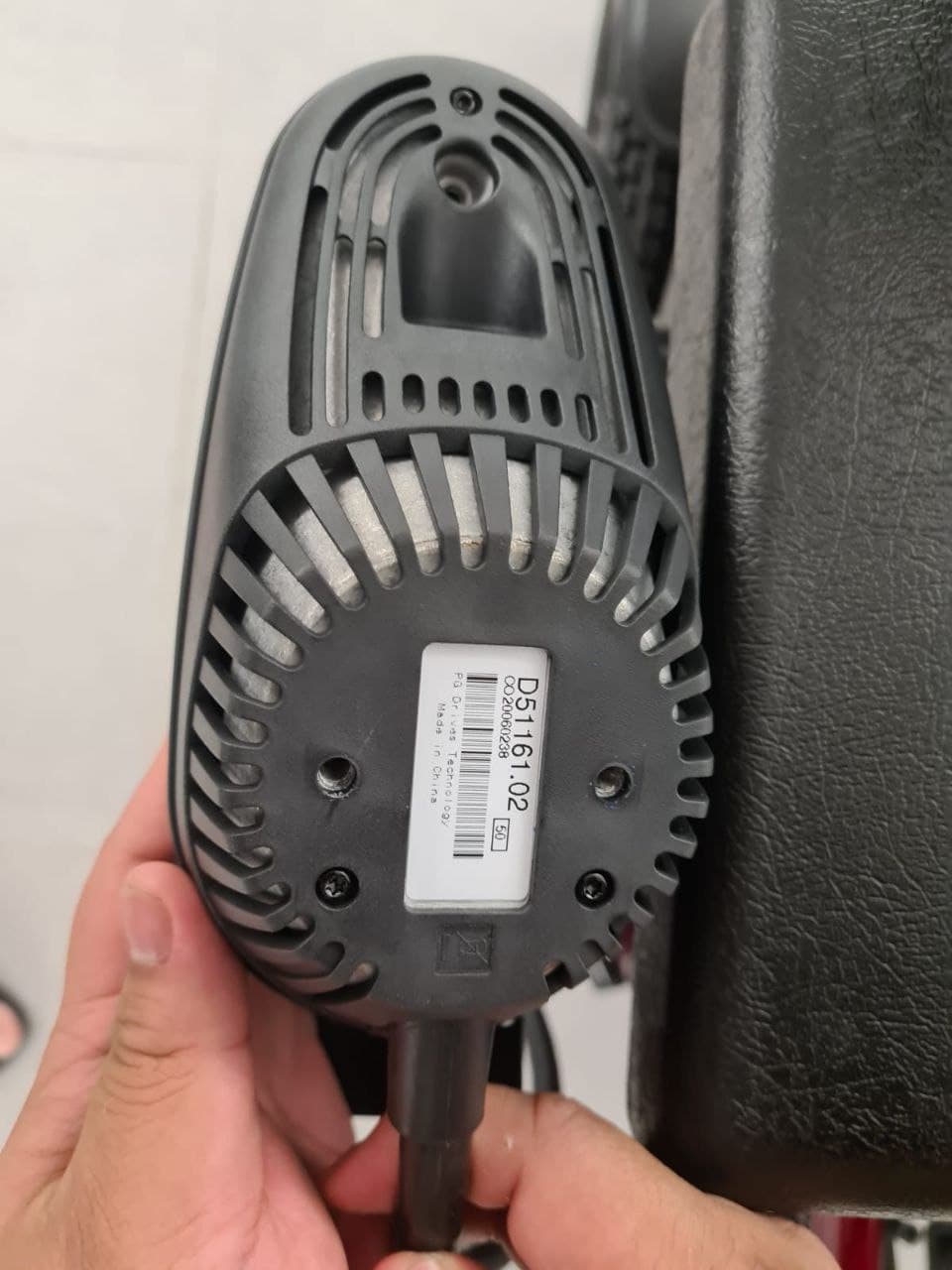

May I ask did you use the TORX10x70 driver to dismantle the controller? It is a hard driver to find in Singapore, might need to purchase online.

nani13 wrote:May I ask did you use the TORX10x70 driver to dismantle the controller? It is a hard driver to find in Singapore, might need to purchase online.
No idea on the exact type/model of Torx ...I just rummaged through my tools and found one that suited.

We have managed to open up the controller, but we are not able to measure the signal given from controller, do we desolder the PCB, or transfer the signal to a breadboard as middle ground to measure it. We measured pin 7 as common ground but we are not able to measure the other pins. The red, black, green, yellow blue wires might be on the other side of the board. Any advice will be appreciated thanks

Postby Burgerman » 31 May 2021, 08:41
The info you need was already posted here https://www.farnell.com/datasheets/30691.pdf
You do whatever it takes to find out what you need to know to emulate the joystick. Whats stopping you measuring it?
Power the joystick and measure its outputs.
Take it apart properly, just to have a proper look. Then if theres no way to access the points you need to measure extend the joystick wires. Better bet bring it here and I will do it all for you! You already know what you need to know as woody posted this already.

Postby woodygb » 31 May 2021, 09:52
Nani ...
Control systems with a separate power module have an easily identifiable signal wire ( or sometimes 2 wires ), the VSi is however an All In One controller and as such doesn't have any signal wire.
IF you have an electronics Guru you MIGHT be able to hack in at the boards component level...but I doubt it.
NO signals come from the board to the JC2000 ..only 5v and GND are supplied by the board.
So I.M.O. you either need to emulate the signals that COME FROM THE JOYSTICK ...or get a different control system with a separate power module so that you can attempt to decode the signal going between the joystick pod and the power module.

Postby woodygb » 31 May 2021, 11:02
Re: P&G VSI 50A
Postby nani13 » 01 Jun 2021, 06:57
woodygb wrote:
Am I correctly interpreting this, by sending 5V to the joystick, pin 1 and 3, we shall in turn receive the respective output voltage at pin 2,4,5,7 depending on joystick direction?

Postby woodygb » 01 Jun 2021, 08:12
nani13 wrote:
Connectors.
https://www.digikey.ca/en/products/deta ... LF/1537945
https://www.digikey.ca/en/products/deta ... lf/4417982

Postby woodygb » 15 Jun 2021, 17:29
Strange question to ask about the ribbon pitch ...measure yours and tell me what your ribbon pitch is.
The 4 voltages ( 2 off X & 2 off Y ) MUST be 2.5v at start up AND Vs/2 must also be 2.5v.
This might help you ...
