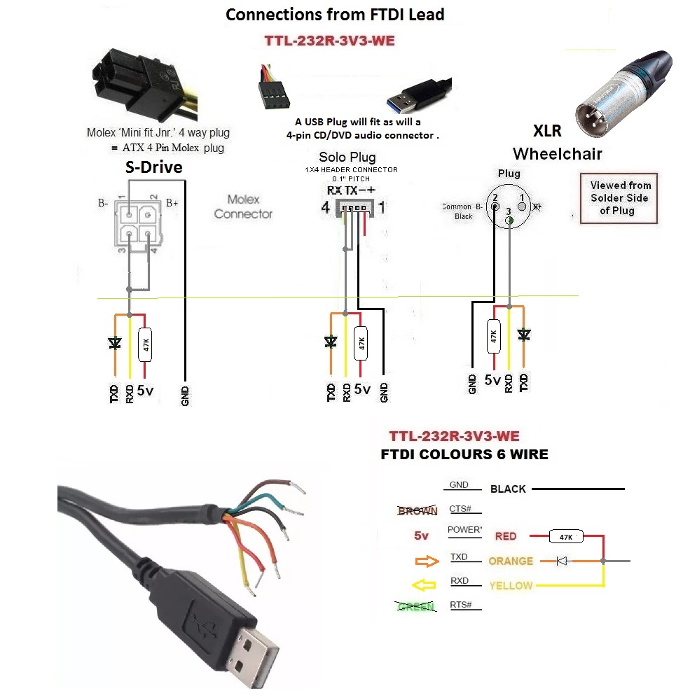

Postby BulldozerDK » 11 Oct 2017, 21:20
woodygb wrote:Yes ... :)
You need the Industrial software for the SOLO.
I have to ask two questions;
First of, I've tried reading through hundreds of contributions on this site, some of it gives me some insight, but I cannot seem to find a conclusive answer to the two questions I am sitting with;
First of all, In order to make a communication cable for the Solo driver would I need to just take a regular USB-> Serial adapter, connect the 4 pins to each of the 4 pins on the controller or do I need to find the diode and and install it connecting the TX and RX cable to one pin on one of the controller?
Woudl I need to modify the USB->Serial connector in anyway? And how? - or would I just need to use a direct USB cable with no serial adapter in between? Connecting the same parts?
SEcond questions, everywhere is mentioned that for programming the Solo controller I would need the industrial software, but I can't find a single place explaining where to get this software? This might be obvious for some people, but apparently I am lost at this point :)
I am sure that both questions have been answered before in the forum, but I simply can't seem to find the conclusive answers to any of the two questions.
I sincerely hope that someone will be able to assist me creating the adapter and getting hold of the software. - Thanks in advance!

Postby woodygb » 12 Oct 2017, 15:27
http://homepages.spa.umn.edu/~frahm/CustomCable2.pdf
You simply alter the connector in the above guide....note the guide wasn't made by me.
Careful with the colours in my pic as they do not match that of the recommended FTDI lead ...rather than a cheap Chinese Ebay purchase... which are Yellow RX, Orange TX ,Red + and Black-.
Software can sometimes pop up in private messages.

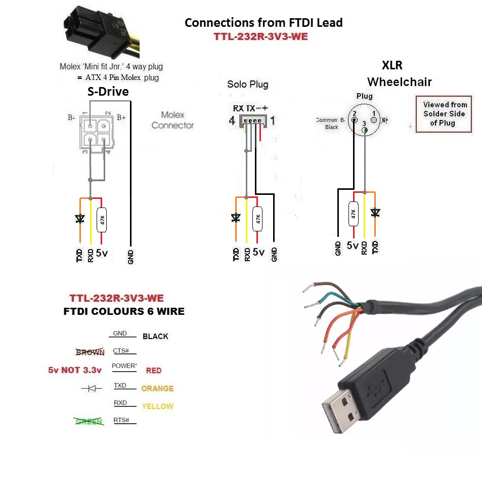

Postby BulldozerDK » 13 Oct 2017, 14:28
woodygb wrote:
I appreciate it, but unfortunately this does not get me any further than what I already read multiple places. - I am sorry, I might be a bit slow, but I would appreciate a bit further assistance;
The guide that you link to seems a bit off, it is with an XLR plug as I only have the 4 pin no-name connector
I have a connector that will fit that plug, but based on the shown image and the linked guide I do not feel certain as to which pins to use from where;
Is it because I need the FTDIdevice(which seems to be parts from Arduino work)?
I've tried to attach a document containing pictures of my equipment, I hope that someone will be so kind to look through the pictures to see if it is even possible with said equipment? https://1drv.ms/b/s!AjoFHPKwGUx6hKR9ZF1dnnem2-RUlg
Also, does anyone have a assembly guide for a cable for the Solo drive only? one-to-one guide maybe even?

Postby woodygb » 13 Oct 2017, 15:36
I recommend an FTDI lead.... specifically the TTL-232R-3VR-WE .... other types of USB-TTL Cables MAY work ...but not always.
Your using a SERIAL Lead ..it WILL NOT WORK.
The guide does show an XLR being fitted.
Simply alter the connections to the different plugs .... THUS.
I use the MALE XLR Version ...then have the other 2 plug types on a FEMALE XLR and simply swap ends/plugs over depending on the controller.
Postby woodygb » 13 Oct 2017, 17:09
Updated pic to try and make it clearer.
Hopefully it's clear that the SAME LEAD CONFIGURATION is used on ALL the plugs... just wired to different numbers/places.
