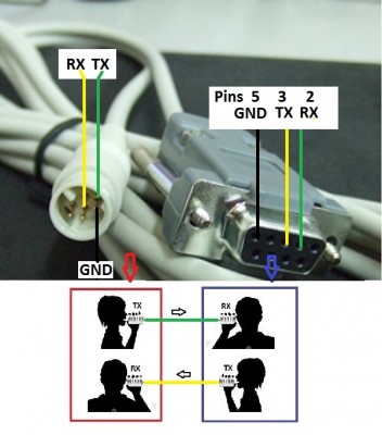

Postby woodygb » 01 Nov 2017, 13:51
I managed to find a scheme that told me to solder a regular USB->RS232 to match a S-VHS(Hirose) 5-pin connector. The drawing did not show which side the plug was to be seen from so I might have soldered it the wrong way. - Is there a drawing/manual for soldering this connector out there somewhere? If not, would it be an idea if I did one when I have figured out how it is done?
Does this help.... I'm fairly sure that I've drawn it correctly.

Postby BulldozerDK » 01 Nov 2017, 23:35
The attachment HIROSE DB9.jpg is no longer available
That helps a lot, I only had this in different versions to go from:
I "saw" the connector from the wrong side when soldering
I will try to assemble this first thing in the morning.

All the other threads refer to green wire which i do not have
Any help on this would be appreciated
Jer
Jer
Posts: 5
Joined: 05 Nov 2017, 14:49
Postby woodygb » 05 Nov 2017, 17:03
HOPEFULLY the White is a combined TX and RX ... so try this configuration.
BLACK to Pin 2 of the XLR and WHITE to Pin 3 of the XLR....ignore the RED.
You could also "pop" the case open and have a look at the connections inside ....they are usually marked.
