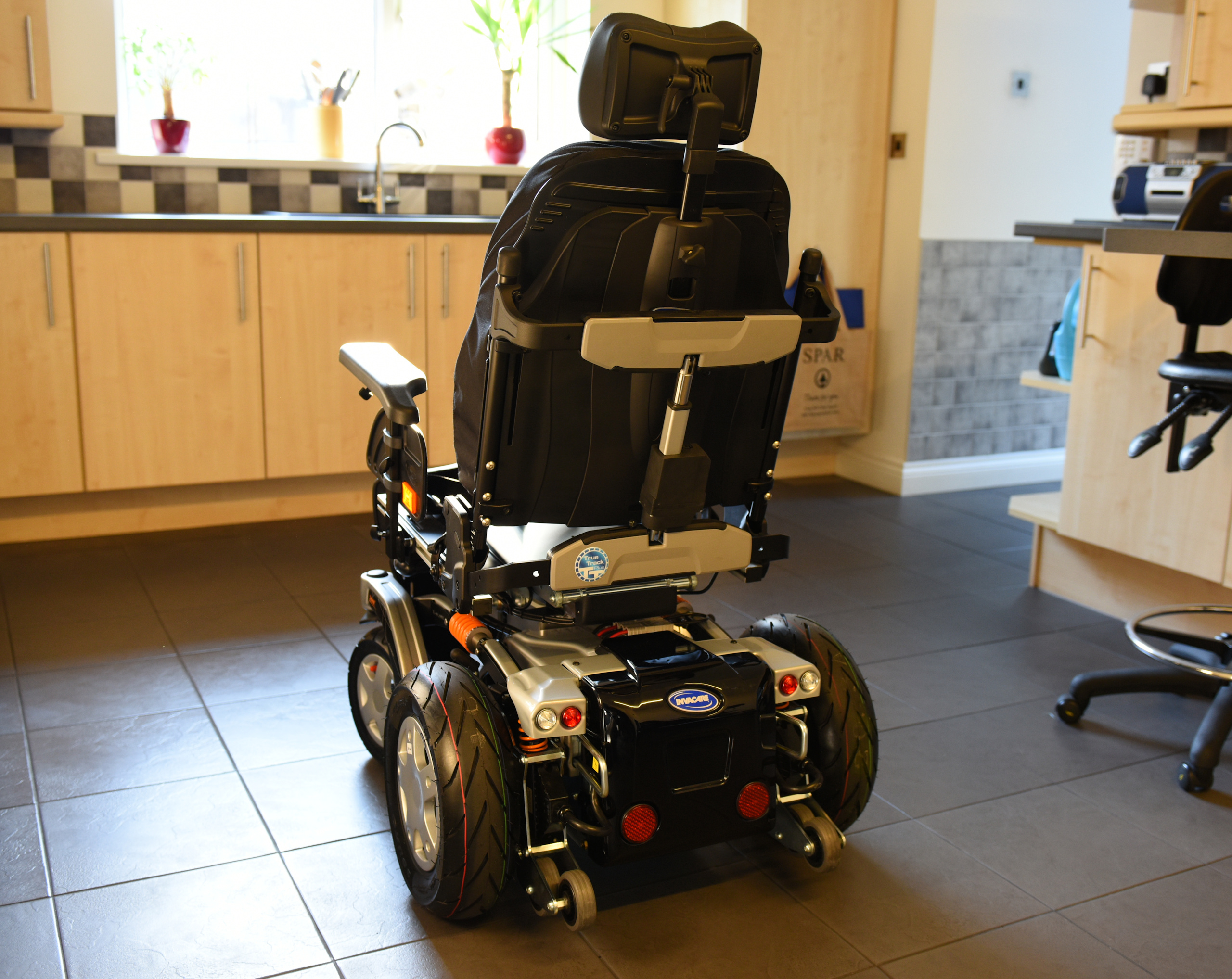

Postby hank » 19 Aug 2017, 18:42
Just a few pics so far with build.
Tyre wrong way round lol. :lol:

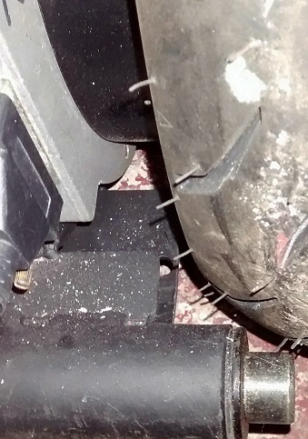

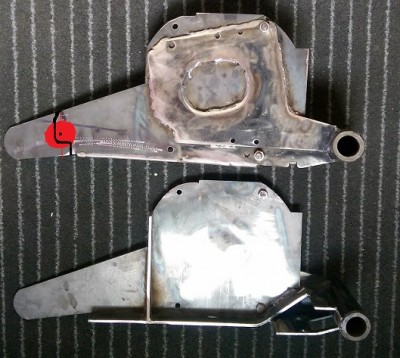

hank wrote:Just a few pics so far with build.
Tyres wrong way round lol. :lol:
Solid mount suspension mounts next.
No room for travel as top of motors would hit lugs of frame.
brushless g 23.8.jpg (54.03 KiB) Viewed 16930 times

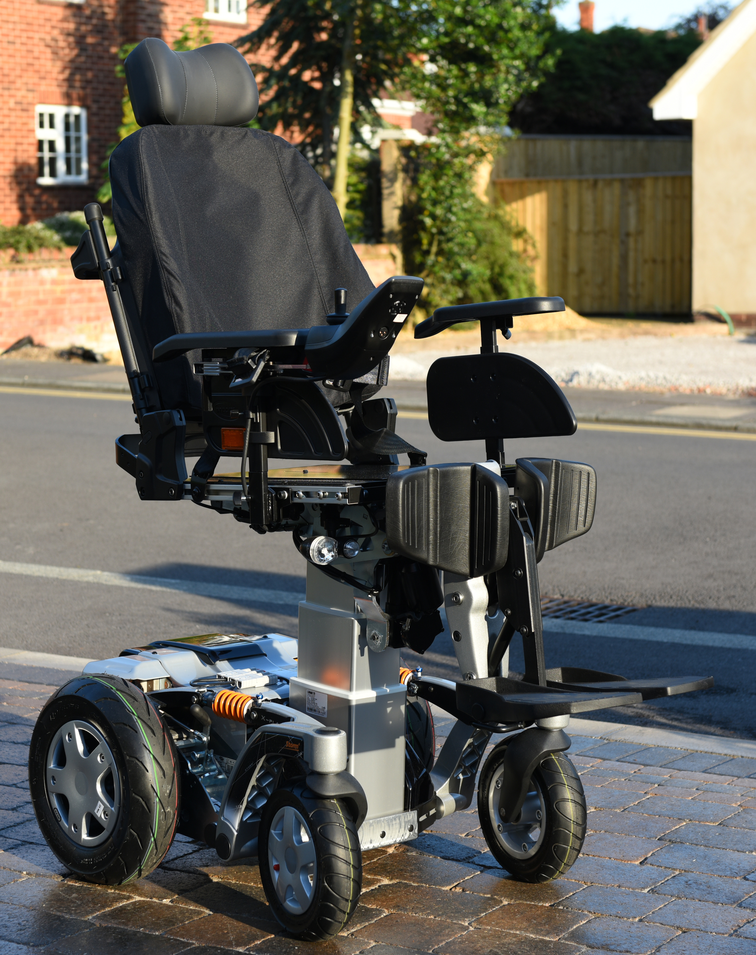

Re: Quickie Groove Brushless TT build.
Postby hank » 06 Dec 2017, 15:51
side .jpg (59.18 KiB) Viewed 15990 times

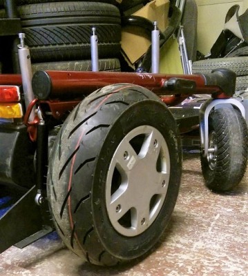

hank wrote:
motor ar .jpg (43.32 KiB) Viewed 15967 times
