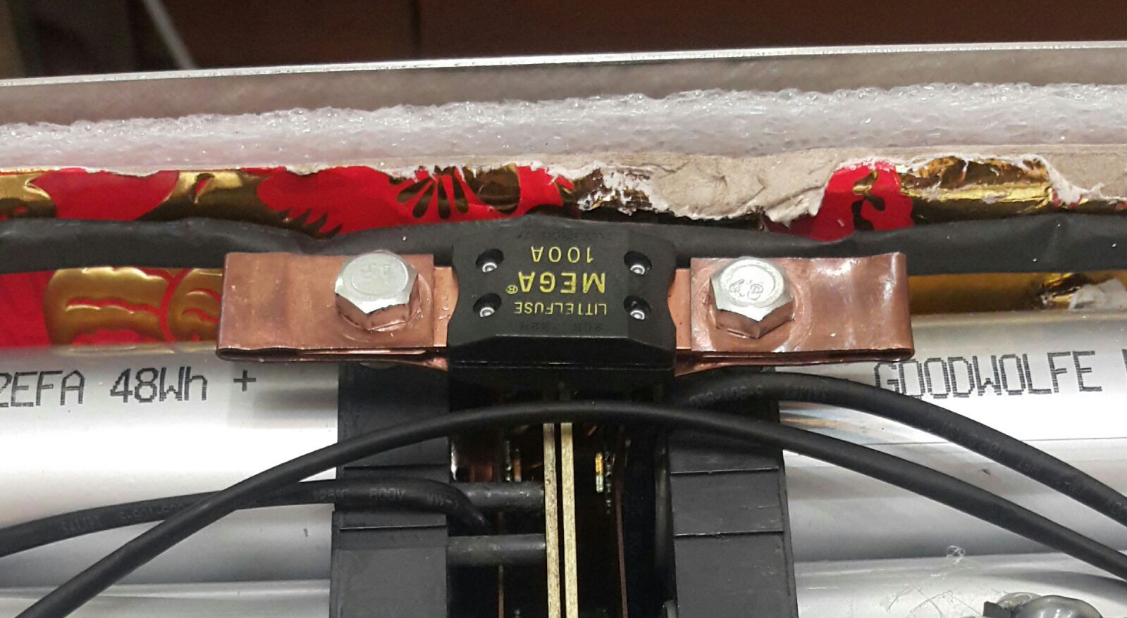

Postby Burgerman » 22 Nov 2017, 10:39
Are you sure you dont have a cables or cell connection issue? Looks very erratic.
Posts: 69775
Postby shirley_hkg » 22 Nov 2017, 12:12
No. It's the IN and OUT of an external 8A dump . :bounce

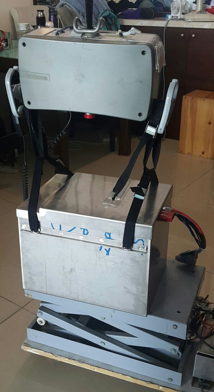

Postby shirley_hkg » 26 Nov 2017, 05:31
Sign , seal & deliver . drunk2
Posts: 4454
Postby LROBBINS » 26 Nov 2017, 07:53
Shirley, I have a non-battery question. Where did you get that jack - it looks quite sturdy.
Posts: 5771
Postby shirley_hkg » 26 Nov 2017, 08:10
It's from Italy , 10 years ago , 60kg load .
Posts: 4454
Postby LROBBINS » 26 Nov 2017, 10:58
Is their a brand name on it? I haven't seen anything quite like that around here - and I live in Italy, but in a "citta' d'arte" rather than an industrial city.

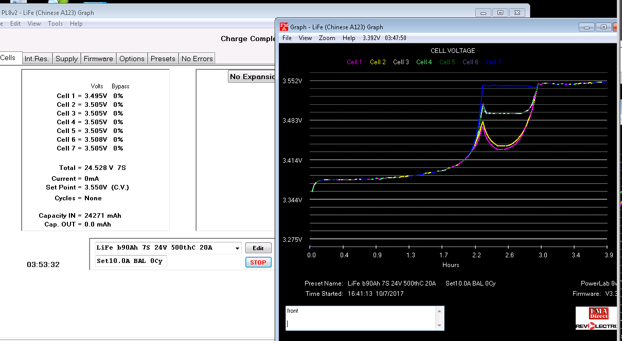

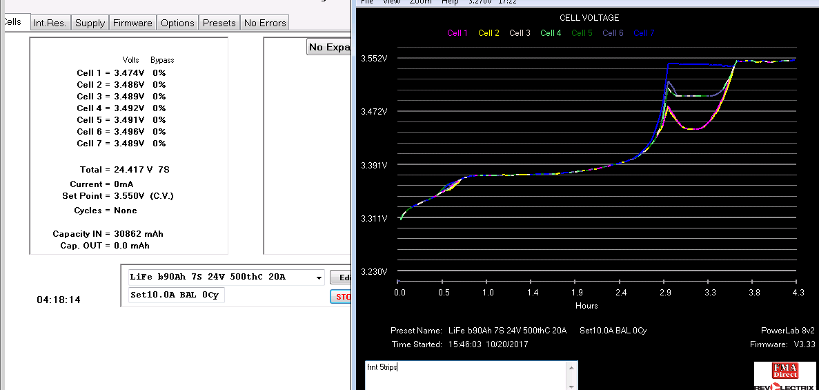

Postby robert97 » 07 Dec 2017, 00:35
in august i built a pair of 7S5P packs using 70 Headway 38140S 12Ah LiFePO4 for 46volts.
i started with best intentions of balancing the groups after 4 weeks of
letting full cells sit. but i made mistakes and ended up with random groupings.
my "front" pack is not well balanced:
cell group 7 hits max voltage before the rest, and cell groups 1 and 2 lag behind.
i am prepared to rebuild the pack. besides loose bolts,
is there anything i should look for?
or just start over: disassemble, charge each cell, sit 4 weeks,
recharge, note leakage and rebuild groups with same average leakage?
robert97
Posts: 71
Joined: 03 Jun 2017, 15:34
Location: Boulder, Colorado
Postby Burgerman » 07 Dec 2017, 02:56
After 4 moths? Not that bad. But you have one group that seems better than the rest. So maybe that one has the loose bolt...
Retighten all. Charge at 3.65v once for at least a couple of hours after all cells reach full voltage.
Remove say 10Ah. Recharge after 10 days. See what happens.
